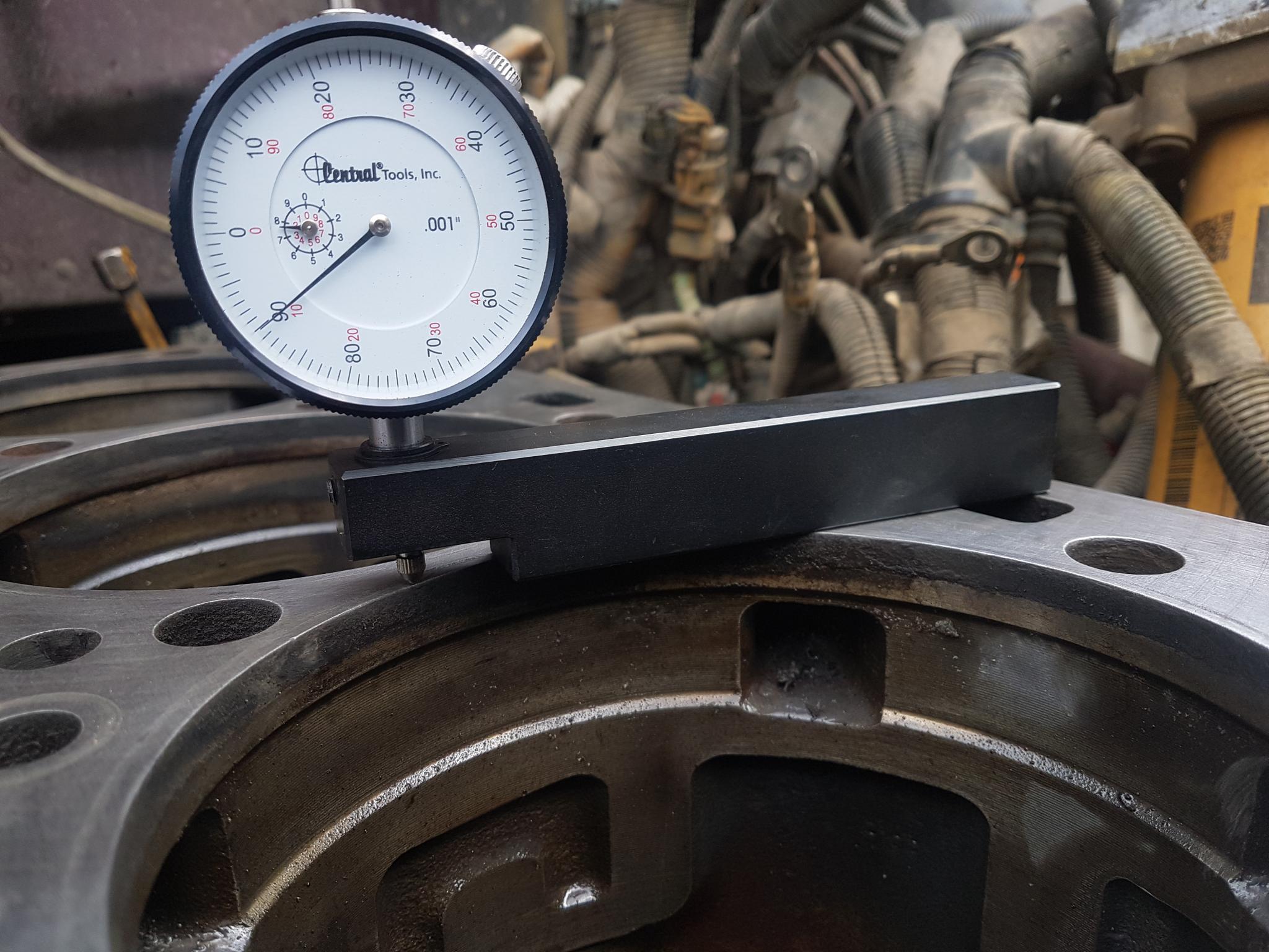

Well this time I decided I needed to do it myself and see for myself where the problem was and fix it and what I found just angers me so much!

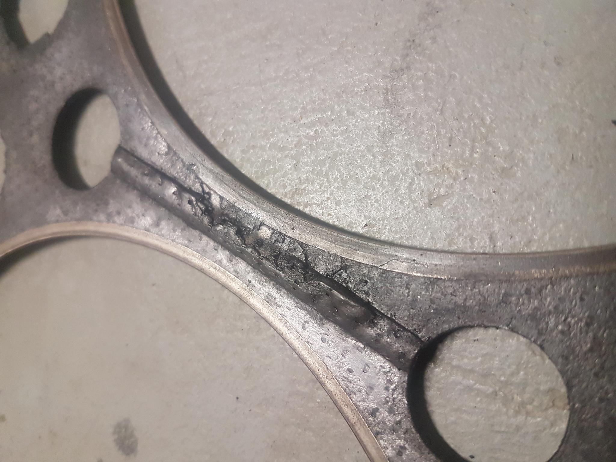

The fire ring on the right side of picture... see how it appears wider/crushed, note the crack....
Number 4 hole in the exact spot the fire ring blew out! 10 thou!!!!! You have got to be kidding me! There is a spot on number 3 that out 5 thou as well.. way out of acceptable spec. In that same spot it grooved into my head enough that my finger nails catch it though I have yet to measure the head.... if my head needs replacing, I'm going to go postal!

Got I little more insight into what happened. I found the top flat seal on the liner was burnt to a crisp where that low spot was and that's where my combustion was getting into the coolant.

I've seen 4 to 5 thou wear step on a cat. Wow, 10 thou, someone really flunked on that one. Happy to see your doing this yourself Brock. The experience will be priceless. I might be in GP early to mid next week and might stop in to see you.
