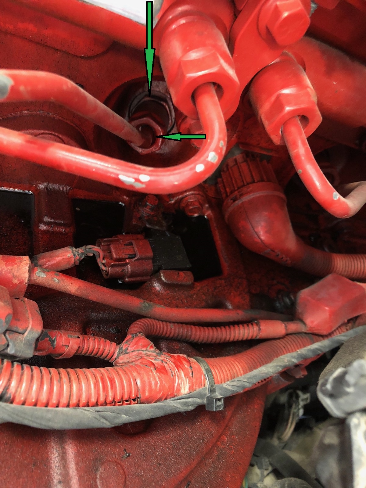

I just got back from the shop. Major oil leak from injector #4 which I was aware of and thought it was the valve cover gasket. Does anyone know what could of caused it? And is it a cheap fix like a seal or something?./uploads/201807/post_2325_1530813793_98b25498dd3fafa536285259f60df15b.jpg

Mechanic said that someone had already ran the overhead on it but it was too too tight. Looks like they used the wrong gauges for clearances. He re-ran the overhead and fixed the mess up. He said that could be why I was getting bad MPGs. Guys, what other tests can I have the mechanic do while he in there with Cummins INSITE? I want to have him do the tests while the truck is in the shop.
07-06-2018, (Subject: PLEASE help me! VNL670 with an ISX CM2350 4.4 MPG! )
RE: PLEASE help me! VNL670 with an ISX CM2350 4.4 MPG!
Fuel system leakdown to make sure none ur injectors are leaky. Maybe a cutout make sure ur firing on all 6.
 Thanks given by: VNL670
That oil coming out an injector would have me real nervous. I might would wanna run a compression test.
