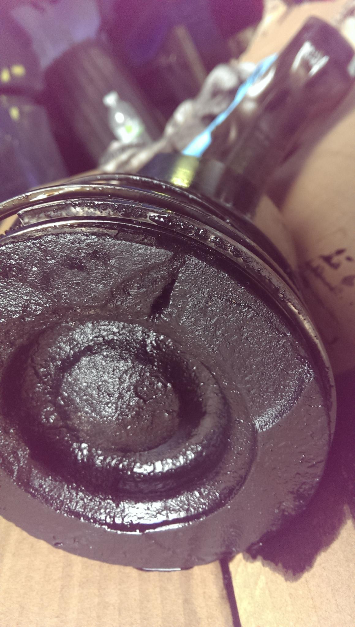

(07-21-2018 )Starlight Wrote:  Do you happen to have a misfire? Reason i ask i just rebuilt a 2350 couple weeks ago and it did exactly the same thing. Oil was heavily blowing out the breather pipe and the valve cover gasket and made a huge mess. Ran perfect before it blew. Ended up being a hole in the piston.
Sorry, no intention to freak you out, its just eerily similar to what i recently saw.
Not to hijack the thread but that is an odd place for a piston to crack. They usually only do so on the exhaust side instead of the front like that one is. Piston does not look severely overheated but still, just make sure the injection timing in the program is not set a bit too high if it is de-mandated.
Also could be a bad injector spray pattern hitting to one side of the cylinder. I would recommend not re-using that injector just as a safety measure + inspecting the spray pattern shadow(s) on all the other pistons .
Also could be poor oil flow from the cooling nozzle into the bottom of the piston or carbon packing/buildup on the under side of the piston in the area that the cooling nozzle feeds.
I have also seen after-market EGR coolers cause that, but it is usually accompanied with EGR high temp alarms in the ECM to go with it.
Just some thoughts on it while enjoying my beer.

I've seen 4 engines so far with holes in pistons and all 4 were in the same location and the cause on all was bad programming. But Uni got that part sorted out.
 Thanks given by: Brock

White smoke from exhaust and oil pushing out is 100% sign of piston cracked or rings. Yeah it starts suddenly with no any alarms.

Thats interesting. Being at the top possibly may have something to do with 2350 and its higher compression?. Most of the ones I have seen were on 870/871's but I would suspect that type of failure would be caused by the same things.
Thanks for sharing.
As far as Pete1990's problem(s), hopefully it is simply a bad valve cover gasket or something. Also might want to make sure the crank case breather tube is not clogged.
Does it have a lot of blow-by when the oil fill tube cap is removed?. Any large amount of excessive smoke while idling? -- A cracked piston or ring will typically have those symptoms as well.
engine age? and some history?
