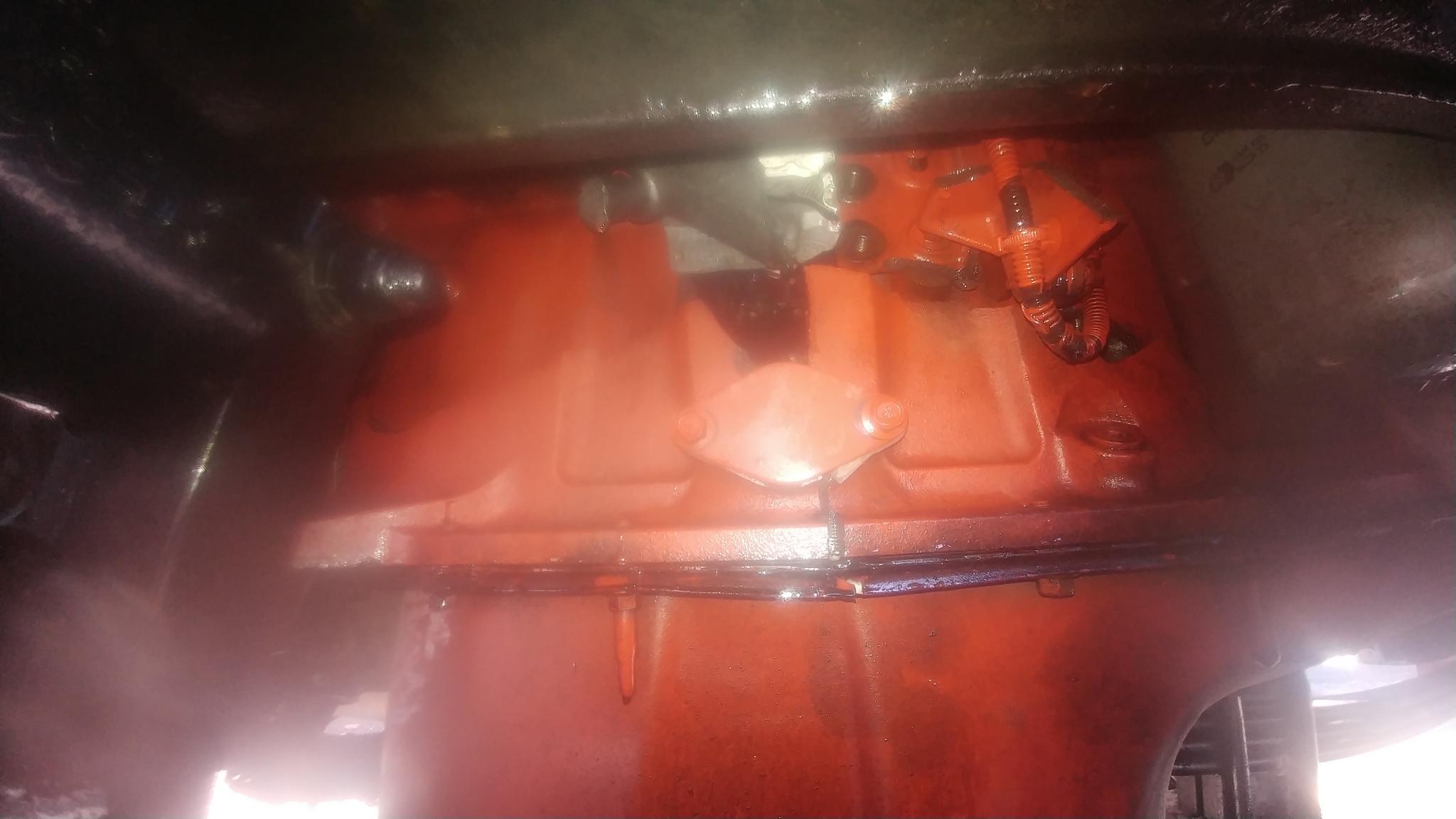

Well, here's first major failure on an x15 I've personally seen, and it's a whopper. 550-1850 tq in a W900b heavy haul tractor. Let go on a flatstretch of road at about 50mph. Not sure exactly what happened yet. 34k miles. Stone stock.
