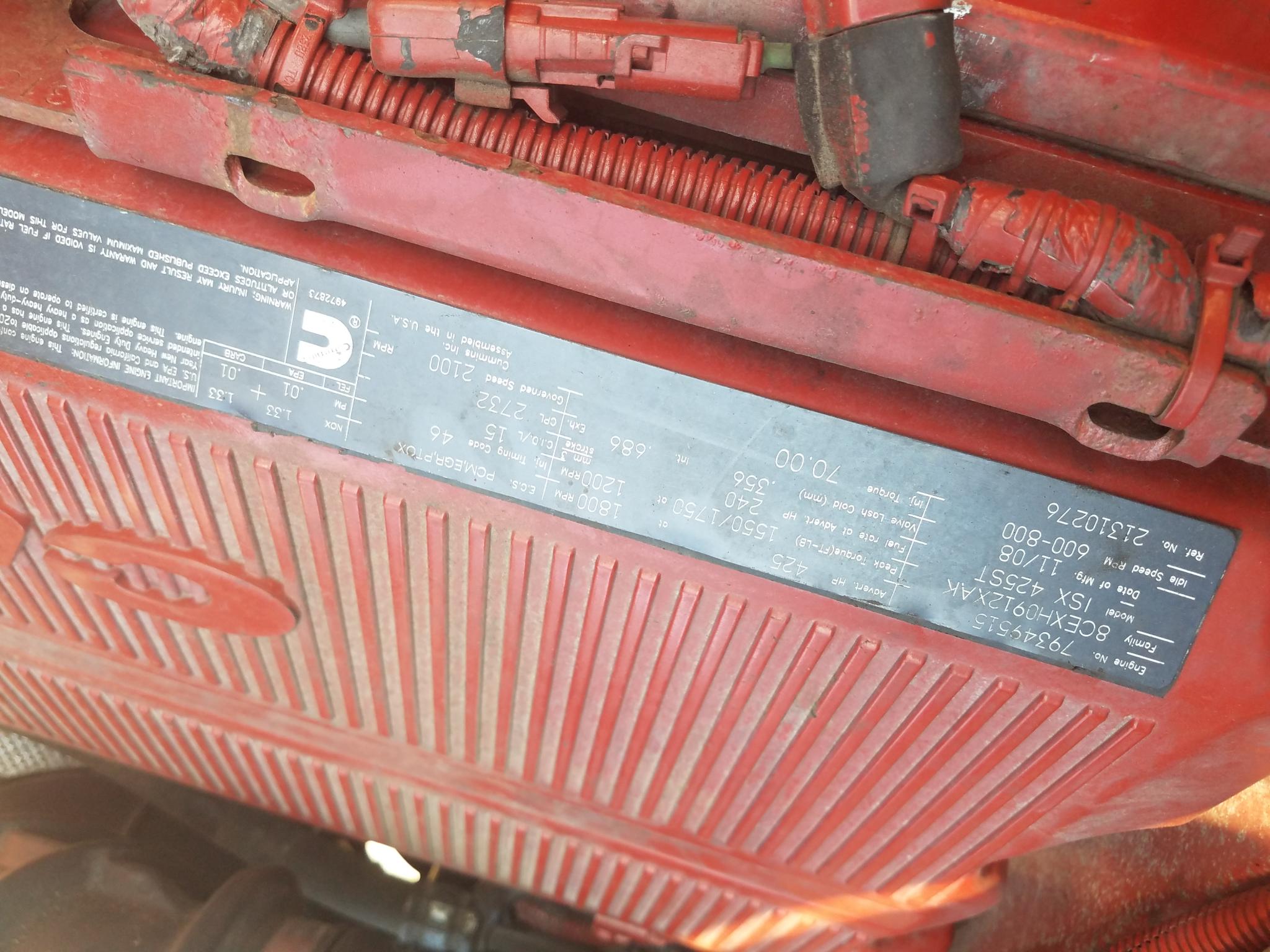

Hi everyone. Im a little bit worry about my oil pressure at 800rpm oil temp 188 my pressure is 30psi and at 1400rmp oil temp 204 my pressure is 32~33psi no lucas or gear lube added. Roughly 800k on the engime
ISX 425HP 11/2008.New oil pump abd main bearings
Any advice
Thank you
