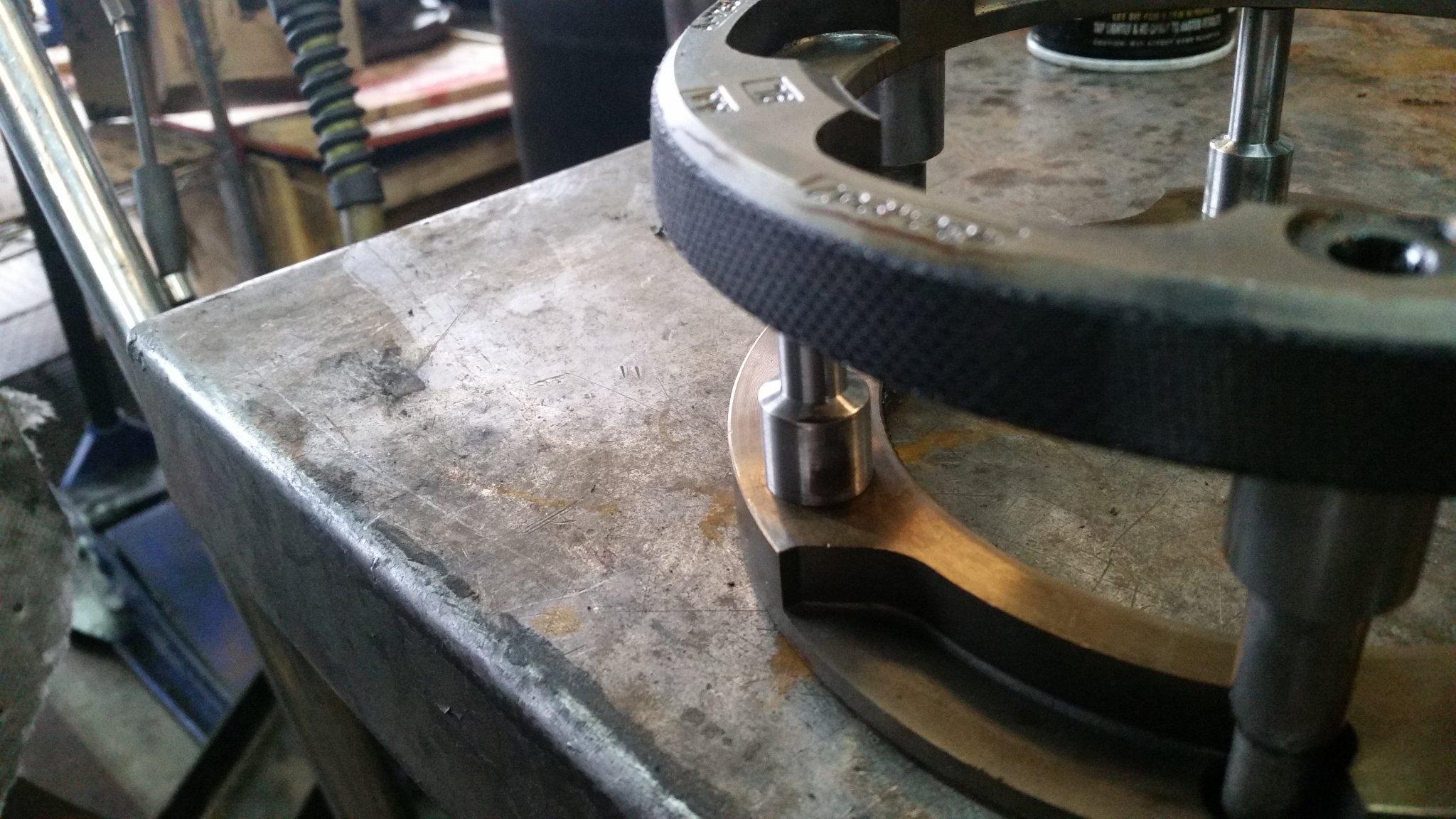

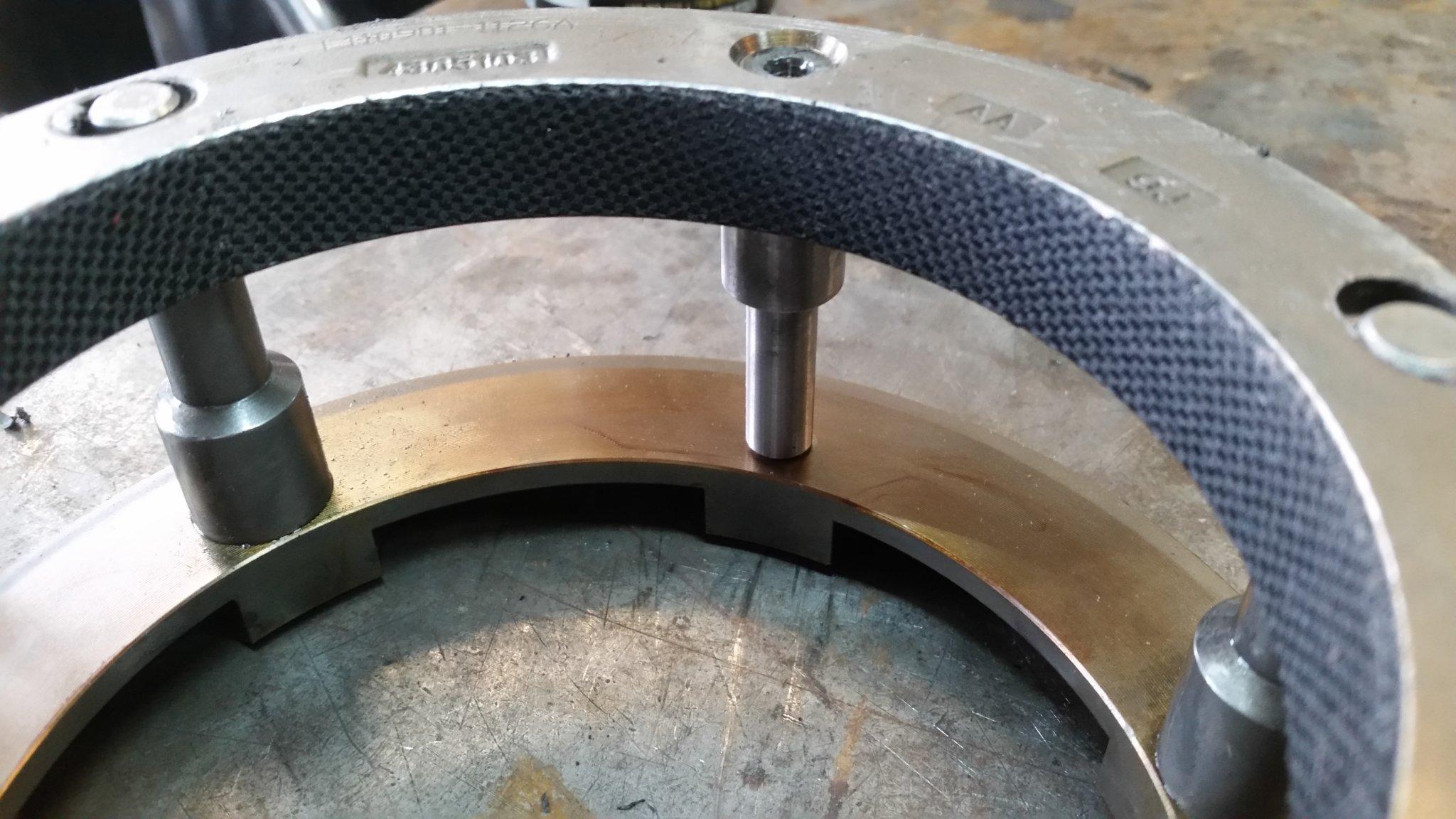

Here is the most amount of wear we could find. It is the wear on the synchronizer, it still looked pretty damn good though...
Not bad for 1.4 million original miles on it. By feel, you could tell it had some polishing on it / was not as rough as a new one would be, but it still looked and operated great.

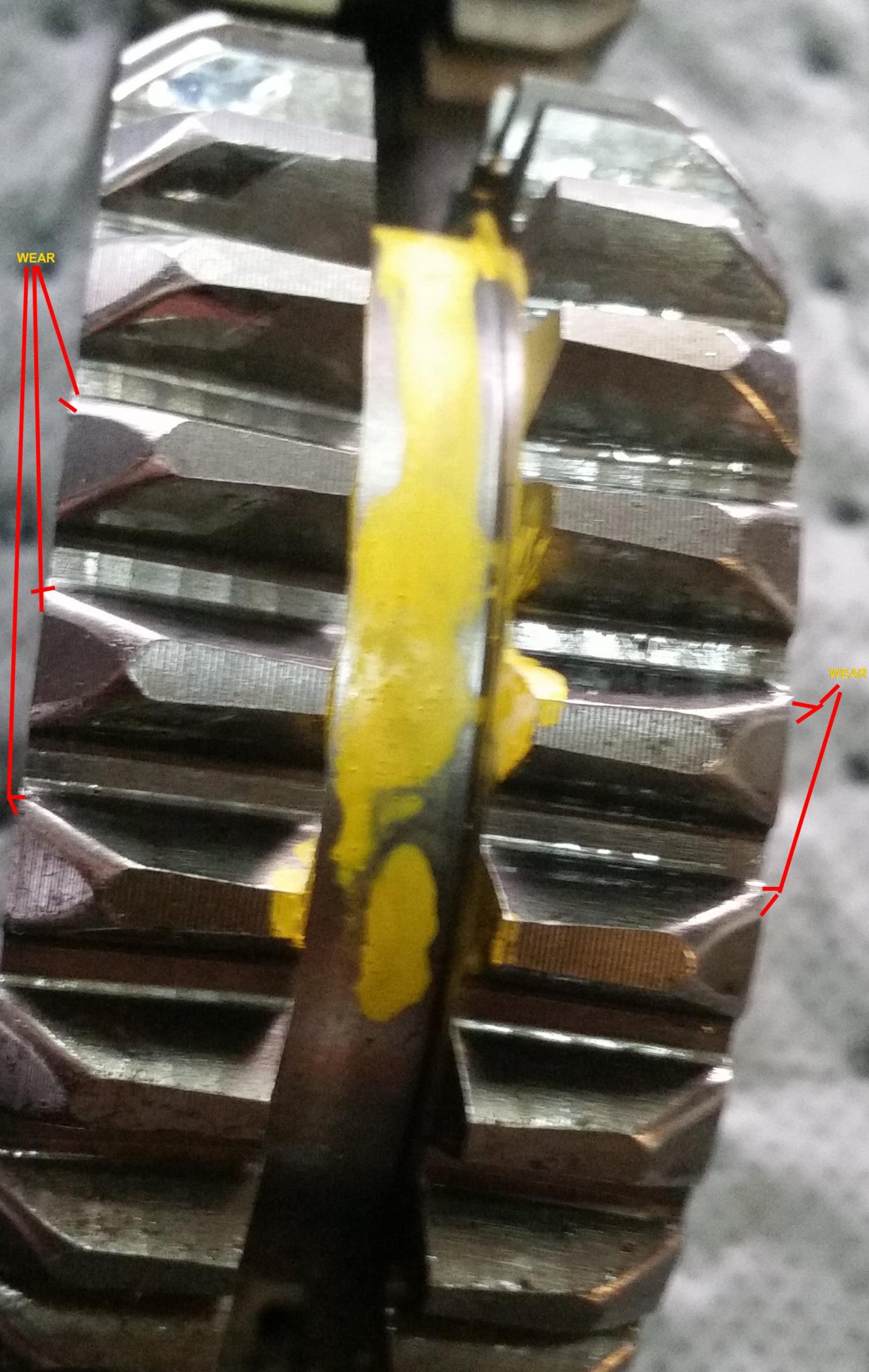

The highest worn gear was 9th and 10th gears where they mesh. This truck gets shifted into and out of gear so many hundred times a day, as we shift in and out of neutral as much as possible to save fuel. We have done this for the whole life of the truck.
Here is the wear from those gears...

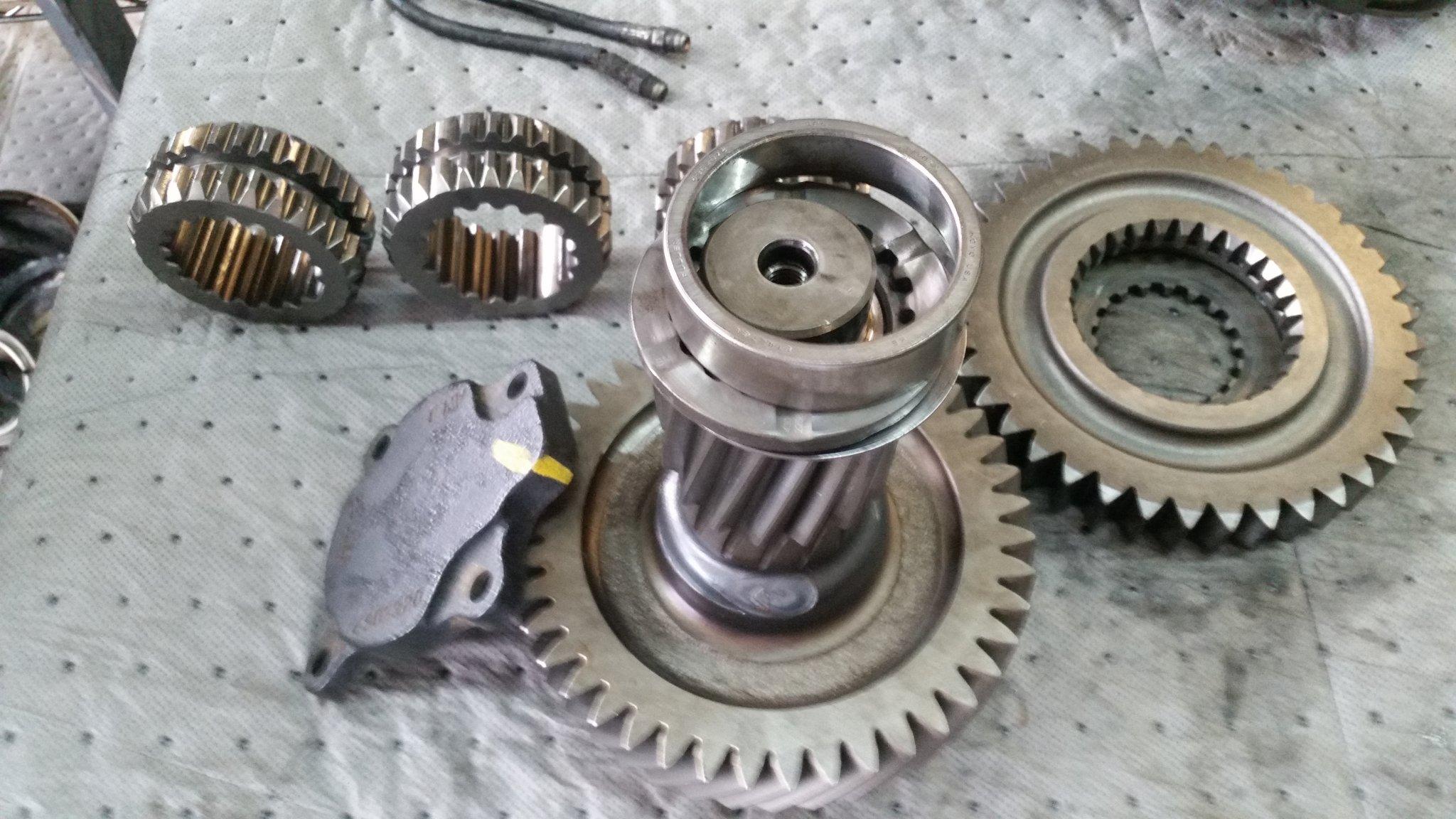

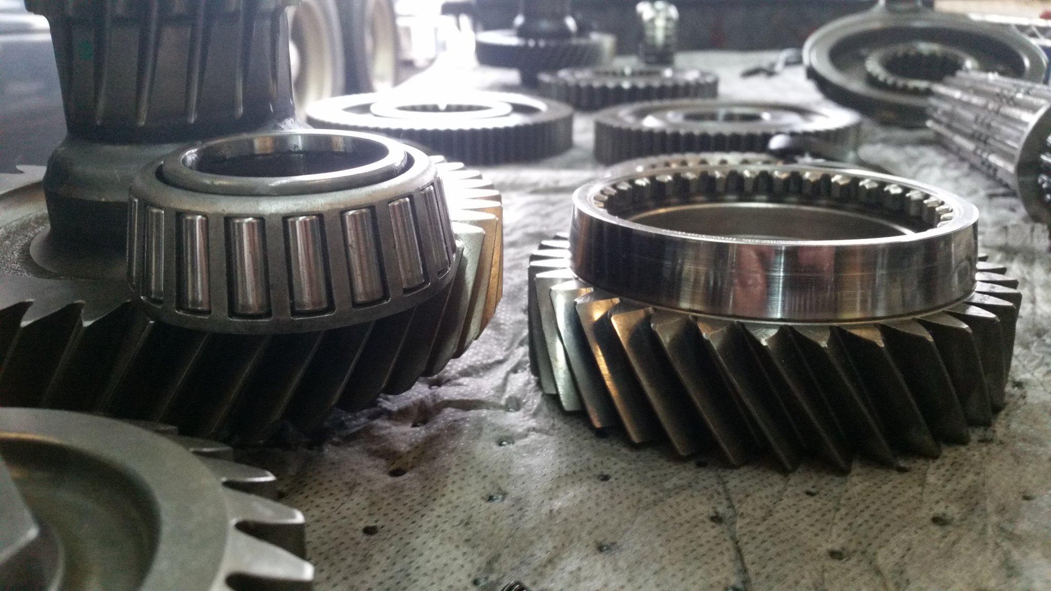

the rest of everything looked beautiful. Here is a few pics of other gears as they came out and were wiped off ...
nothing had any wear on it to speak of. Everything else literally looked like it was almost factory new in the whole tranny including the counter-shafts, bearings, literally everything was pristine. Even Mr.hag was scratching his head in dismay at how very little wear there was. He thought for sure he was going to find something in it somewhere because we ran it in neutral its whole life, but quite the opposite happened.
