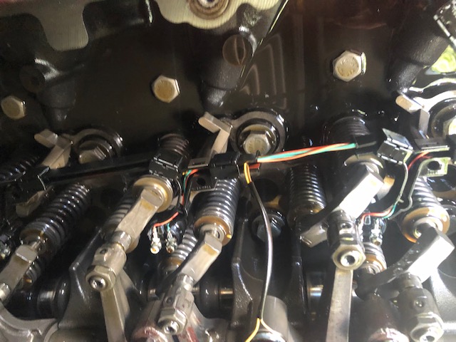

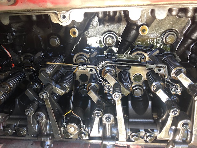

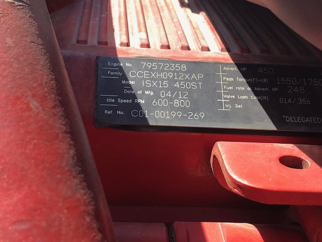

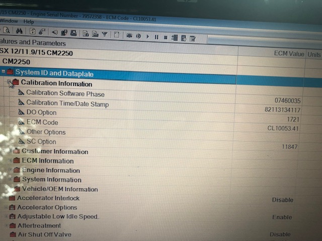

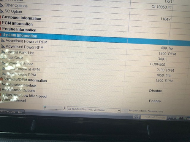

I have a 2012 ISX CM2250 , has 615xxx . As of today its running "Great" , I understand these are pictures but I still value your time and opinion about them . Let me know what you think and thanks again for what you do for O/O community .
./uploads/201906/post_3279_1560051333_abf1204c0a9ae968c9f7062d5117b675.jpg./uploads/201906/post_3279_1560051351_a40f84c525d848f26f9bf829f001ade0.jpg./uploads/201906/post_3279_1560051314_bca623d507d3d0d769a362c7b61fb4ca.jpg./uploads/201906/post_3279_1560051381_bfd85ae3dc9ea7eb1088626787857cf1.jpg./uploads/201906/post_3279_1560051391_c1abfdcfacac76768f3ed3eeacabe06b.jpg

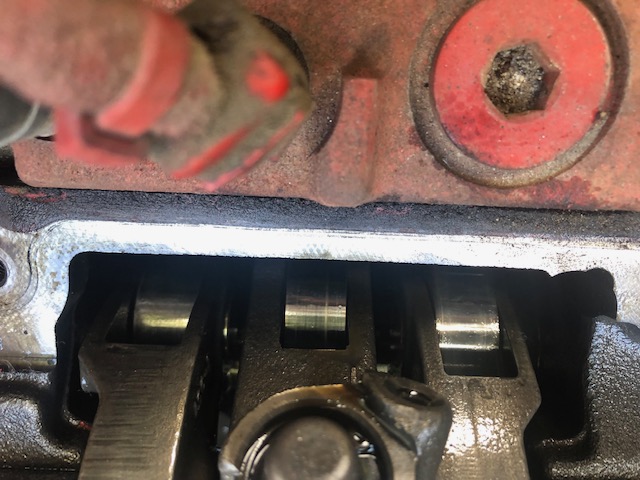

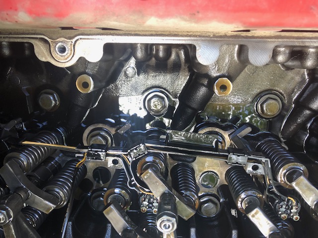

couple more pics ..

AND ACCORDING TO WHAT YOU POSTED, YOU NOW ALSO HAVE 100%, THE WRONG PROGRAM IN YOUR ECM TOO!!!!! --- THE FILE YOU ARE SHOWING DOES NOT EVEN HAVE THE SAME DAMN HARDWARE FOR YOUR ENGINE,.. WRONG CPL, WRONG INJECTORS, WRONG CAC UNIT, WRONG EVERYTHING!! -- AND IF YOUR SUPER-DUPER MECHANIC WAS SO GODDAMN GOOD AT WHAT HE DOES, THEN HE WOULD HAVE SEEN THAT SH#IT RIGHT AWAY!!!! -- FIRE YOUR MECHANIC WHEN IT COMES TO BAD PROGRAMMING, BECAUSE THAT IS EXACTLY WHAT YOU GOT IN THAT THING!!! -- THE WRONG TIER PROGRAM IN IT, BAD DELETE OR NOT!!!.
-- I don't care how you "think" your engine is running!!! --- PLAIN AND SIMPLE!!!
-- THAT 10053 CALIBRATION AND ITS ADVERTISED (BUT NOT LIKELY ACTUAL) POWER AND TORQUE SETTINGS ALSO LOOKS EXACTLY JUST LIKE THAT P.O.S. GARBAGE PROGRAM THAT HAS BEEN PASSED AROUND ON THE INTERNET TRUCK-TUNING SITES THAT PEOPLE ARE USING TO MAKE BAD DELETES, AND COPIES THEREOF!!! -- BUT UNTIL YOU PULL IT AND HAVE THE PROGRAM INSPECTED LIKE I SUGGESTED, YOU WILL NOT KNOW, BUT REGARDLESS, YOU HAVE THE WRONG CPL PROGRAM IN IT SO IT HAS TO BE FIXED ANY WAYS!!!

Also, the picture is blurry. But the 2nd pic down, in the lower left corner, the cam lobe looks to be chewed up. It could be the shadow. But it definitely has the look of a scrubbed lobe.
06-10-2019, (Subject: Fuel injector Test .. thoughts ??? )
RE: Fuel injector Test .. thoughts ???
I see those lobes too chamberplains...2 look to be starting to flatten out.
