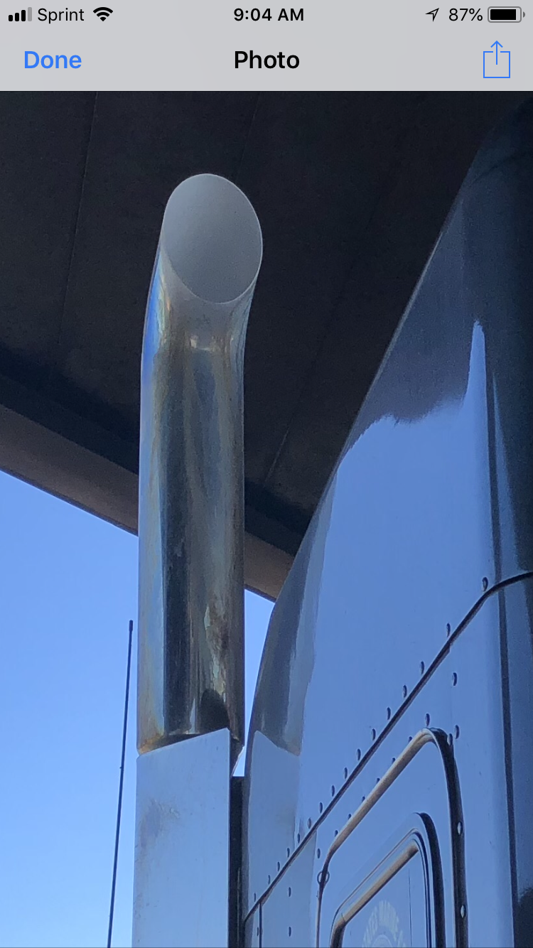

Hey guys-
I’ve noticed my exhaust stack has been turning white. I have about 480k miles on the truck. Runs great (knock on wood). Our oil samples have been clean with no coolant. Haven’t had to add any either. We’ve been using Howes fuel additive for each fill up (which might be causing this). Any other suggestions, thoughts or opinions?? I called Cummins and they said we don’t have to use additive quite that often but I won’t hurt or help the performance of the engine. Let me know what y’all think. God Bless.

Emissions still intact? Just looks like normal urea deposits to me.

I agree with brock. That is normal deposits from the urea...

Emissions are still intact. Thanks for the information guys. Really appreciate it.
