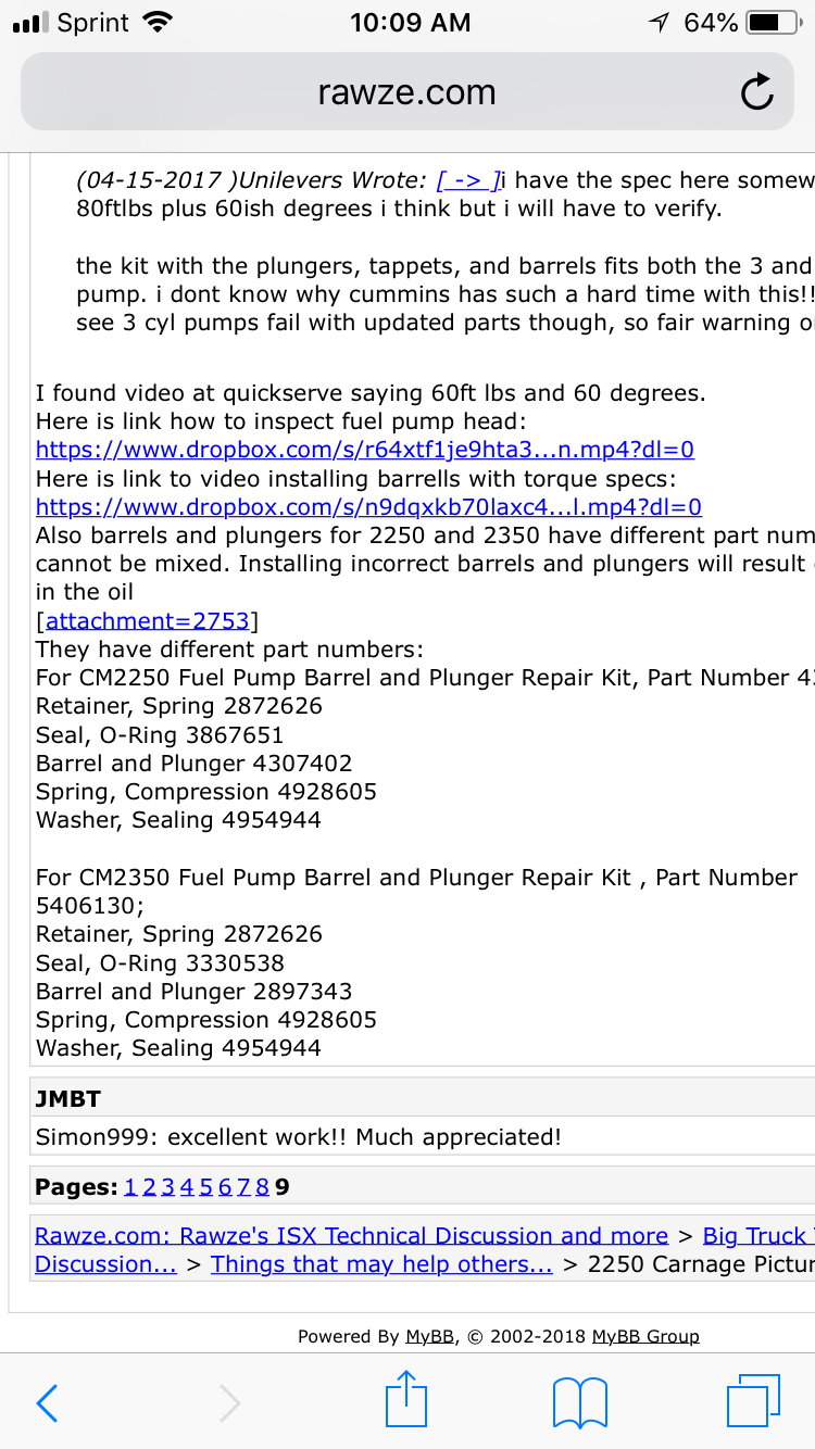

Here are the fuel pump parts numbers for the ISX15 2250 and 2350. They ARE NOT compatible with each other.
link: http://rawze.com/forums/showthread.php?t...5#pid14615
./uploads/201810/post_3559_1538579748_7d2081c8b0d924a6fce9adbdae74a85c.jpeg
