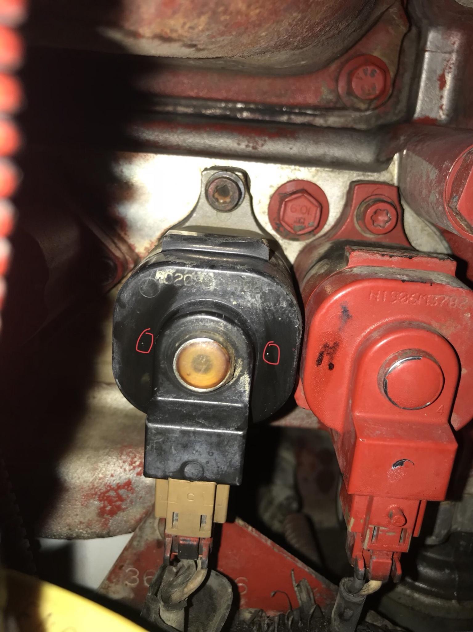

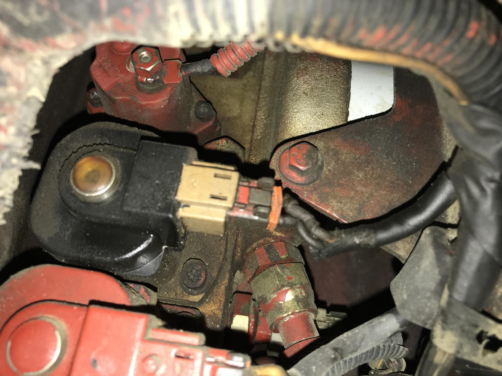

07 Peterbilt cm870 with 485k miles. Been running it for a little over a year, tuned by a member here and the truck has treated me very well. A couple months ago started to notice the pump and one actuator forming damp spots here and there, timing actuator to the left off the shut off solinoid was leaking out of the plug so I replaced it. Last week the truck started to run a little rough again, new fuel filters help a little at first when I service it which makes me assume it’s fuel related. The timing actuator I replaced is now leaking the same way the original one was.

That leaking actuator looks like a gasket failure. Did you replace the gasket when it was replaced and did you torque the cap screws down properly? Cummin quickserve will have the proper installation and torque spec. I believe its only inch\lbs its gets torqued to. Also the wires going to the actuator look like they've been repaired or are swollen from fuel saturation. You may want to take a hard look at the whole harness and replace it if necessary. They are a common failure point the older they get.

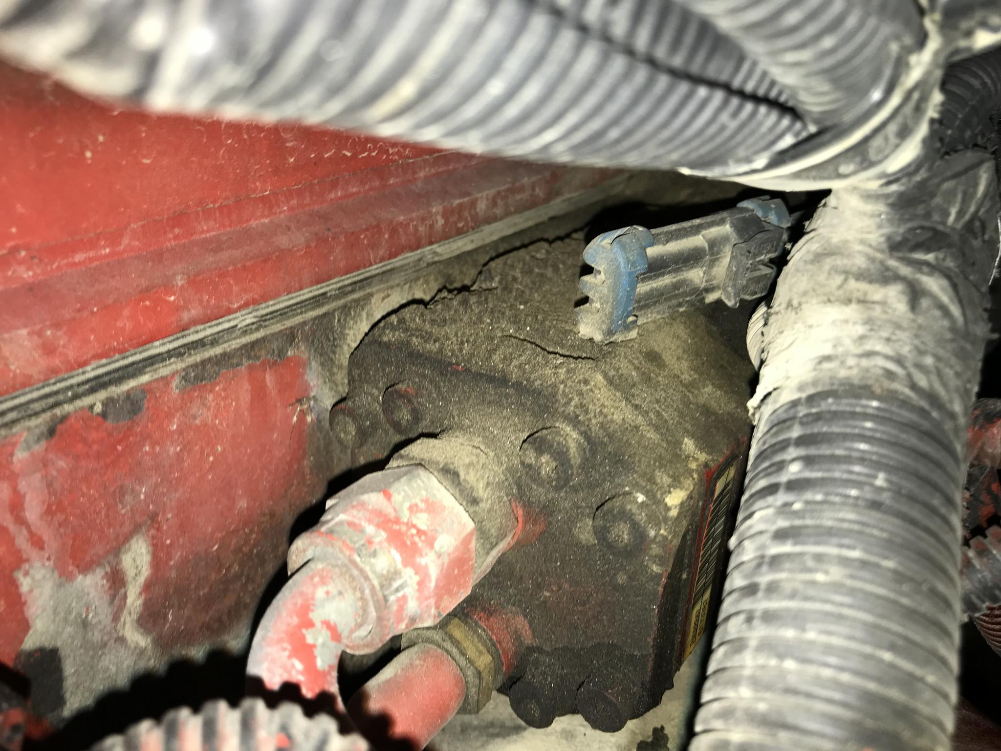

The fuel pump looks to be factory and never replaced. It looks like its leaking so I would be looking to replace it. But you can clean it up and run it to see if the leak comes back. Also quickserve should have guidelines on when to replace that pump.

(10-17-2018 )Chamberpains Wrote:  That leaking actuator looks like a gasket failure. Did you replace the gasket when it was replaced and did you torque the cap screws down properly? Cummin quickserve will have the proper installation and torque spec. I believe its only inch\lbs its gets torqued to. Also the wires going to the actuator look like they've been repaired or are swollen from fuel saturation. You may want to take a hard look at the whole harness and replace it if necessary. They are a common failure point the older they get.

When I replaced the actuator i replaced the gasket as well, torqued to what quickserve said (forget exact specs atm)
It’s all original fuel pump, truck was used for local fuel hauling before I bought it. I bought it with 383k and overhead was done right around 100k ago soon after I brought it home. I now use it for local dump trailer work, hauling relatively heavy ~100k gross most of the day. It’s due for an overhead adjustment, that’s on the to-do list

Also would it be smart to replace the gear pump since it’s damp around it?

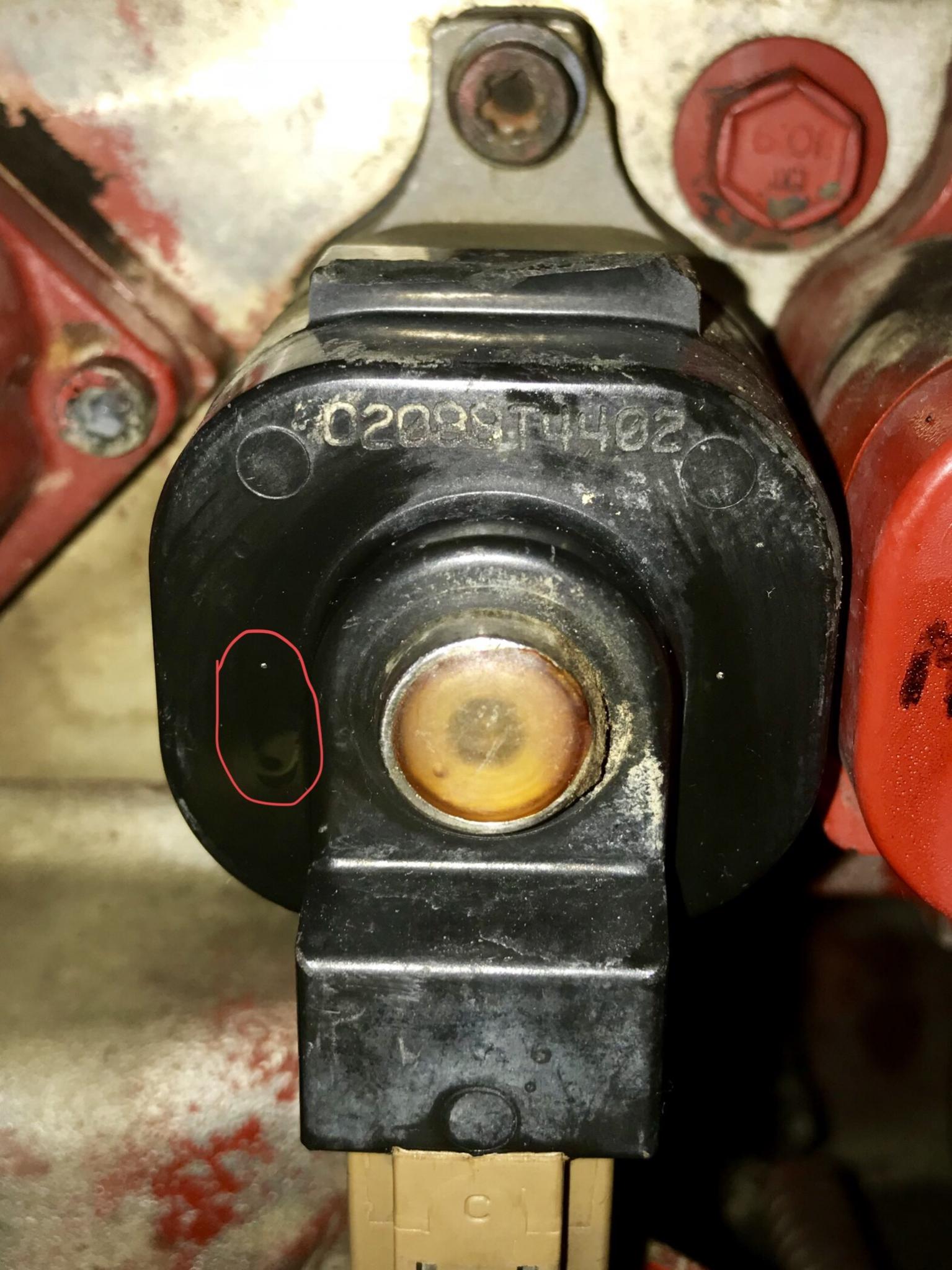

cleaned everything up and ran it for a day. some fluid weeping from where the gear pump is mounted, but the timing actuator to the left of the shutoff solinoid is damp at the plug

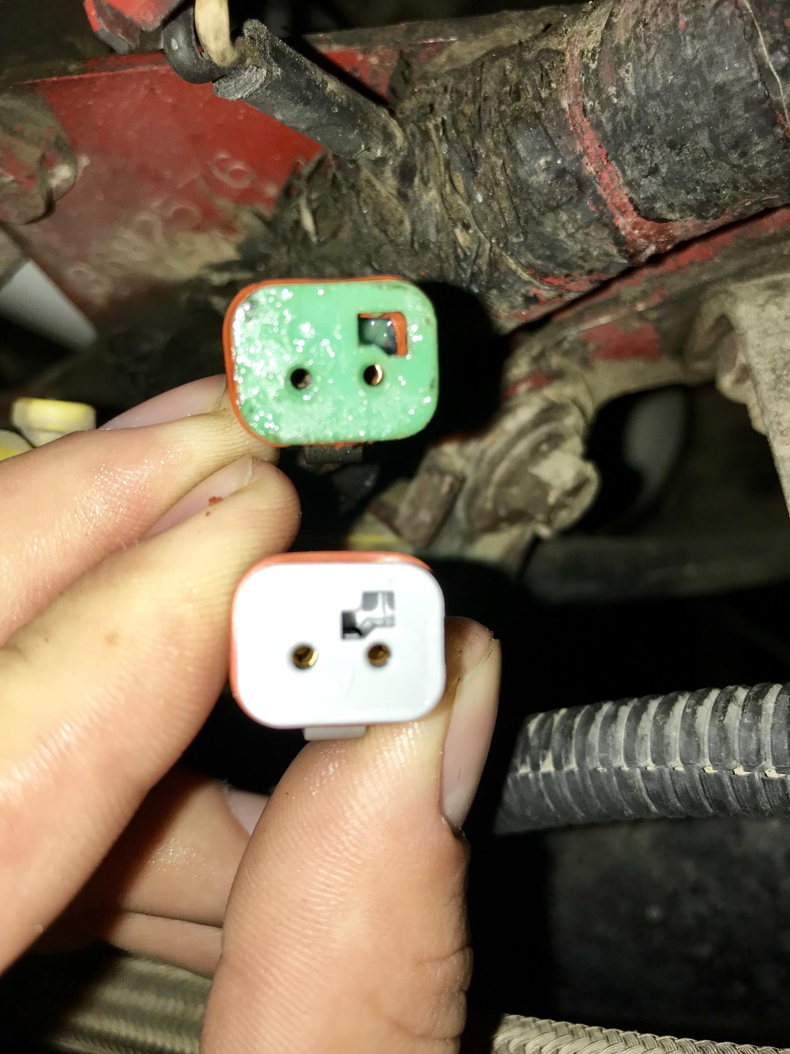

tried ordering new plugs, is there a part# for these plugs? Tried looking on quickserve but couldn’t find a part#
Also, the actuator I replaced a few months ago has 2 pin holes in the front that weep fuel out of them??? The factory actuators don’t seem to have that. I’ve never seen it before, i swapped the metering/timing actuators from left to right tonight and that’s when I noticed the pin holes getting wet.

(10-21-2018 )berrytrucking94 Wrote:  cleaned everything up and ran it for a day. some fluid weeping from where the gear pump is mounted, but the timing actuator to the left of the shutoff solinoid is damp at the plug
Attached are pics of the holes in the actuator..
The actuator is bad. Replace it!.
DO an injector leak tesrt while you at it. It might very well be that you have combustion gasses over-pressurizing the actuator and causing its demise!>

Replaced leaking actuator, made a small difference in the rough idle.

I want to change the actuator plugs that tie into the wiring harness but can’t find the right part numbers on quickserve. Asked a local parts shop and they said I’d have to buy the whole damn wiring harness which is not cheap. Anybody know where I can look for these actuator plugs??
