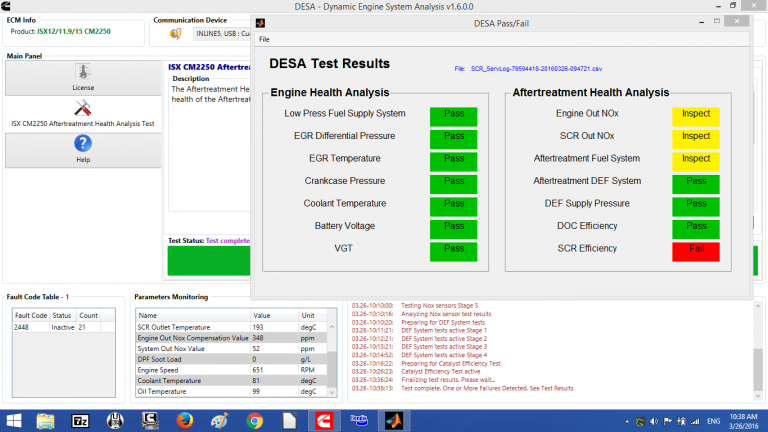

All you guys with 2250 / 2350 can donwload DESA from Cummins email them for password and use this test to figure out what is wrong.
My regens are good in time and temperature but
./uploads/201604/post_1794_1461956844_6438d10058dc5db606856259cf321041.png

(04-29-2016 )snailexpress Wrote:  All you guys with 2250 / 2350 can donwload DESA from Cummins email them for password and use this test to figure out what is wrong.
Seems like that would be a really useful tool! Is the password free from Cummins?
