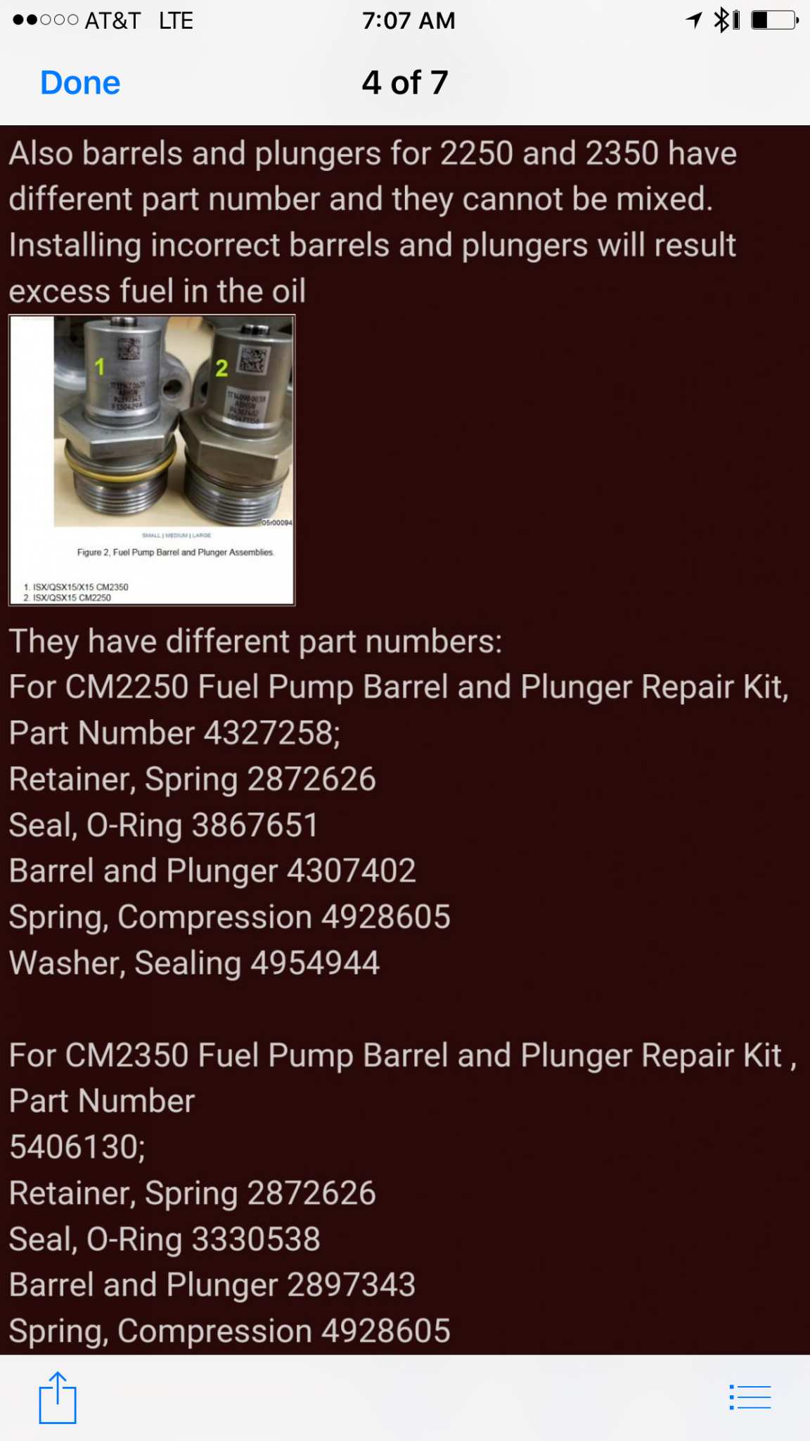

2250 pump is not interchangeable with 2350. It's looks same and mounting could be same but fuel pump calibration is different.

I say it's 2350 because in this photo the number 2 is for the cm2350 and my old pump brings the number 1 of the photo that is for the 2250. ? my new pump brings part 1, I have to change this part for part 2 of 2250

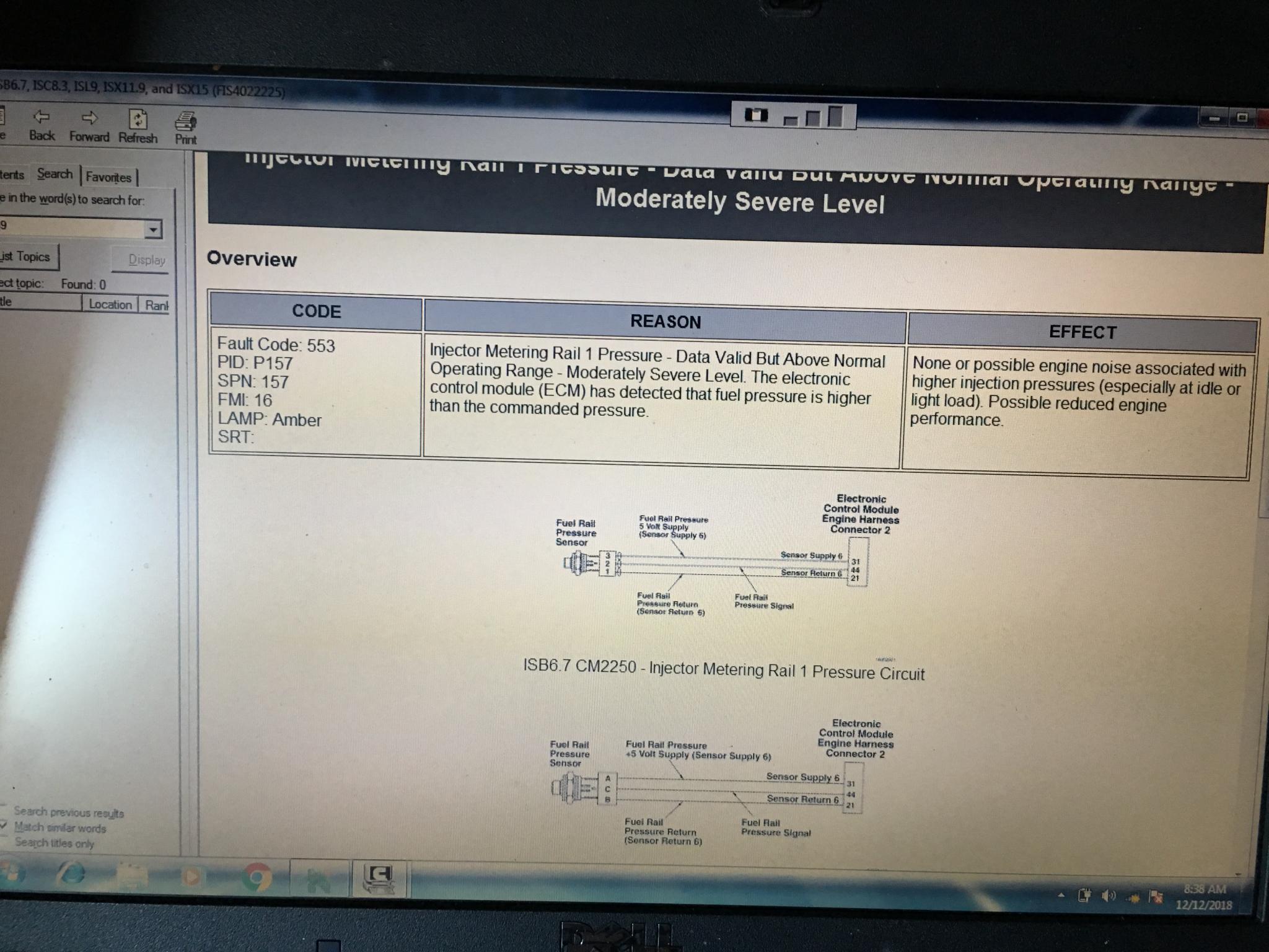

friends and I install it to the truck and it gives me this code 553 I put photo I do not change anything I put it as it came
