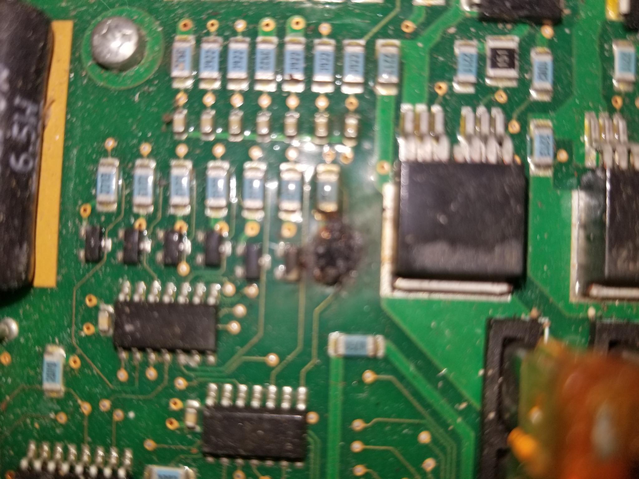

The 50 amp fused goes to the board, the unfused one goes to the starter stud that is connected to the battery through a 200 amp fuse, the small wire has a diode in it and is the voltage sense wire for the alternator.
I would say if you are not getting voltage to pull the coil then the board is bad. Mine was stuck in the energized position and fried any coils i replaced. The hold side worked fine though...
