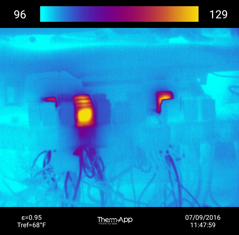

using a thermal camera usually reveals where the problem wires/fuses are ...
./uploads/201812/post_2_1546025953_538e98d0ff897fa94ff75526d1fab2bf.jpg

Any recommendations for one to use with android?
12-28-2018, (Subject: Blowing tail light breaker )
RE: Blowing tail light breaker
(12-28-2018 )RyanC Wrote:  Any recommendations for one to use with android?
flir makes a crappy one for android for bout $300 or so. Better then nothing.
The one i have is a thermapp. Cost about $1000 or so. much better quality.

Might just bight the bullet and order that thermo cam.
