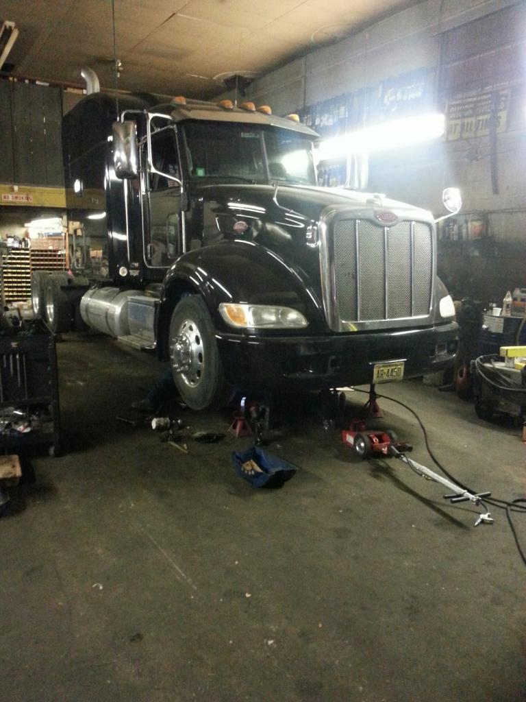

Scottydog did it right. Not something you want to do first time without an experienced hand guiding you.
./uploads/201605/post_65_1462312445_d9524c699bdb7c8b4d81771a94ba52aa.jpg
