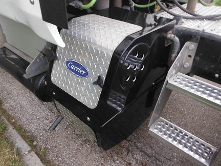

I run salty northern highways and my APU case looked more rusted than any I had ever seen on any other truck. I found a fibreglass case for my Carrier. After 4 years it still looked perfect, but it cracked at the very bottom where the access cover slips onto it. I fabricated a metal bracket and all was good. (I retired that APU for other reasons since)
