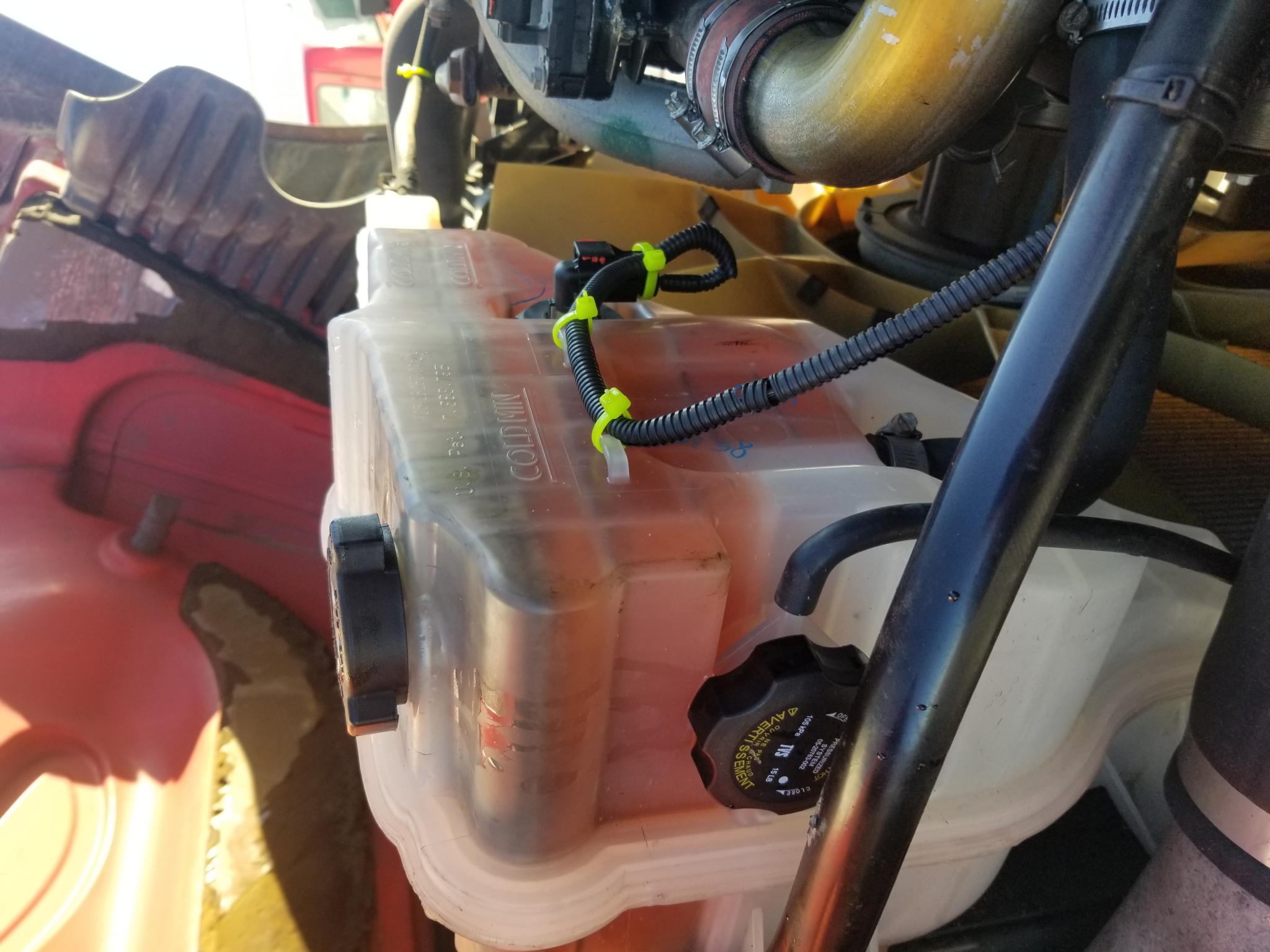

I have a 2011 Cascadia with a dd15, driver has to add a gal of antifreeze every 4-4500miles. When it started I assumed it was my egr cooler as it's went out before.
Truck runs fine, doesn't over heat. I dropped the pan to change the oil plug incert and there was no evidence or water in the oil. I can't say if it using oil as the incert would drip out about a half gal a week. Normally it doesn't use oil really.
I pressure tested the coolant system with pan off and didn't see any coolant. It held pressure well for a about 30min or so as I removed it. I can't tell if the loss of coolant was because of a loose clamp as I tightened all the hoses.

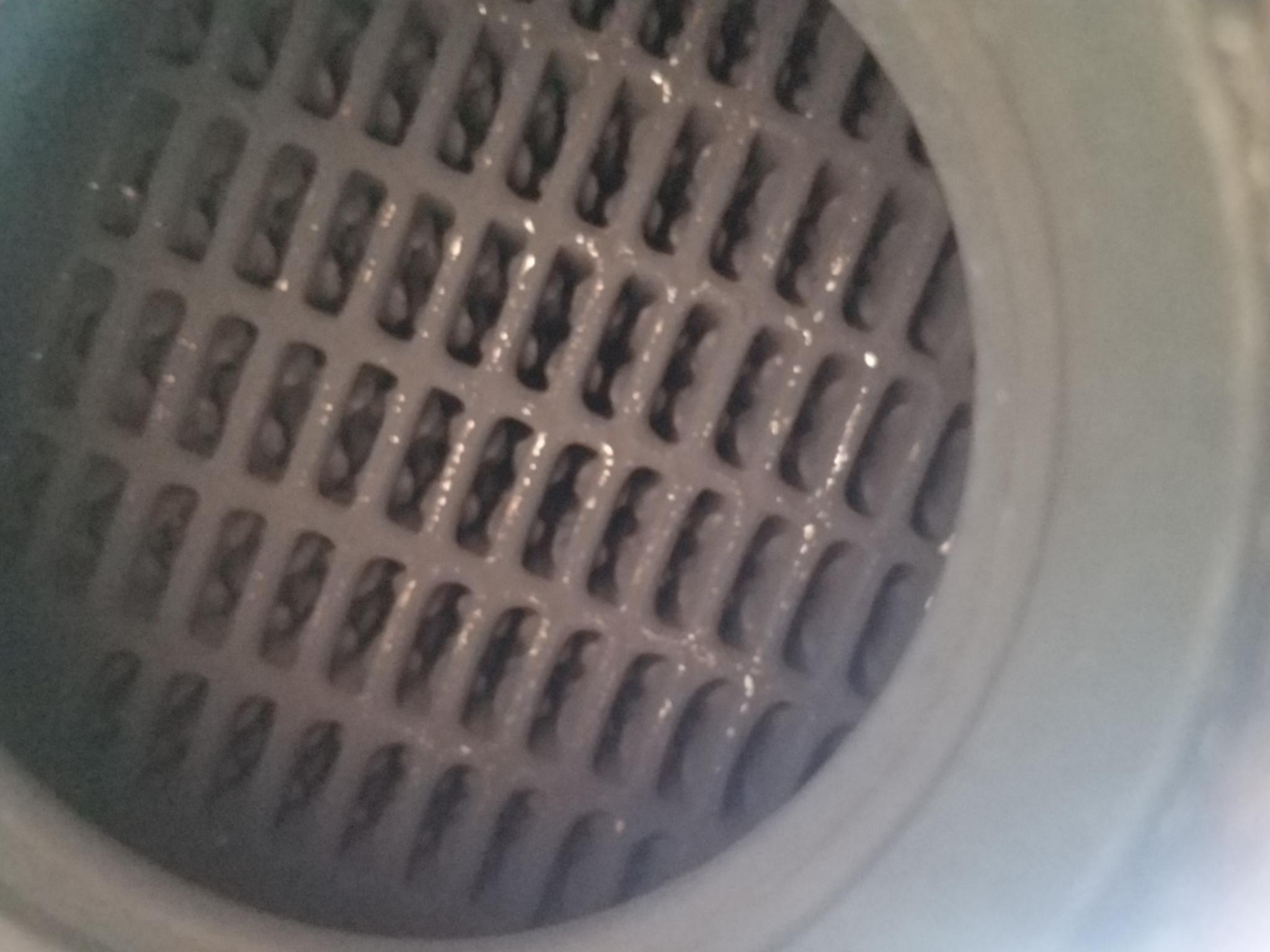

Today I took off the mixer pipe and the elbow that goes from the egr valve to the cooler and didn't see any evidence of coolant burning.
The truck starts super easy. Normal oil pressure. It's not building excess pressure in the coolant system
When you take cap off overflow it looks more like soot than oil and its sticking to the tank. It's not milky just dirty black whatever. You see some floating on top of the antifreeze but I can't tell if it's oil, diesel or what because it's so thin. Looks almost rainbow like swirl with a black outline.

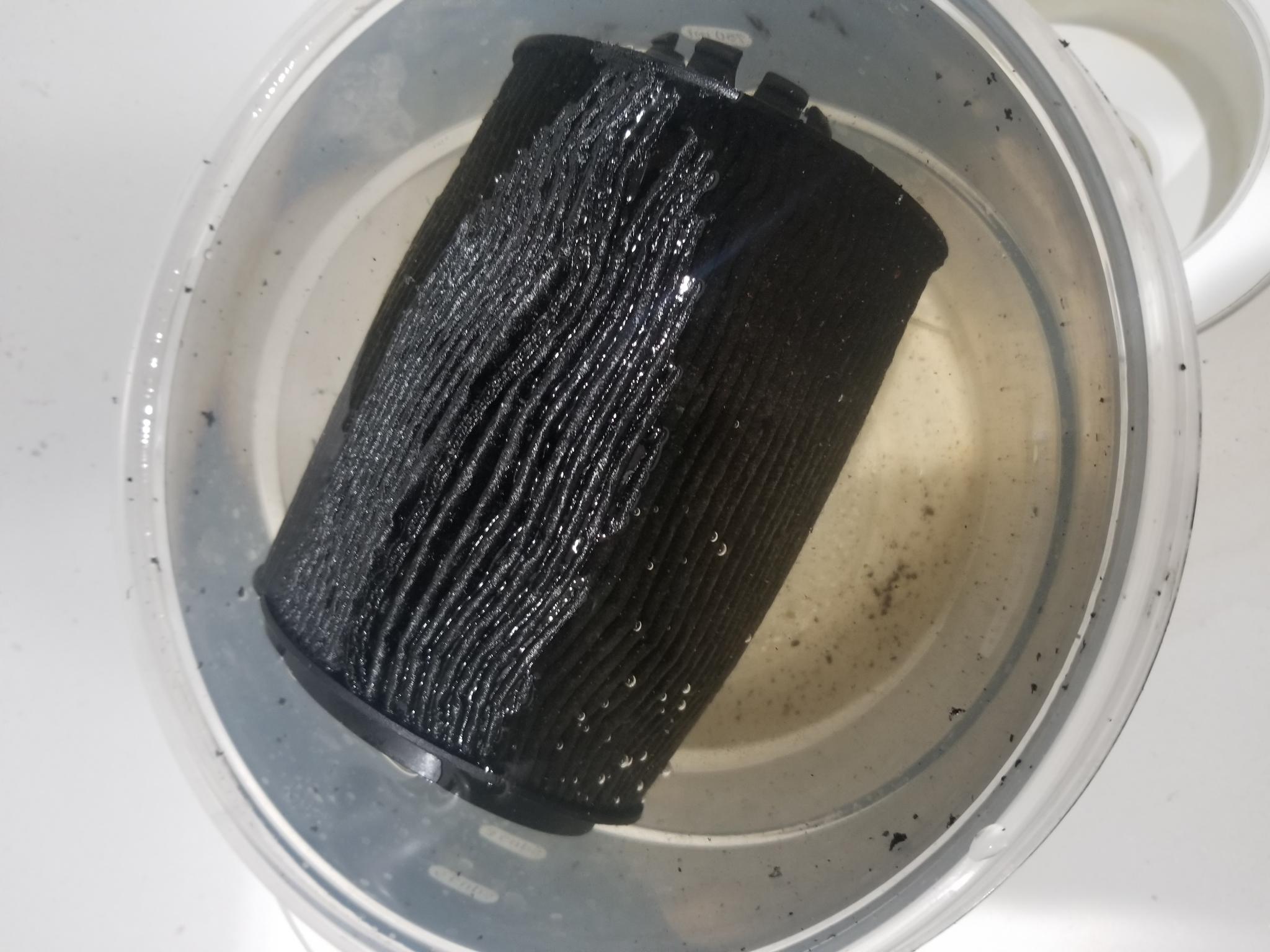

So I pulled coolant filter and saw this. As per Detroit I threw it away, they say to remove and not run one, It was 6 months old. It was Coming apart.
Not using any coolant anymore. I'm assuming one of the clamps I tightened was leaking or it was a cold leak.

(01-12-2019 )race7820000 Wrote:  So I pulled coolant filter and saw this. As per Detroit I threw it away, they say to remove and not run one, It was 6 months old. It was Coming apart.
Holy Sh1t!!! At first glance I thought it was your oil filter (thinking that it was an open style filter) I then strarted reading your post. Seems strange that Detroit says not too run one at all?

I can't find the actual bulliltion again but here is a copy and paste
The coolant filter has been removed from DD platform engines. The change comes with an improved Oil Cooler Module which resides on the front, left-hand side of the engine and houses the coolant pump, thermostat, oil fill, and oil filter. On engines built prior to this change, the coolant filter access cap was located just forward of the oil filter.
The current coolant filter is only partial flow (~15%). Testing showed that coolant and engine protection were not affected by the removal of the coolant filter. Customers will also benefit from reduced maintenance costs by eliminating the coolant filter inspection/replacement cycle.
The new Oil/Coolant Module is NOT backwards compatible on older engines. However, customers may choose to remove the coolant filter on their current engines at the next applicable Preventative Maintenance stop.
