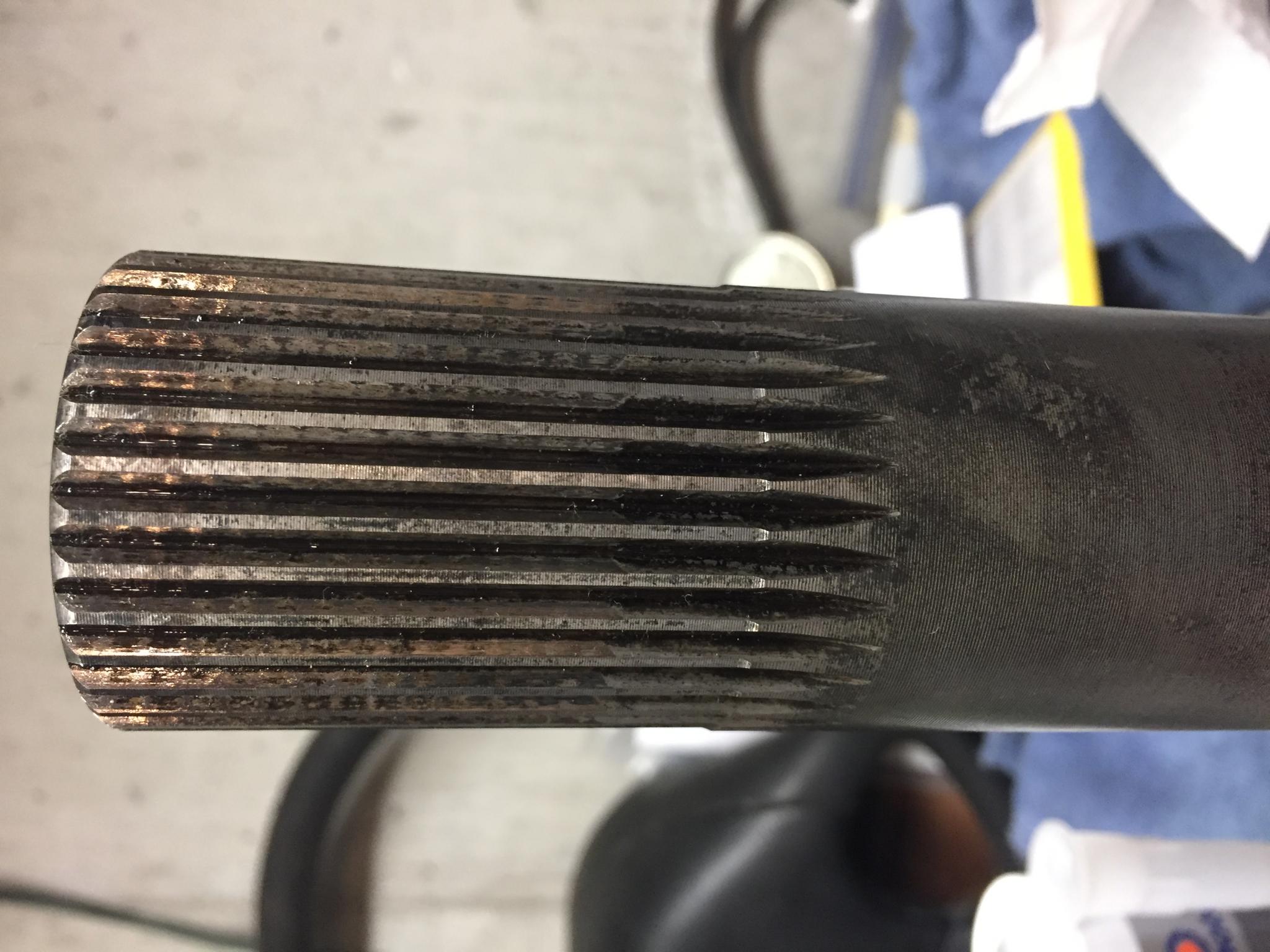

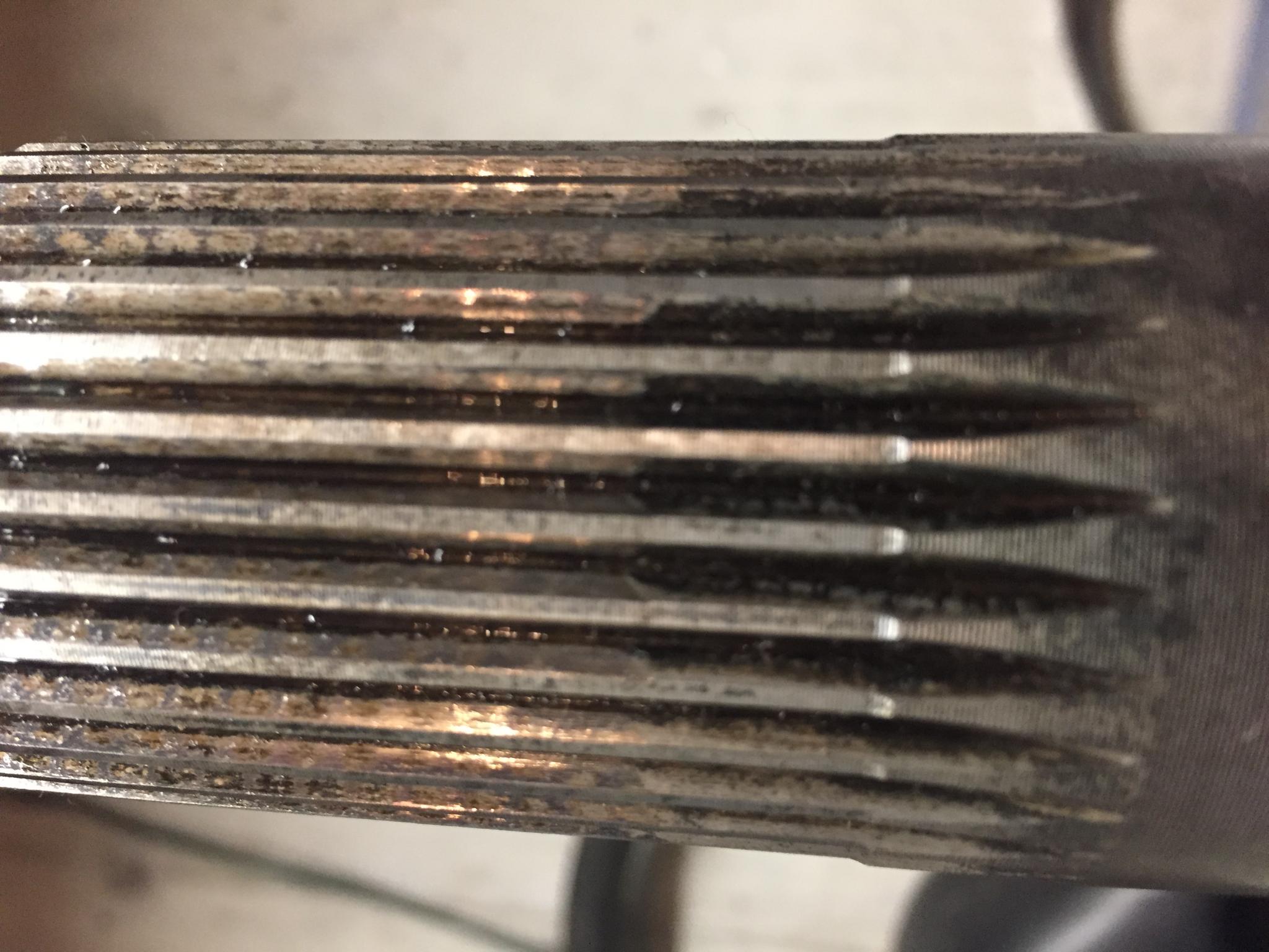

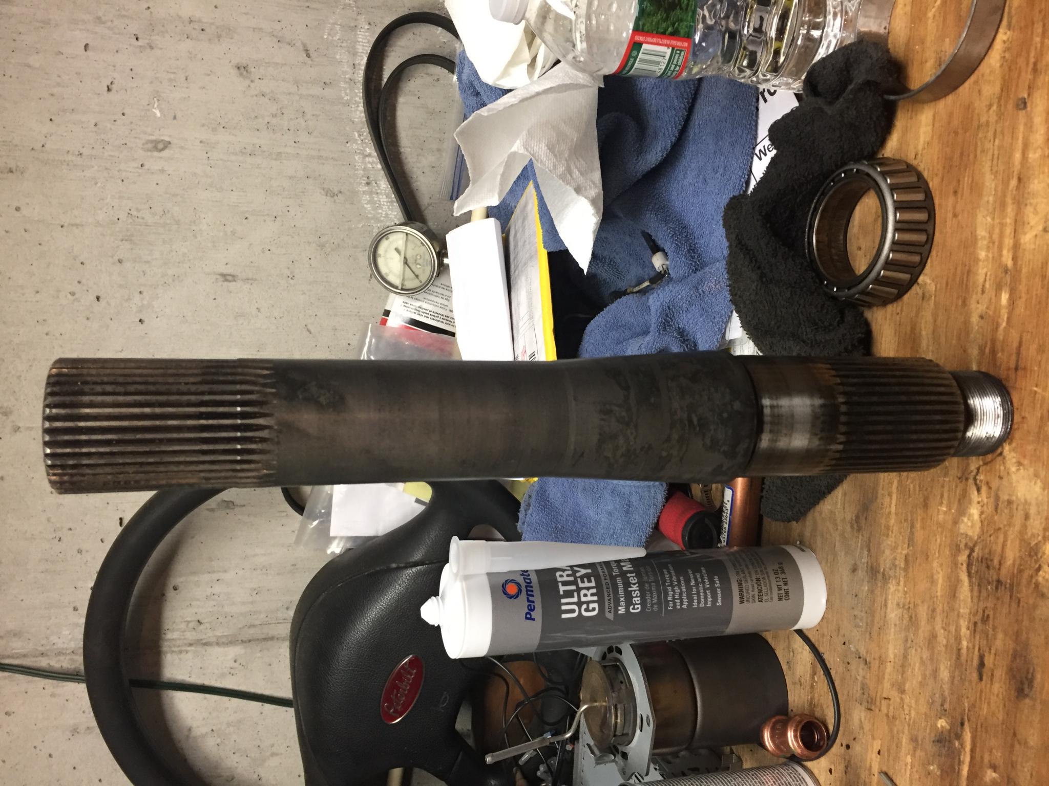

         Success!! I finally found the source of the vibration. It was the output shaft from the front diff to the rear drive shaft. And it could be changed from the outside without taking the whole diff out on this DSP40 differential.
 Thanks given by: imalumberjack , Rawze , Waterloo
02-23-2019, (Subject: Elusive vibration )
RE: Elusive vibration
So how did you end up finding it? What led you to pull the output shaft?
(02-23-2019 )JMBT Wrote:  So how did you end up finding it? What led you to pull the output shaft?
It had a new yoke put on about 6 months ago, and a new seal. The old was difficult to get off. The splines were a little goofed up on the end. The guy had to use a file to clean them up. Then run the yoke on with the nut. (It was a Friday afternoon, and we thought the diff had to come out to replace that). Recently was in warmer weather and the seal started leaking a little. I found out it comes out from outside the housing, and the parts were only about $220. That new yoke already had a groove in it, so it was replaced again, also.
Even though it felt tight, it just started making sense that if it was tweaked a little, it could be causing the front yoke of the rear driveshaft to be out of whack. Figured it was worth a shot.
(It took me so long to figure that out. I should have known about it and done it when I replaced the diffs. But I was just worried about getting it done. Knowledge is king!)
