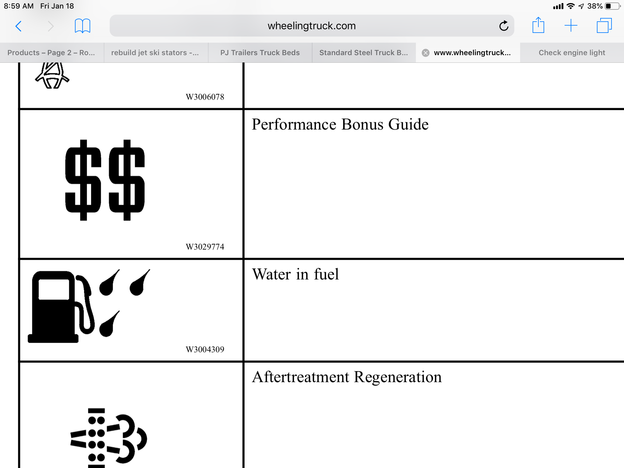

Oh wow! I never have gotten that actual code or I apparently never looked twice into it. That is the water in fuel code. I just changed my fuel filter on my truck 3 days ago and got that display as usual when I hit the button to prime the fuel system.

I looked into the actual Volvo Manual for this stuff and here we go.

(01-18-2019 )Volvo8873 Wrote:  I looked into the actual Volvo Manual for this stuff and here we go.

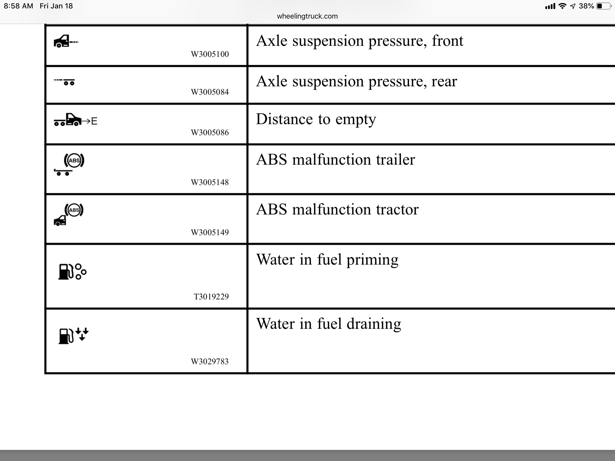

Yeah I saw that symbol idk why it looks different on our trucks but I guess the bubbles mean water, not the water droplets in the picture you posted? I drained my water separator last night and I have drove about 60 miles (short haul) and no lights and everything is normal. I also cleared the code this morning and hasn’t came back. I called a local shop that’s familiar with this cummins and he sounds like he knows what he’s talking about so I might take my truck there to have him still update my fuel pump.

The first picture out of the two I posted corresponds witht the display code that you get. Minus the little arrow.... Who knows though with these damn Volvo’s! LOL
