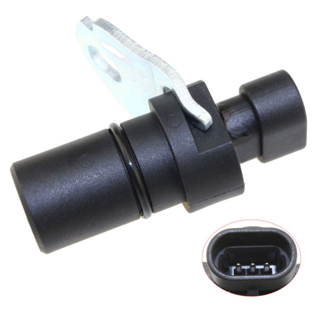

I replaced mine, cam and crank sensor, when I had a funny vibration/sound in the motor pop up, I posted on it here around two/three years ago. The cam sensor on the 871 is next to the Jake sensor on the driver side of the head. The crank sensor is down on the lower forward side of the motor on the driver side. It is the sensor down by the damper. They are around $30 ea +/-, same sensor, so buy two. It did make a difference when I replaced them, the motor did smooth out. I bet they were the original sensors from the factory. Here is the sensor, part number 4921599
This is cheap preventative maintenance.

On the 871 there is just the one cam sensor on the injection side of the head, nothing on the exhaust side. And the crank sensor down near the damper on driver side. There are only two on the motor. The crank sensor is kind of annoying to get to, and install, just takes a bit of patients to do it. Nothing major, just annoying, you really have to push to get it to snap in to the hole, and it is at an odd angle to get to, you do a bit of pretzeling.
