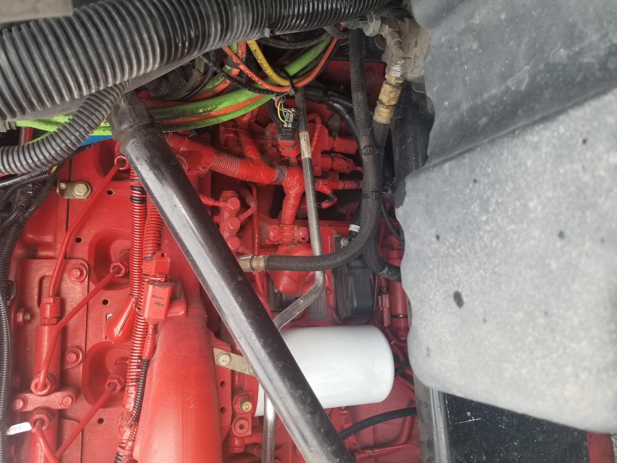

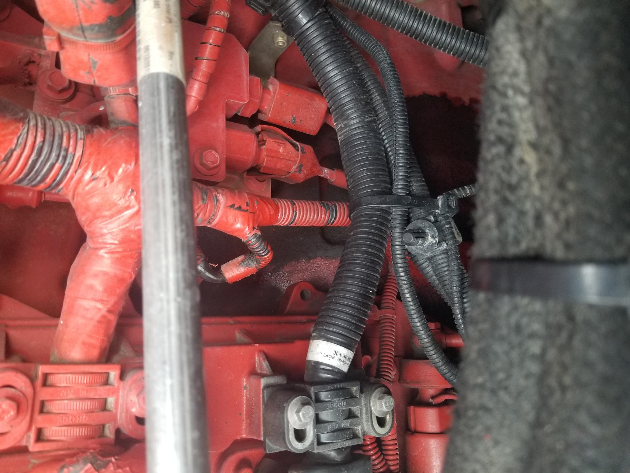

RE: 2013 isx15 oil leak behind ecm Here are a couple of pics as requested. As you can see the leak comes from behind the ecm. I don't know if there's a hose or gasket behind that could cause this. Thanks in advance. | |||

RE: 2013 isx15 oil leak behind ecm How do you know this is oil not fuel? | |||

RE: 2013 isx15 oil leak behind ecm (01-23-2019 )imalumberjack Wrote: I kinda have the same thing, just seen it this morning .......cleaned everything off and will watch. On mine I can see two places where it could be coming from and neither are in general area of oil deposit so I am thinking the fan is blowing it back there? I have a small leak on power steering unit (while working near it I turned the mickey mouse oem clamp because it was stabbing me everytime I reached in there and obviously it does not like its new position). The other is front cover over air compressor drive has a small leak (I had pulled the cover and it has a small bend in sealing edge ...didn't want to replace so I straightened in hopes it would seal ....no luck I guess) So there's nothing behind the ecm that would cause the leak? Also if it was leaking from the front (which I do have a leak) wouldn't it be dirtying around the fuel filter as well? Thanks | |||
01-23-2019, (Subject: 2013 isx15 oil leak behind ecm ) Post: #8 | |||
RE: 2013 isx15 oil leak behind ecm (01-23-2019 )freddy Wrote:(01-23-2019 )imalumberjack Wrote: I kinda have the same thing, just seen it this morning .......cleaned everything off and will watch. On mine I can see two places where it could be coming from and neither are in general area of oil deposit so I am thinking the fan is blowing it back there? I have a small leak on power steering unit (while working near it I turned the mickey mouse oem clamp because it was stabbing me everytime I reached in there and obviously it does not like its new position). The other is front cover over air compressor drive has a small leak (I had pulled the cover and it has a small bend in sealing edge ...didn't want to replace so I straightened in hopes it would seal ....no luck I guess) There's a cooling plate right behind the ECM, fuel runs through it on it's way to the injectors. I'm not sure if its common for those to leak?? But I suppose anything could leak. Fuel of course though, not oil. User's Signature: im_seeing_parameters_in_my_sleep 1 | |||
01-23-2019, (Subject: 2013 isx15 oil leak behind ecm ) Post: #9 | |||
RE: 2013 isx15 oil leak behind ecm (01-23-2019 )freddy Wrote:on mine I can see back there basically its just the side of the block maybe one sensor? if you have a leak up front it more than likely will be pushed toward rear? clean it then ... get out a blanket and pillow lay under and watch .......(01-23-2019 )imalumberjack Wrote: I kinda have the same thing, just seen it this morning .......cleaned everything off and will watch. On mine I can see two places where it could be coming from and neither are in general area of oil deposit so I am thinking the fan is blowing it back there? I have a small leak on power steering unit (while working near it I turned the mickey mouse oem clamp because it was stabbing me everytime I reached in there and obviously it does not like its new position). The other is front cover over air compressor drive has a small leak (I had pulled the cover and it has a small bend in sealing edge ...didn't want to replace so I straightened in hopes it would seal ....no luck I guess) | |||
