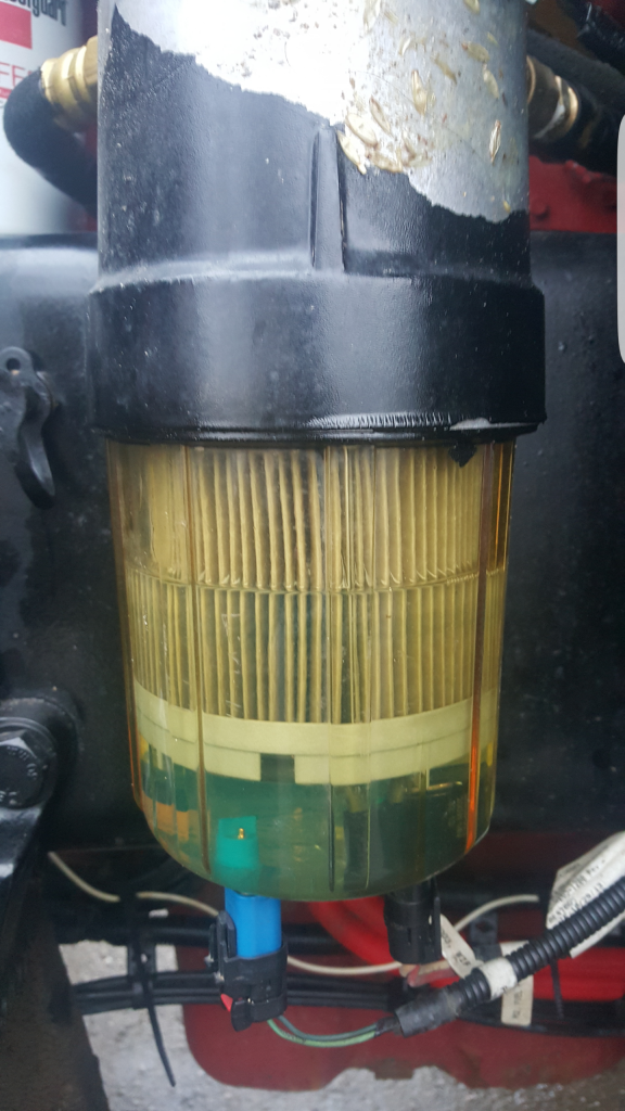

Has anyone had problems with the paccar fuel filter not staying full. I have gone though the fuel system from the filter back to the tanks looking for a restriction or something should I be looking some else? ./uploads/201605/post_2029_1462708954_073d73ed197e62e4488e925e1ad714fd.png

I don't think they are supposed to stay full during normal operation. I have the Davco unit on mine, when the filter is changed it may have 1/2 inch of fuel showing through the plastic dome, and as the filter ages the fuel level rises. Personally, I just drain the water off periodically and change at every other service. I have never seen mine full other than the time it hit -30 on the thermometer...
05-08-2016, (Subject: Paccar water seperator )
RE: Paccar water seperator
Two culprits on this.....
1. Check the large O-ring that goes on the plastic housing after you replace the filter...if it doesn't seal properly, it will not fill up. The bowl is supposed to be full, and if it isn't, it will cause you to not have enough fuel going to the pump and have acceleration problems.
2. Check to see if the pressure relief fitting on top of the unit is closed up. if it isn't, will cause it not to fill.
Also check to see if your electric pump is working properly...small round unit between the frame and the engine, below your high pressure return filter.

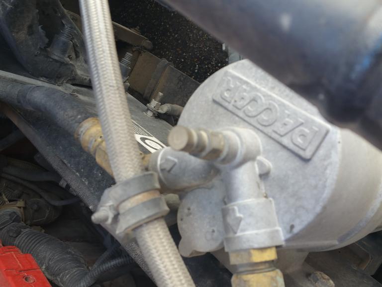

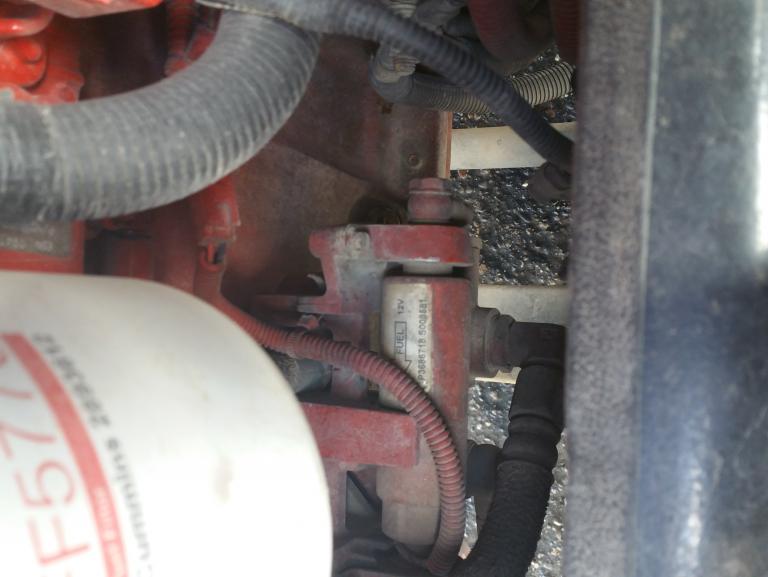

Here's the two culprits...
./uploads/201605/post_923_1462738561_5b26e42f9e227cbd0abae032ca6e915a.jpg./uploads/201605/post_923_1462738530_1d7719673ced48b727704e6d651cb3d6.jpg
