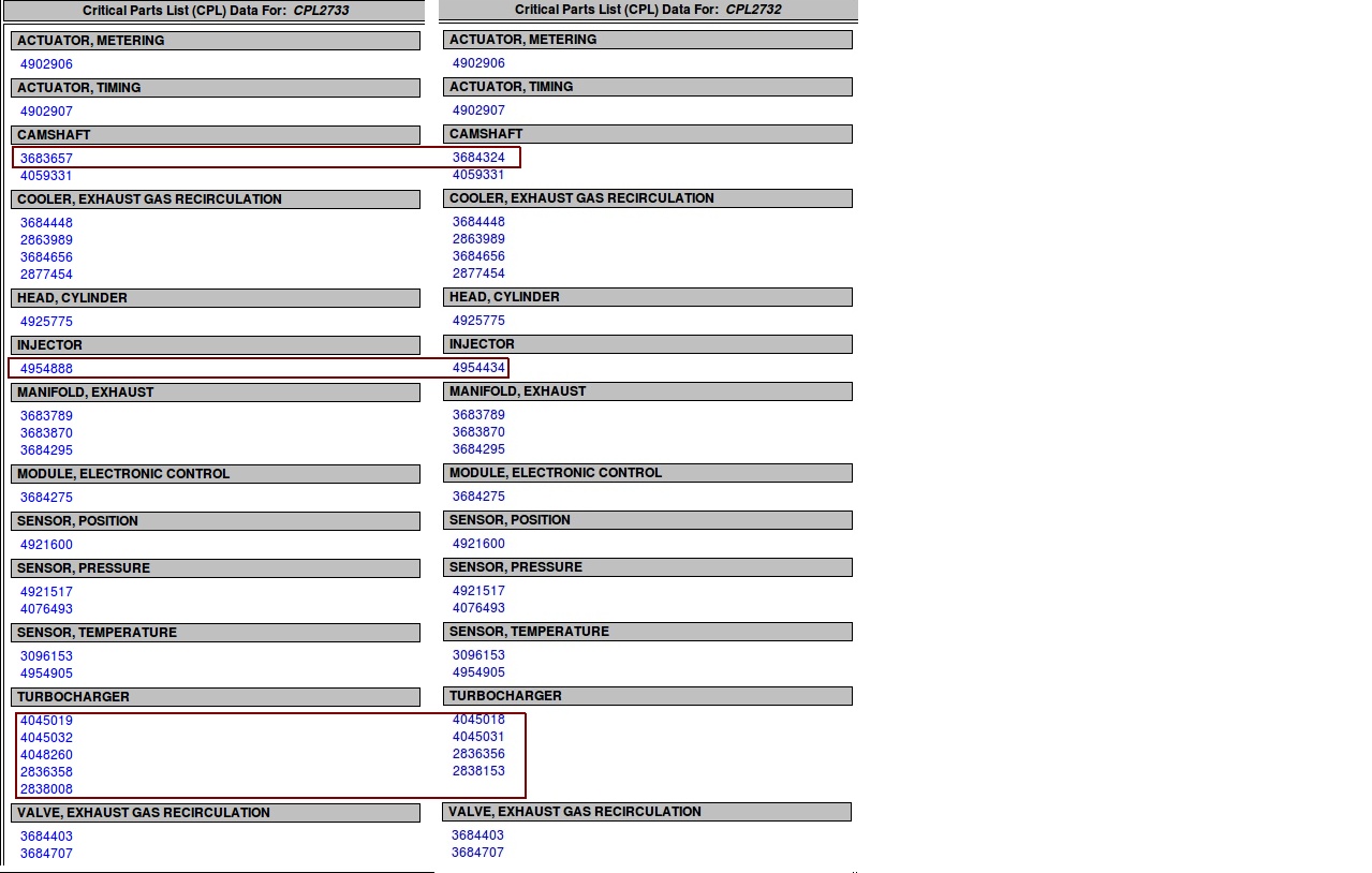

The programming is based on BOTH THE ENGINE AND THE TRUCK. Just because some of the internal parts are the same in different CPL engines, the CAC, exhaust, turbo, and a lot of other stuff IS NOT.
first of all,... they use different cams, different injectors, and different turbochargers...
./uploads/201902/post_2_1549223091_ffc634729fcadd42d341d1e152a44f53.jpg
They are NOT compatible, so the answer is NO,.. do not just use any old program with it. USE THE PROGRAM MADE FOR THE ENGINE, and then compare CAC, exhaust flow, and other settings so so that it can be matched to the truck make/model as well, de-mandated or not. Also for other reading/researching this,.. if you DO have EGR and DPF intact, those settings will also need to be inspected as well. Otherwise, you will only end up with a regen nightmare all the time.

Hey Rawze, I really appreciate that side by side pic. Another question for you. Would the engine serial numbers factor into the injectors matching? I gave the mechanic the serial number of a 2732 I’m considering and he said the injectors were the same for the 2733. The pic you sent says otherwise. Now I’m concerned. Who are the guys I should contact on these forums for proper programming?

Sounds like your mechanic is feeding ya bull. But yes the engine serial number is one way to lookup that engine build on quickserve. It would tell you the calibration, CPL and you'd be able to compare part numbers... Unilevers be able to help ya not sure who else does remote stuff on here anymore.
Edit: just reread what you were saying, the engine serial numbers would not change what Rawze already has compared, it is simply another way of getting that information

Yup like bazdan said your mechanic dont know what he's talking about, I guarantee you the injectors are different as well as eveything rawze listed, cams turbo pistons.

(02-04-2019 )Tmaj12k Wrote:  Hey Rawze, I really appreciate that side by side pic. Another question for you. Would the engine serial numbers factor into the injectors matching? I gave the mechanic the serial number of a 2732 I’m considering and he said the injectors were the same for the 2733. The pic you sent says otherwise. Now I’m concerned. Who are the guys I should contact on these forums for proper programming?
it is NOT just a simple variance of injector part#'s or superseding stuff ... My comments above are based on the fact that I took the 20-minutes + time to --- Looked in the programs for both and THEY ARE SIGNIFICANTLY DIFFERENT IN THEIR PROGRAMMING for everything including injectors, fuel offsets, CAC flow, exhaust flow, power curves, injection offstes, literally the 2 programs ARE DIFFERENT!.
post the ser# of the old engine, and then the new one. That way it can be looked up exactly, but I can tell you this... You can also determine this by looking at the listings in the link i posted about changing HP, and looking at the ecm dataplate*(s) and the AV# on each of them.
http://rawze.com/forums/showthread.php?tid=1&pid=1#pid1
