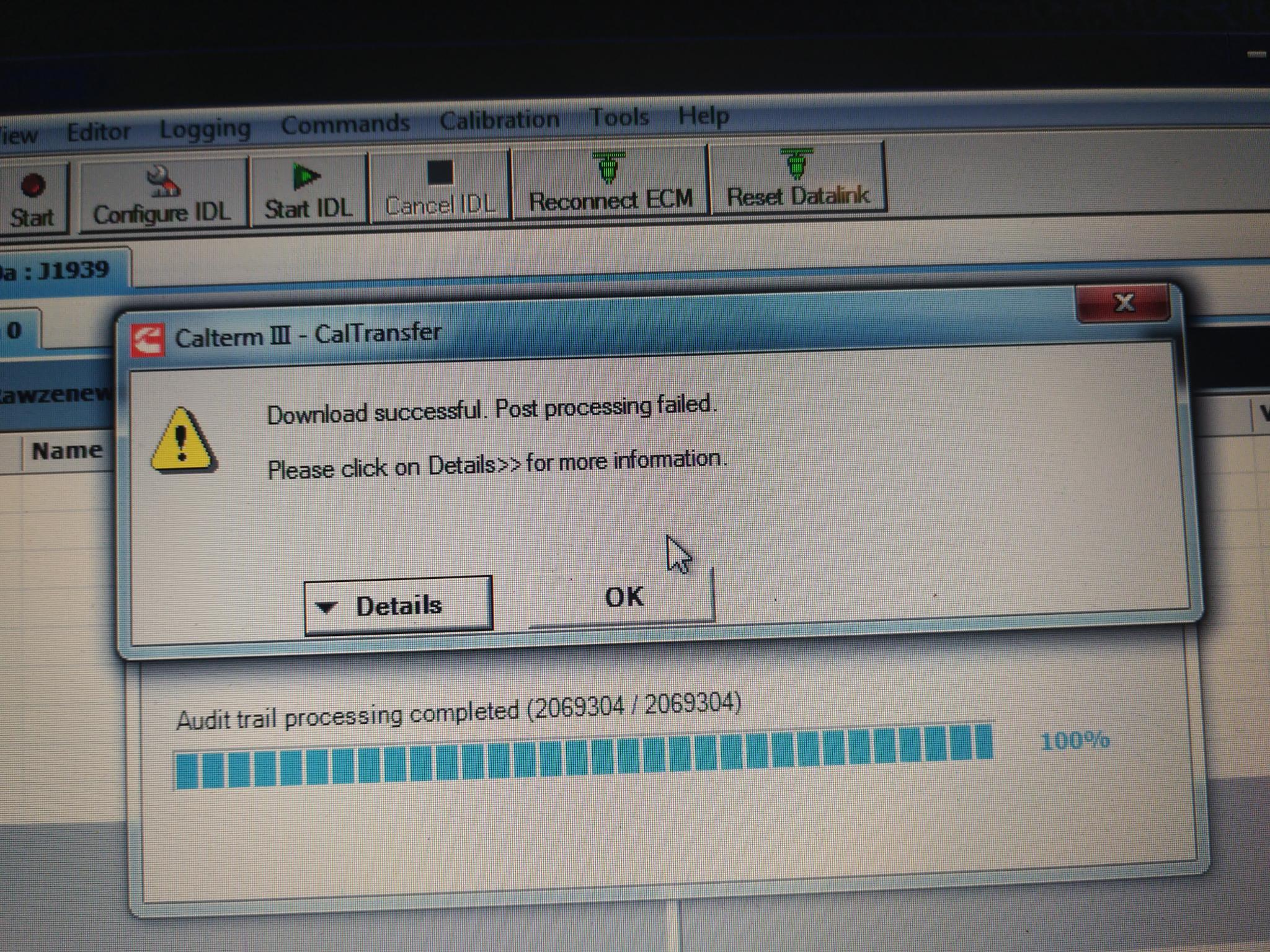

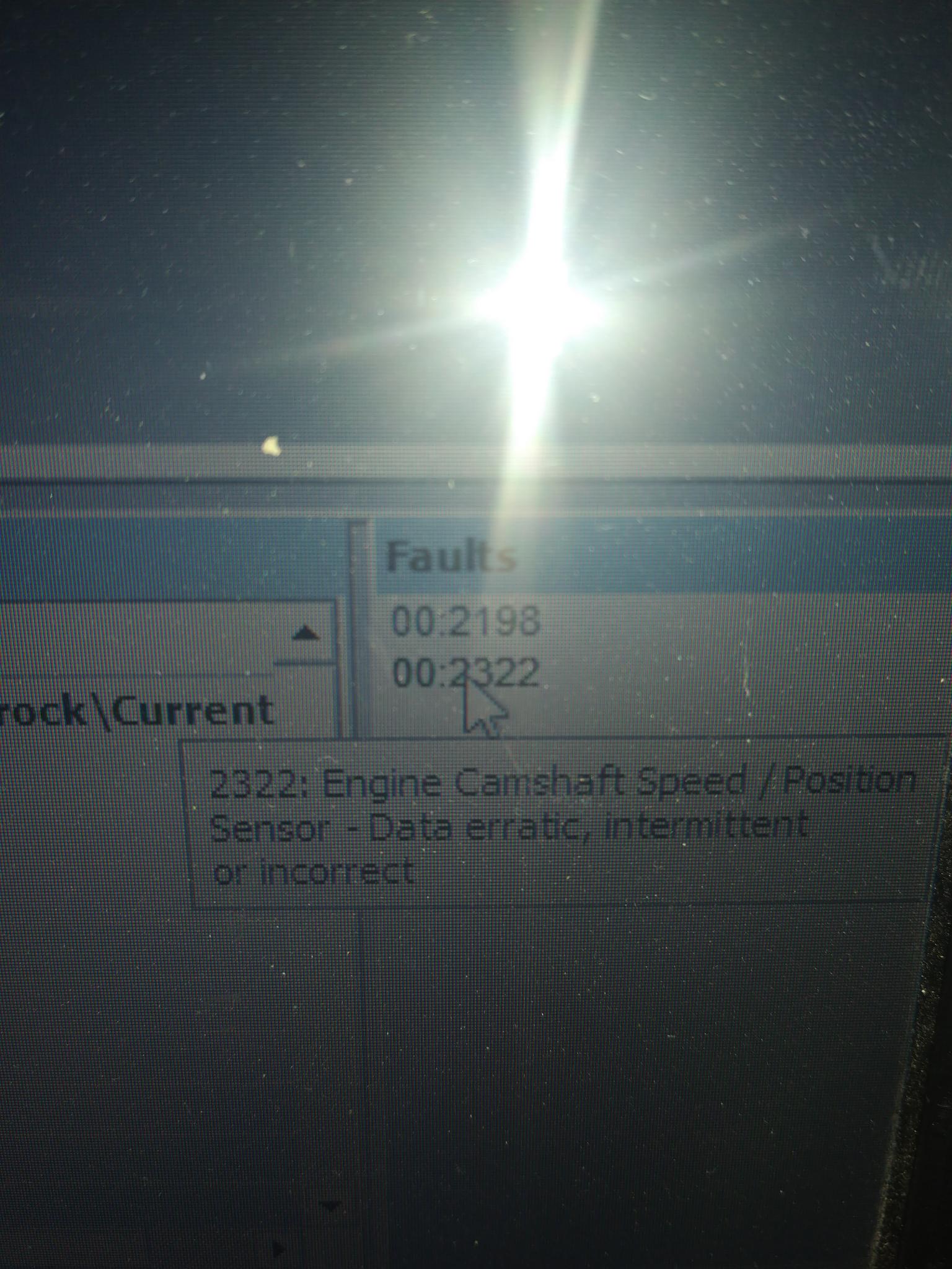

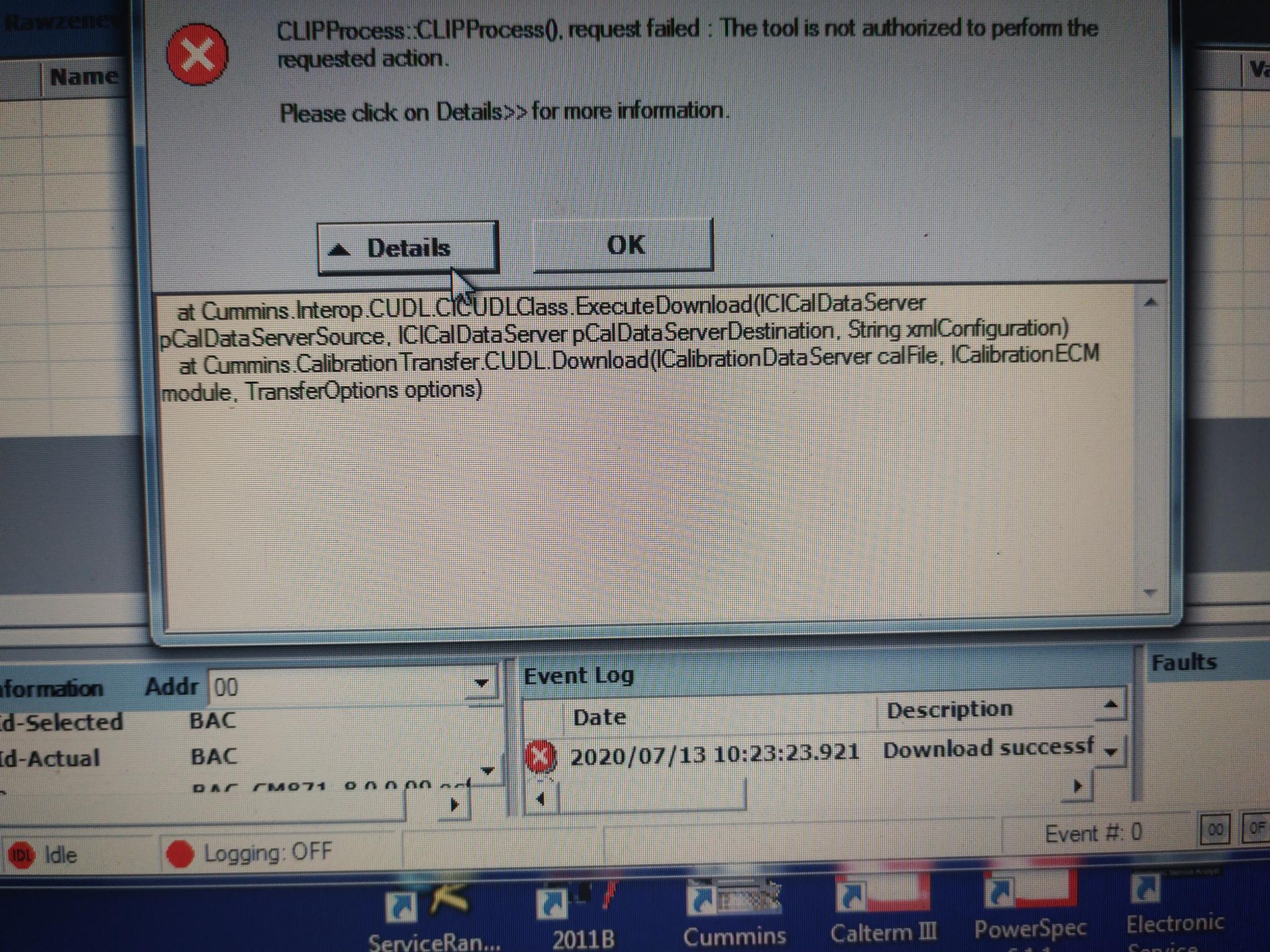

Running 38psi boost.
Got my cam, timing wedge and injector test kits on order right now, hoping to see them for days off then I'll be reading into this thing a bit.
I'll keep you posted with what I find.
I did notice when I was in Calterm these inactive codes so I'm fixin to check into this. That VG code seems to only pop up when I first upload to ECM, I've been having issues lately with a error code after uploading the cal to the ECM so I assumed it had something to do with that.
I'm assuming my dumb ass must have forgot to unlock the ECM before downloading one time so I'm going back to a earlier cal to try that.
Lots to do this set of days off.
