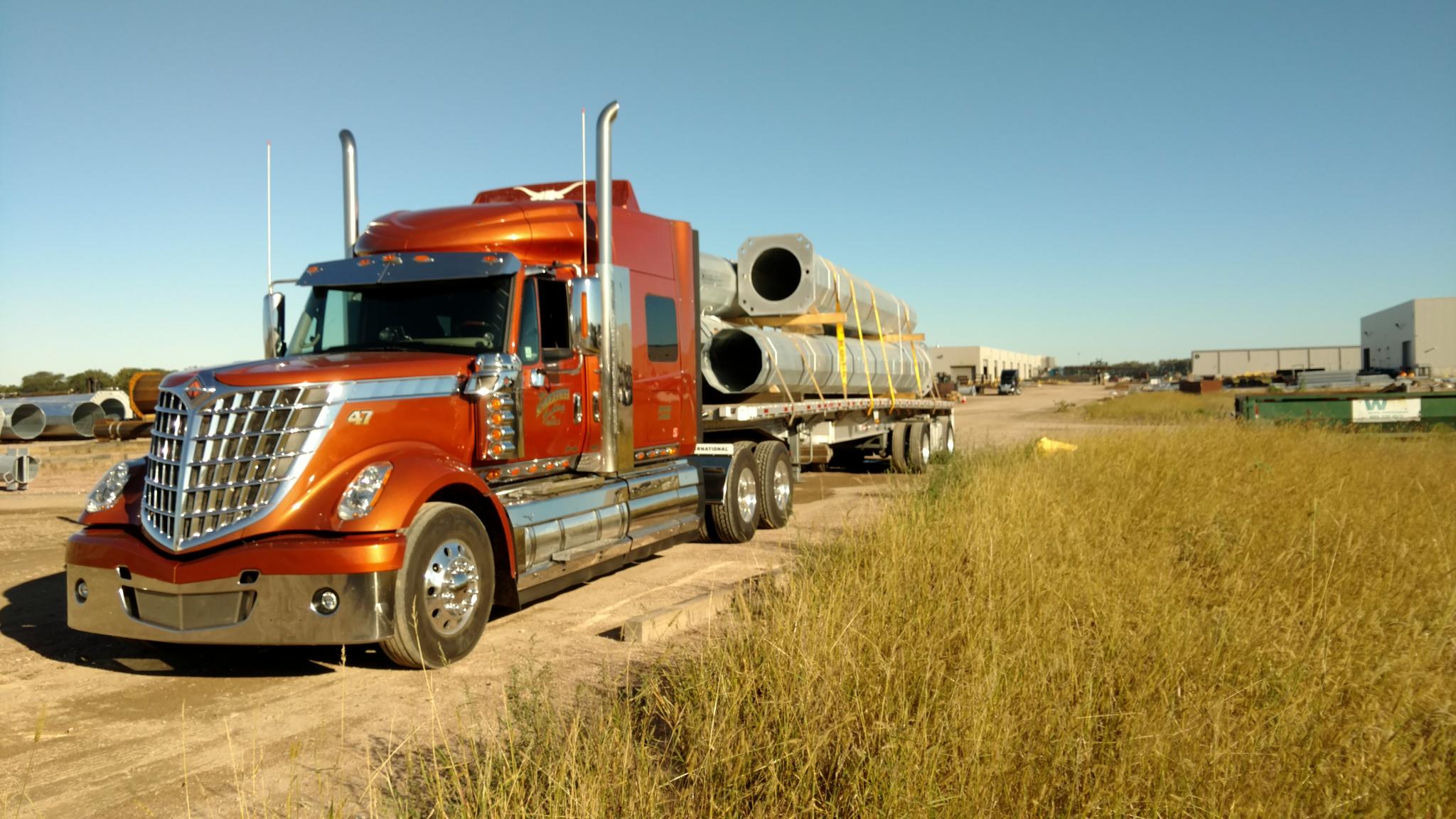

So recent was able to dig my data plate for my rears out of it's paint tomb. Found dealership advertising of 3.55s was wrong. I have 3.36s and 65-67mph is around 1300 rpm and around 70 is 1400ish. I would say my loaded miles is 95% at 70k to 80k lbs flatbed with about 32000=empty weight at 1/2 tanks.
So question is what might a better gear be for my cm871 13sp. With 500hp mm tune. My cruise speed is 65-67mph when loaded and at 80k she feels like a snail getting there and almost any incline or breeze makes her want to go-to 30+ lbs of boost loaded. Winter fuel average is 4mpg.
