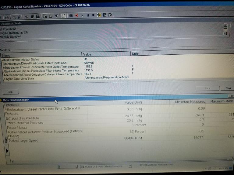

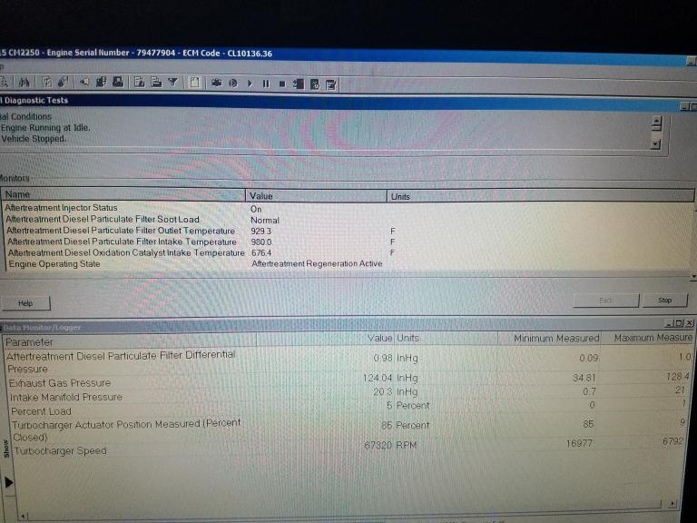

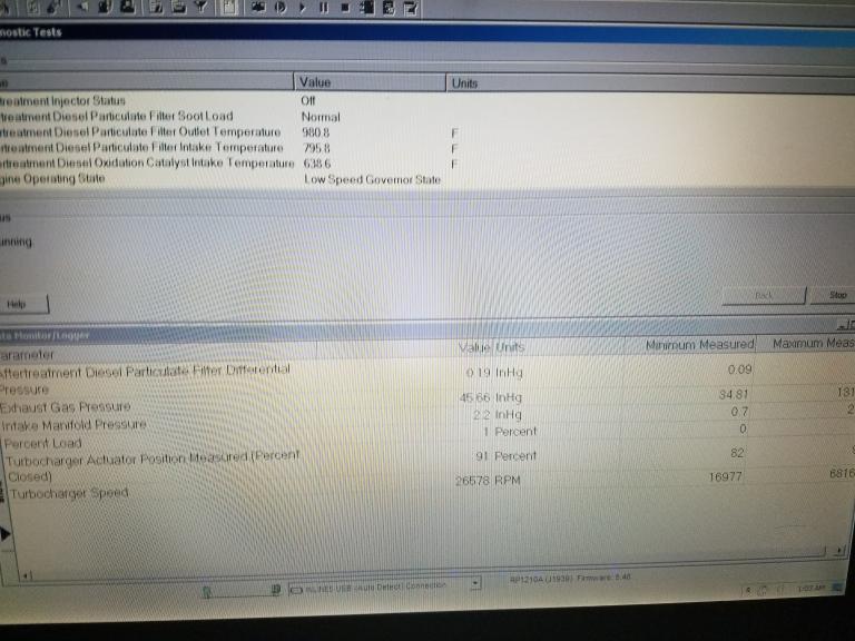

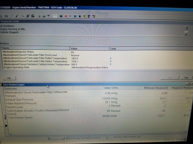

| Forced Regen Results Got a chance to mess with Insite a little more tonight after my 11hrs. Followed along with Rawze's forced regen video and wanted to get some input on my results. Hope these turn out well. I took a pic of the screen with my phone. I'm going to have to install a screen capture program or remember to "print screen" next time. Started regen at 11:52 Completed at 1:02 10Min ![]() 20Min ![]() 30Min ![]() Complete User's Signature: 2012 Cascadia ISX15 CM2250 | |||

| RE: Forced Regen Results Looks to me like it did its thing. User's Signature: ->: What I post is just my own thoughts and Opinions! --- I AM Full Of S__T!. | |||

RE: Forced Regen Results (05-13-2016 )Rawze Wrote: Looks to me like it did its thing. Good deal. Wanted to post up and see if there were any abnormalities, since this was my first time at it. All in all, things went pretty close to how it did in the video. I'm sure there will be some variations between the 871 and a 2250. Have yet to do a complete EGR tune-up, so it'll be interesting to compare the differences. User's Signature: 2012 Cascadia ISX15 CM2250 | |||

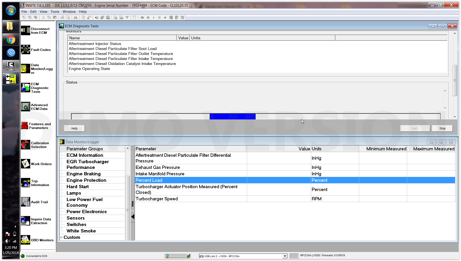

| RE: Forced Regen Results In the process of doing a forced regen and i cant seem to get any values. Set up my windows like rawze did and no values anywhere. What am i doing wrong? User's Signature: If it ain't broke, don't mean it won't be at some point. | |||

RE: Forced Regen Results (01-25-2018 )iceman Wrote: In the process of doing a forced regen and i cant seem to get any values. Set up my windows like rawze did and no values anywhere. What am i doing wrong? Looks like you forgot to highlight the parameter monitoring sub-window and hit the play |> button at the top. User's Signature: ->: What I post is just my own thoughts and Opinions! --- I AM Full Of S__T!. | |||

RE: Forced Regen Results (01-25-2018 )Rawze Wrote:(01-25-2018 )iceman Wrote: In the process of doing a forced regen and i cant seem to get any values. Set up my windows like rawze did and no values anywhere. What am i doing wrong? Tried everything. Highlighted all of them and pressed play, still no dice. I did discover i can do graphical monitoring and get the values. I am starting to get suspicions that my computer display properties are somehow not showing those values in either the data logger nor the aftertreatment window. Not really sure how to fix that though. --- Just an update on this and for information in case someone runs across it. It seems i have to run the program as administrator to get the graphics to operate properly. I could not get any values to show up on any of the tests under ECM diagnostic tests, nor in the data monitor and logger, until i ran the program as an administrator. This can be permanently mitigated by right clicking on the program, going to properties-compatibility, and checking the box: run as administrator. User's Signature: If it ain't broke, don't mean it won't be at some point. | |||
