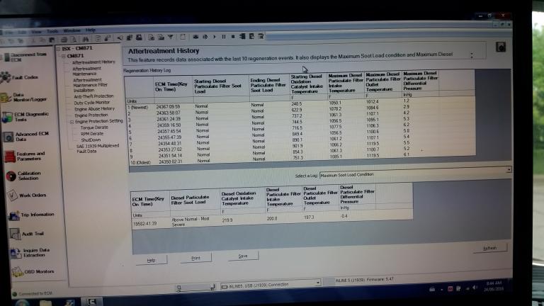

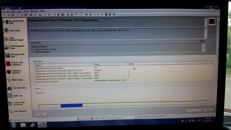

Got the laptop up and running and did my first forced regen. checked my history and it's still regenning every couple hours, my numbers are still horrible.
Have 91 counts for the turbo actuator ao I am going ro take it off and try and calibrate it tomorrow. I am hoping that will fix the constant regen as I cannot find aNY exhaust leaks anywhere (fixed 1 at doser since last forced regen)
This forced regen took 35 minutes total.
Only other things I can think of.... when I did the egr tuneup, I did not take of the small metal line at the exhaust back pressure sensor and clean it out..... Thats the only step I didn't follow.
Gonna check my cac for leaks as well.
Let me know if you have any other ideas.... and let me know if you know of a way to test the vgt actuator without removing..
