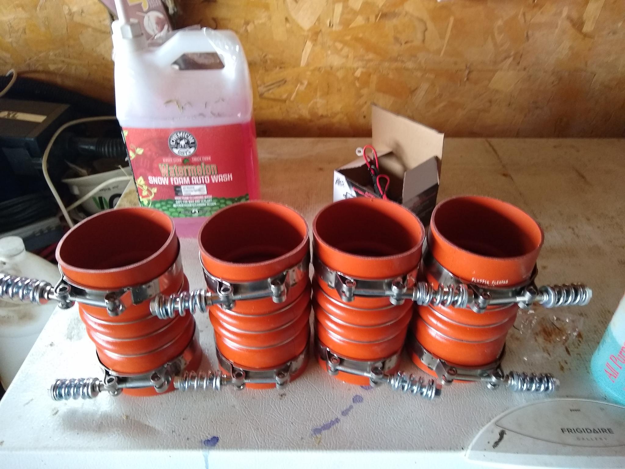

Got my new boots and clamps from 4states. Best fit clamps and flexfab boots. $153 to my door. Better than international they were over $200 just for boots and no clamps.

I hope those fit. I know you have the LoneStar, but on my ProStar the aftermarket boots do not fit properly. The International boots have two metal rings vs the aftermarket three rings, which throws things off. I have tried several times with different boots. Only the $$$$ OEM boots from International allow me to line everything up properly. I buy the clamps at FleetPride or Amazon if time allows.

same with mine. I swore next time I need to replace the boost on mine, I am going to shorten the pipe in its middle somewhere and weld it back together so that the std one's fit.
