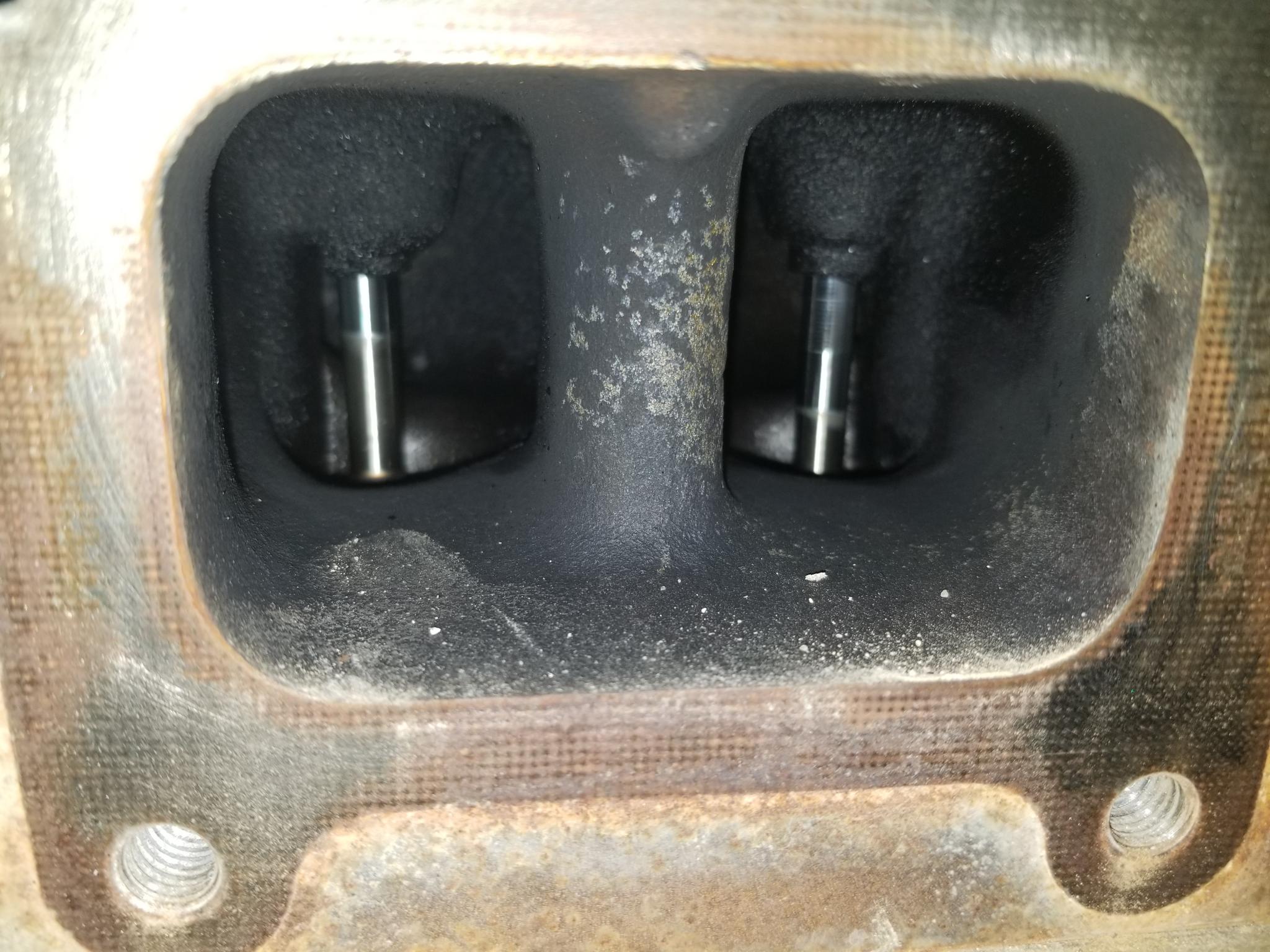

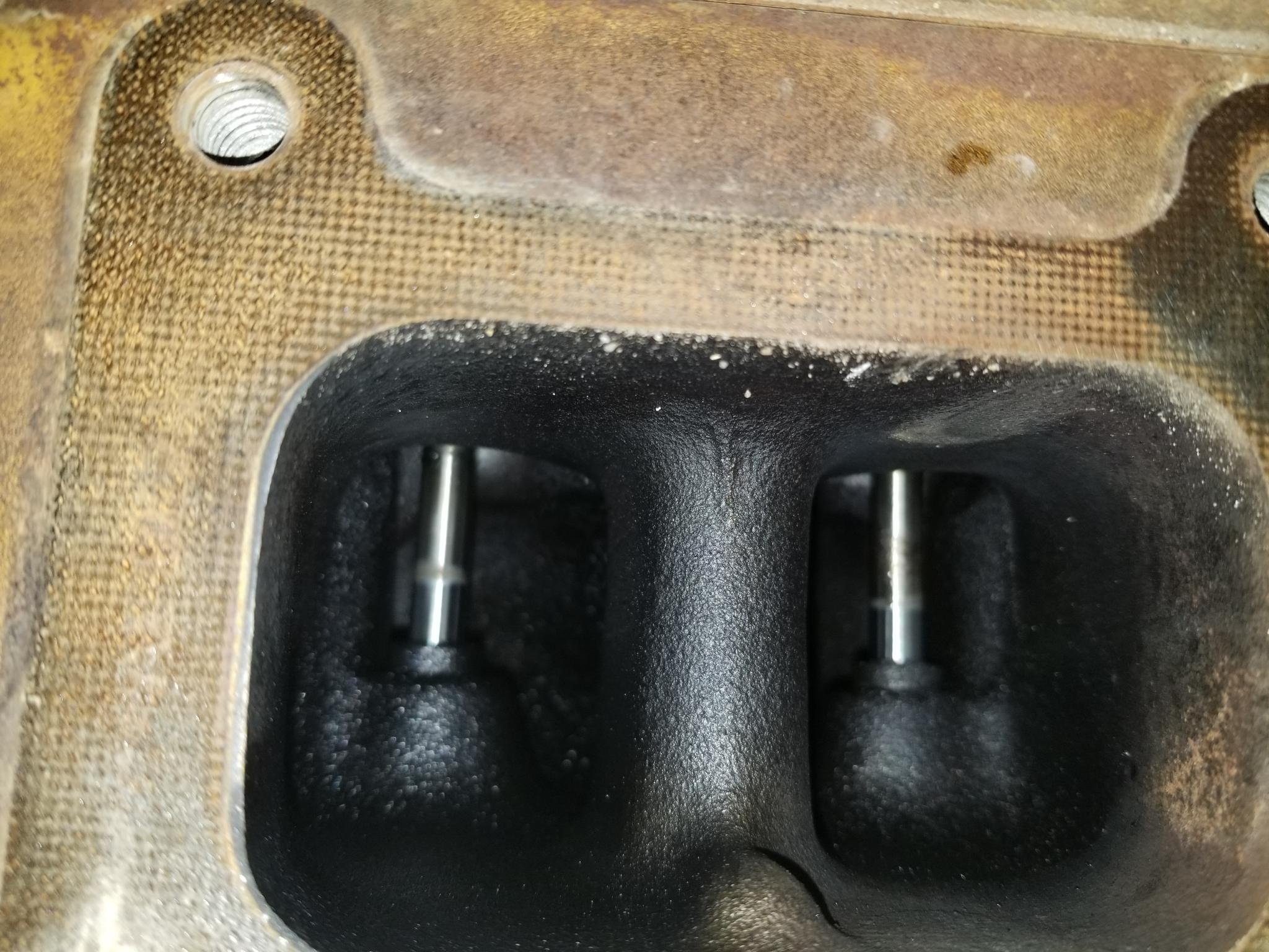

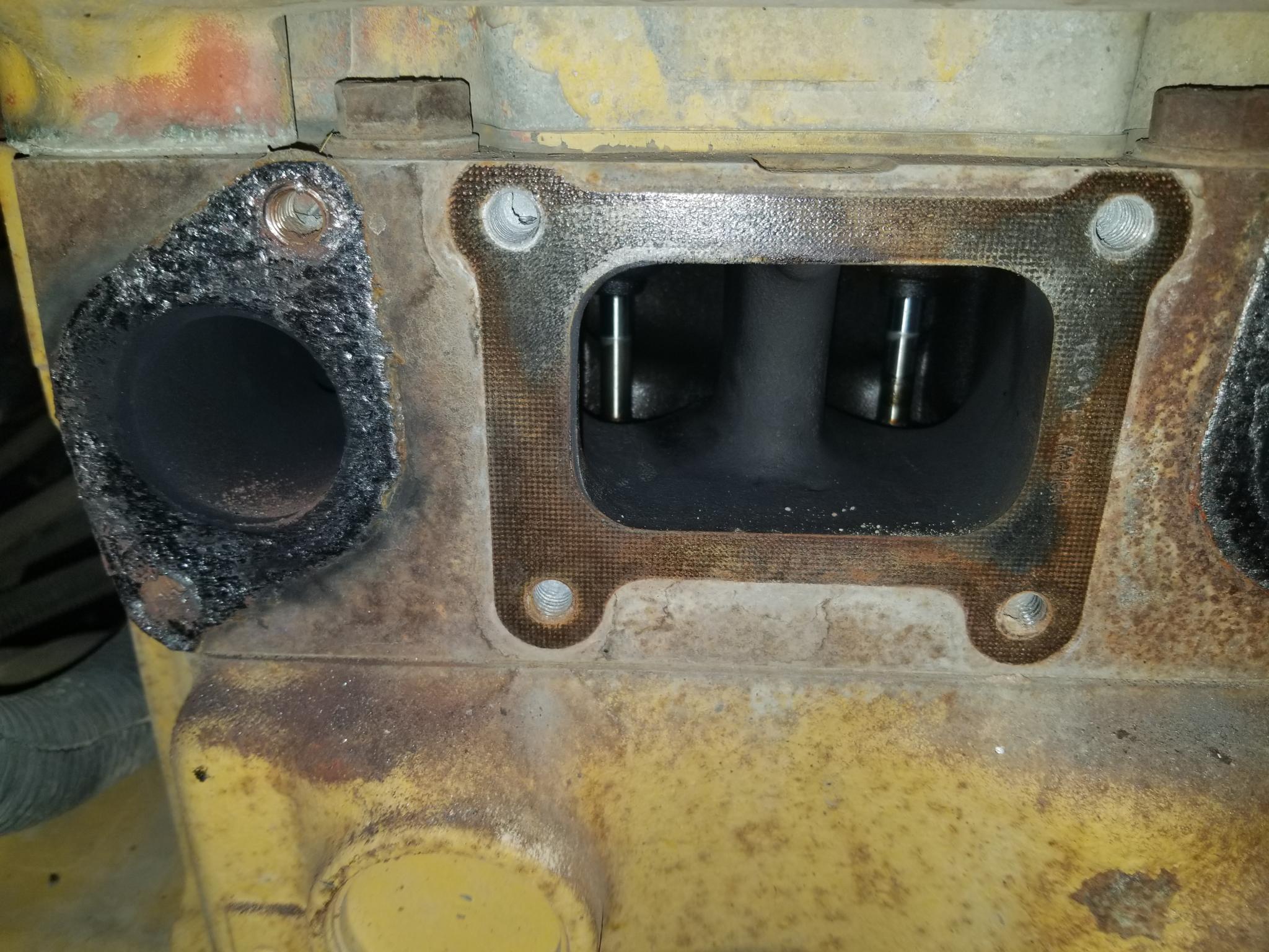

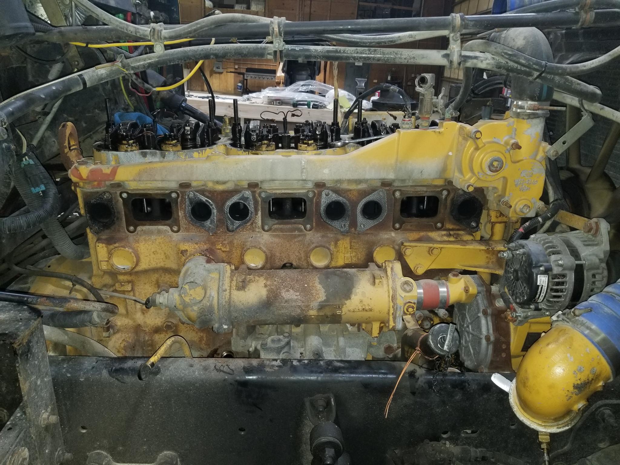

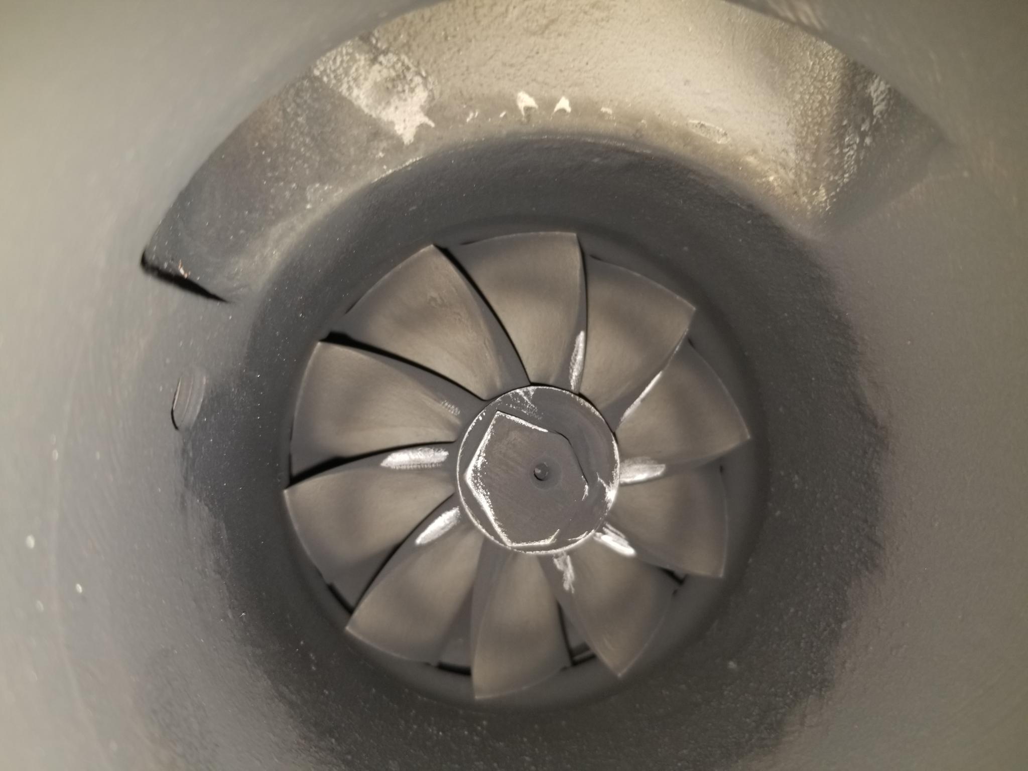

Here is a few pics of turbo and intake ports.

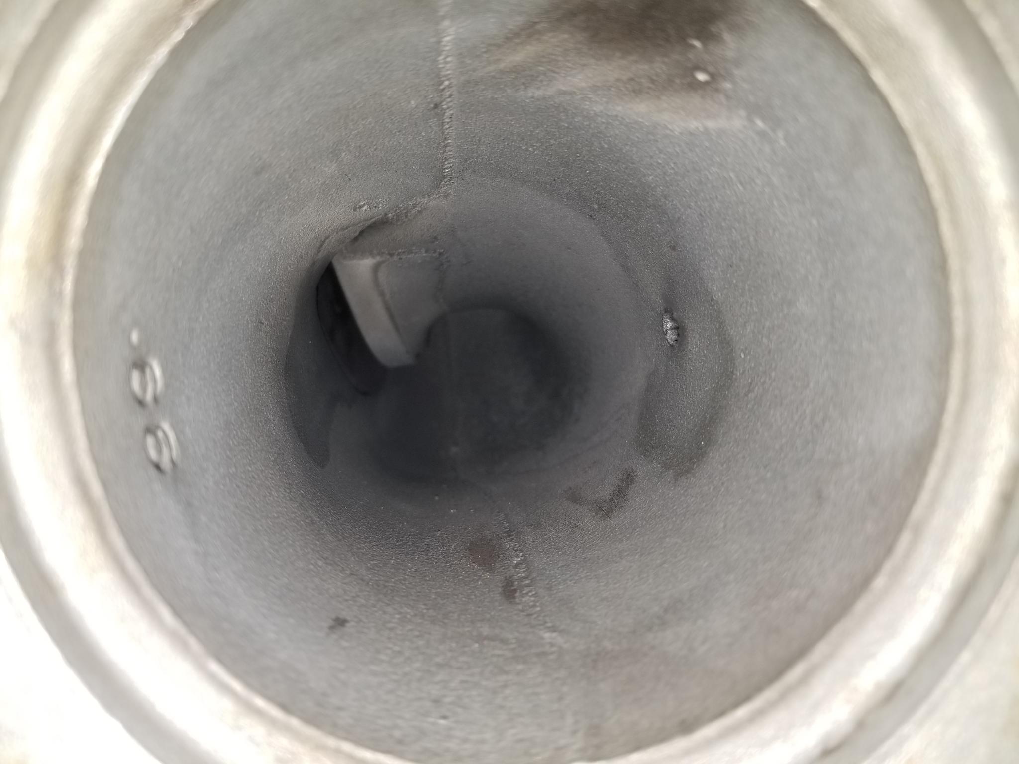

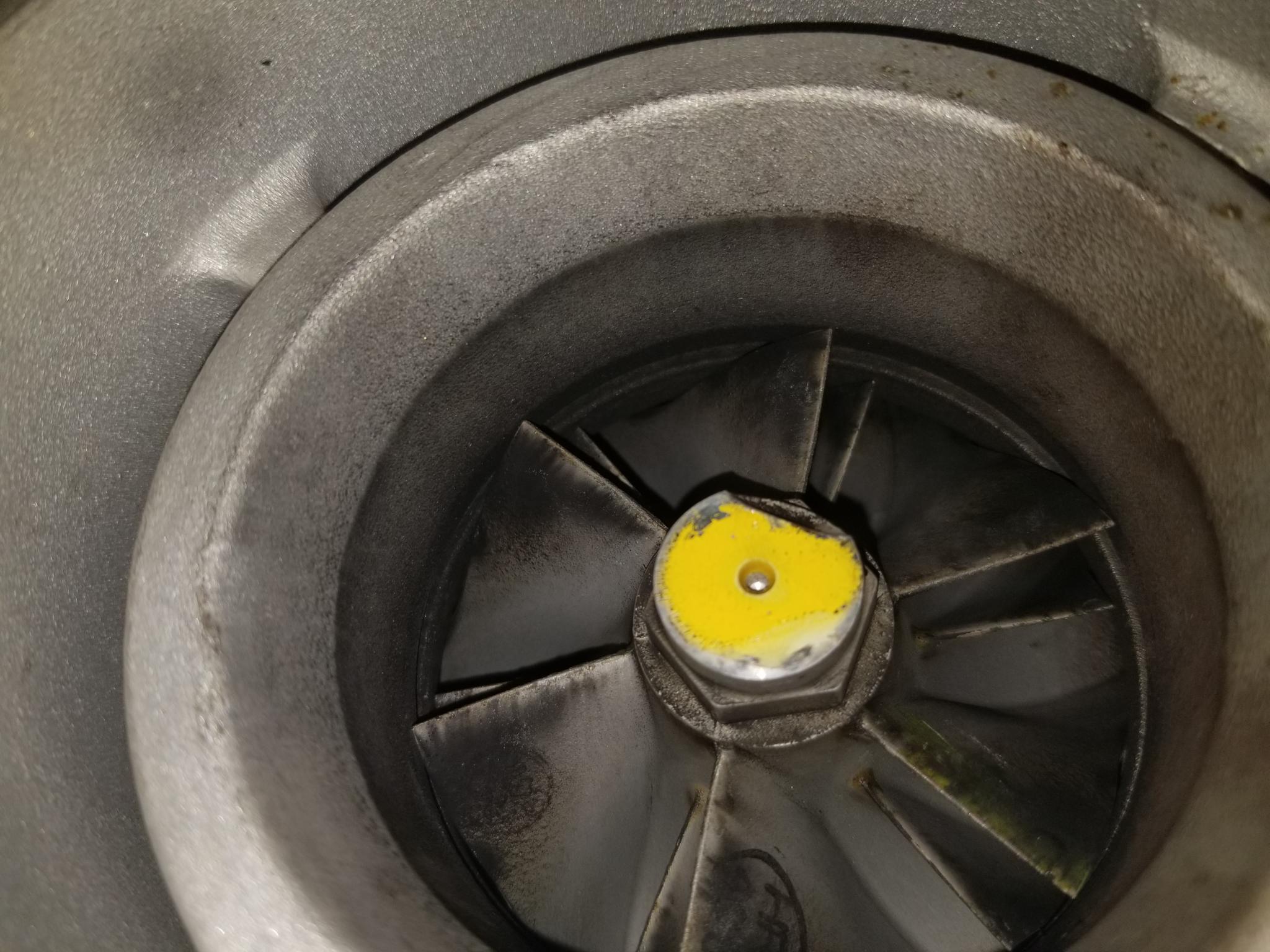

Few more

Looks like turbos been sucking a small amount of dust starting to erode the edge of blades make sure whens shes back together that all the intake piping is sealed up tight and using a good air filter. if in very dusty enviroment might try a prefilter on the air filter to.

ya its been dusted for sure. you can see the eroded edges on the turbo.

I got everything off but the head. I ran out of beer But all I have is a ground cable, the 2 front bolts that go into head and the head bolts and she should come off. I looked through the top with a light and number 1 and number 6 is up and you can see it. It's either a casting line or a crack. I can't tell but there is Def a line of some sort.

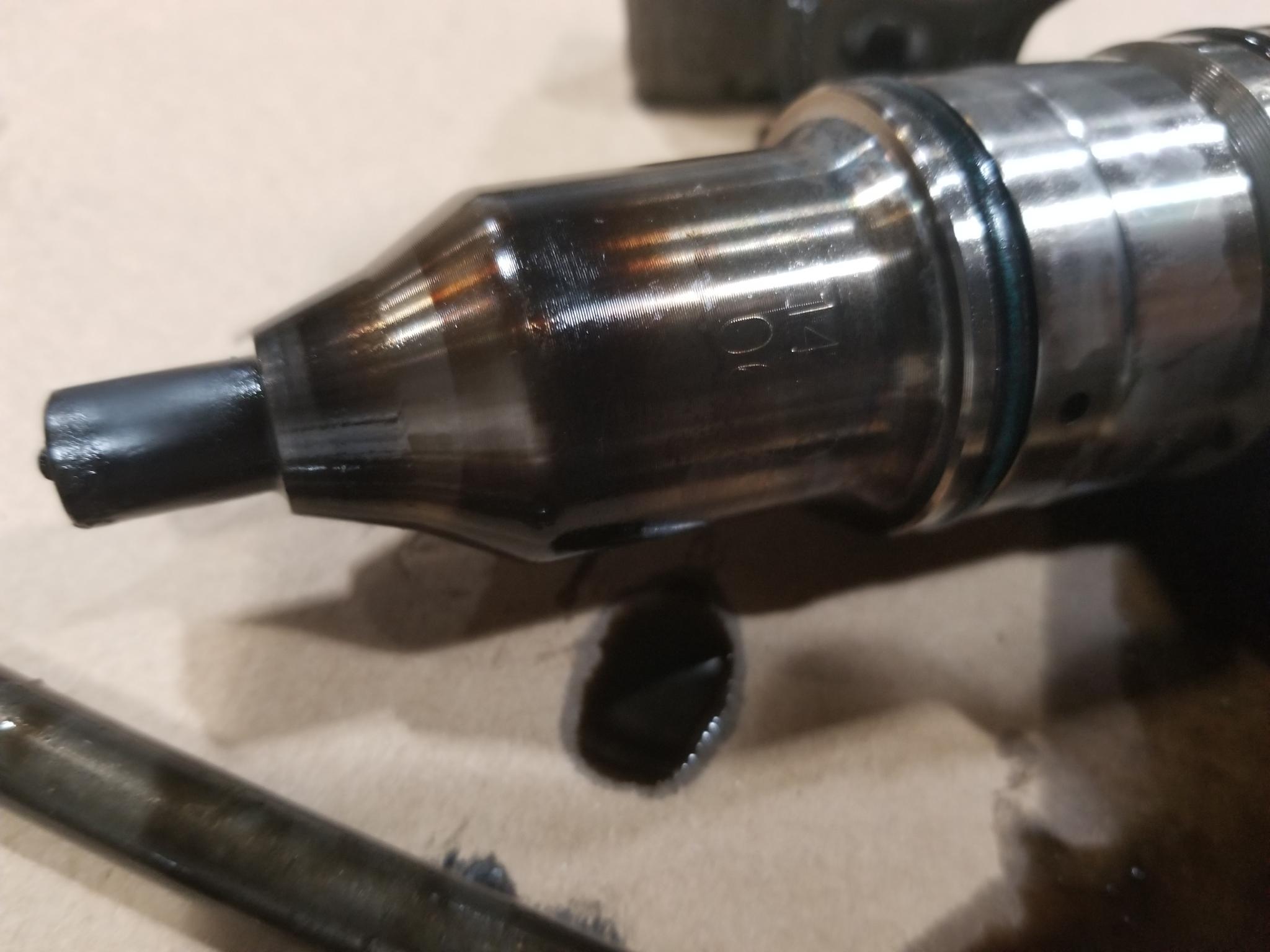

All the injectors looked good, except for the last 2. They had a burnt ring almost all the way to the o ring were the fuel is? Those were going by were they seat.
And one of the intake valve stems looked like it was higher that the others on cyl 5.
Ill know more when I take head off tomm.
