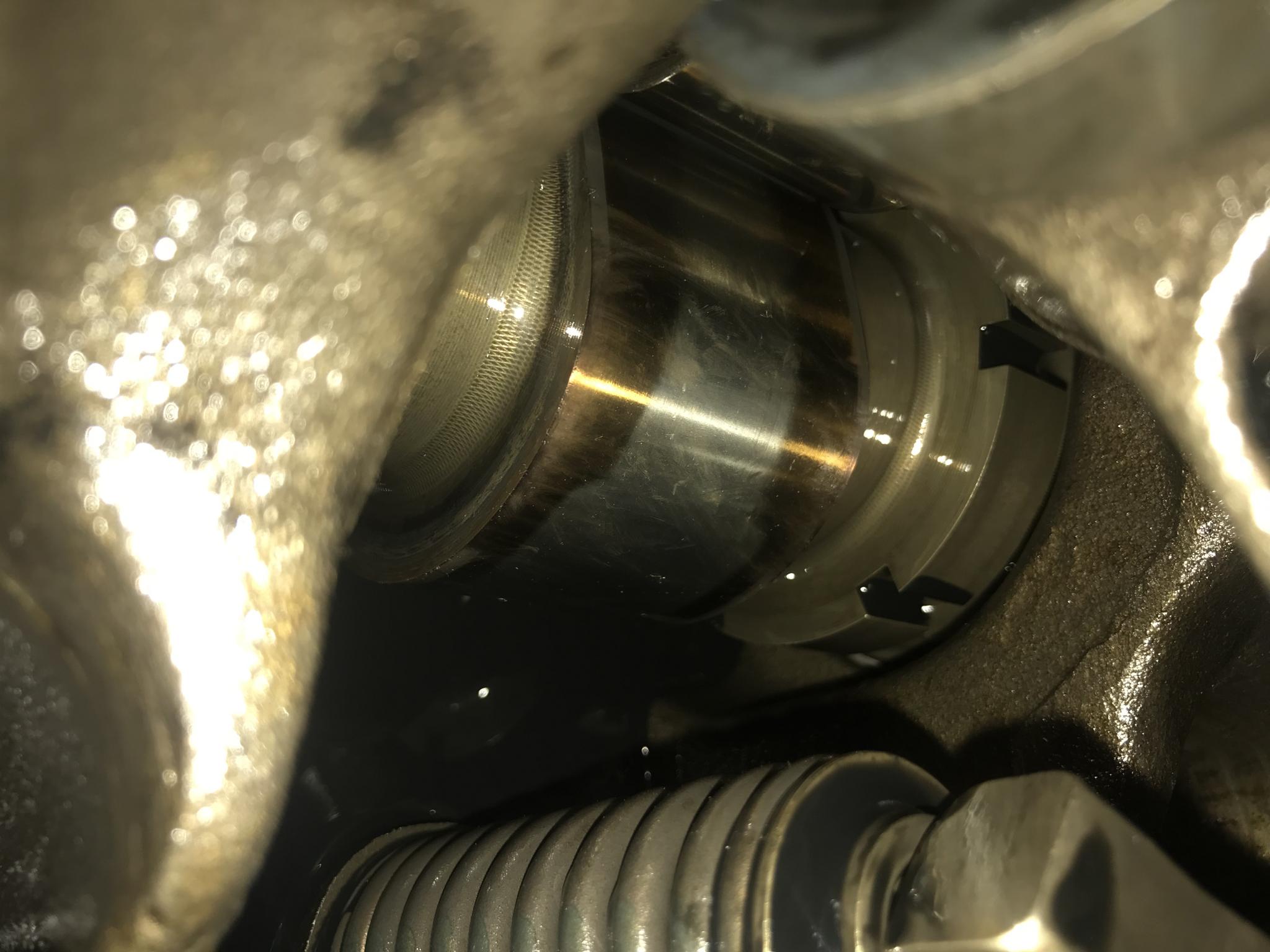

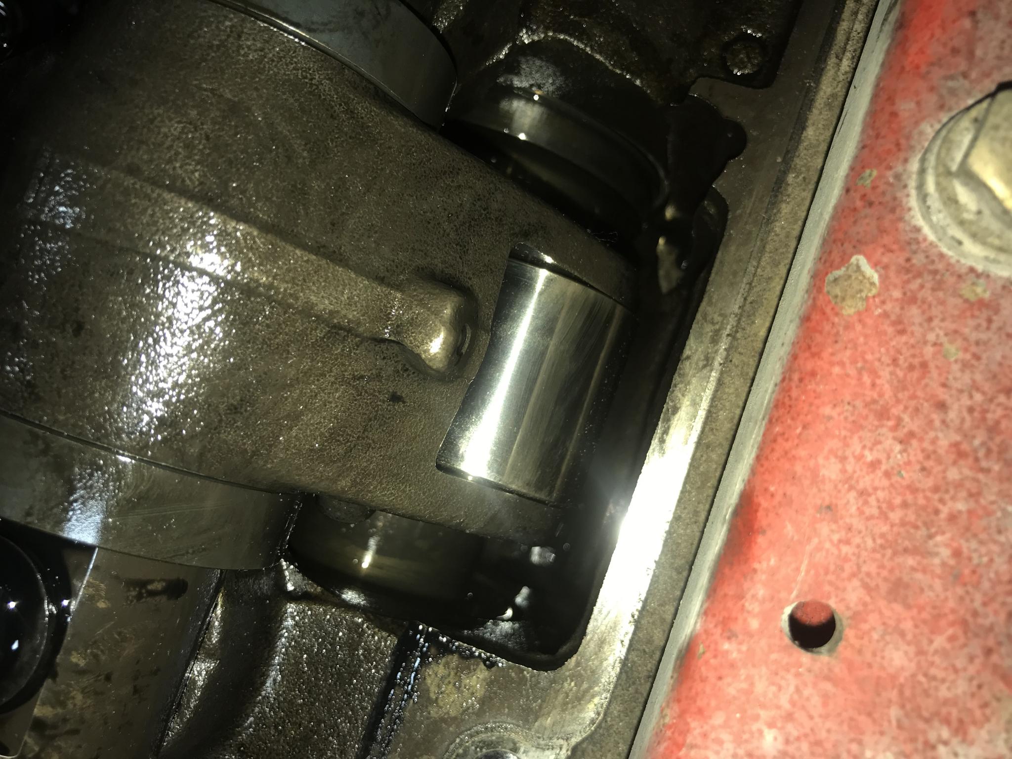

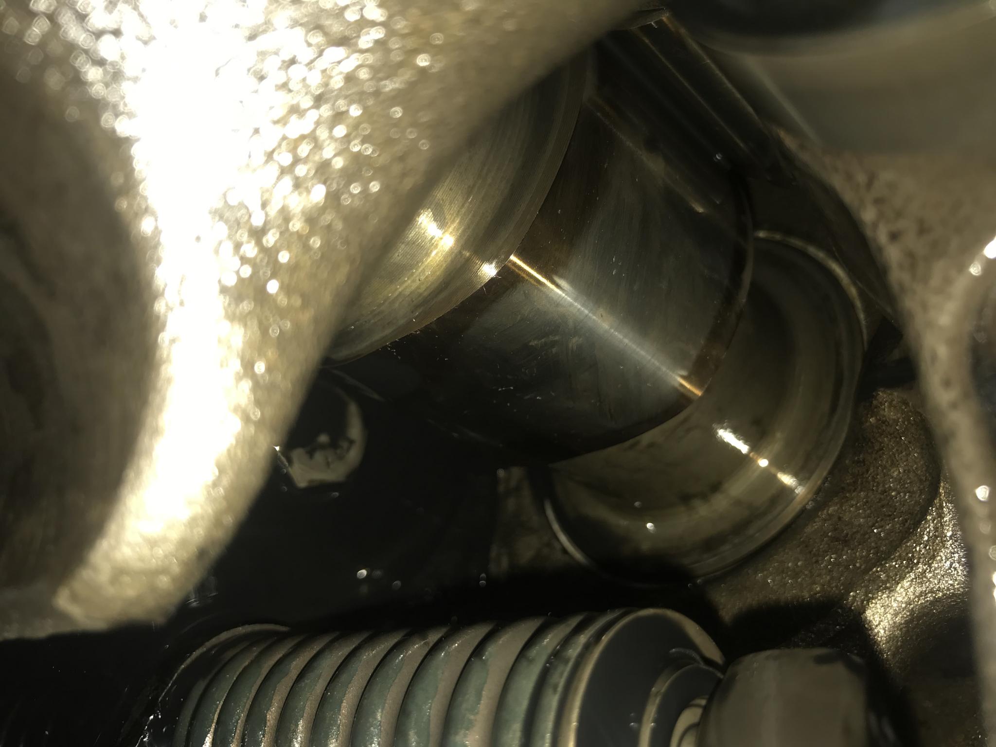

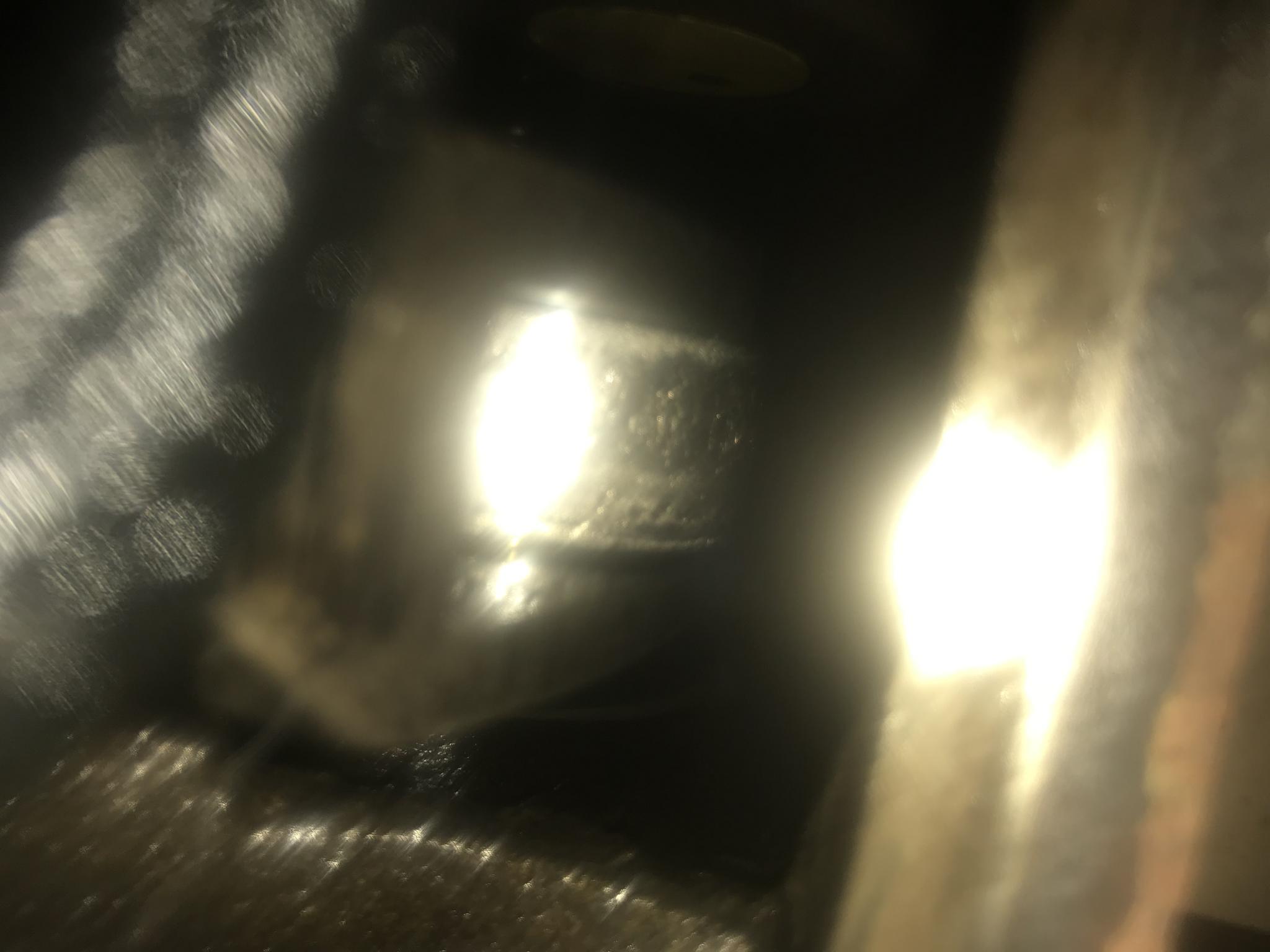

               Was hoping someone could tell me how worn things are
User's Signature: 2010 kenworth t800 isx500hp cm871 13spd 3.55ratio
04-12-2019, (Subject: Cam help )
RE: Cam help
       that’s only thin I saw that was chewed up on #4 exhaust side number two was also starting to do the same thing
Just like to know how bad it is thanks. Planning on inframe soon

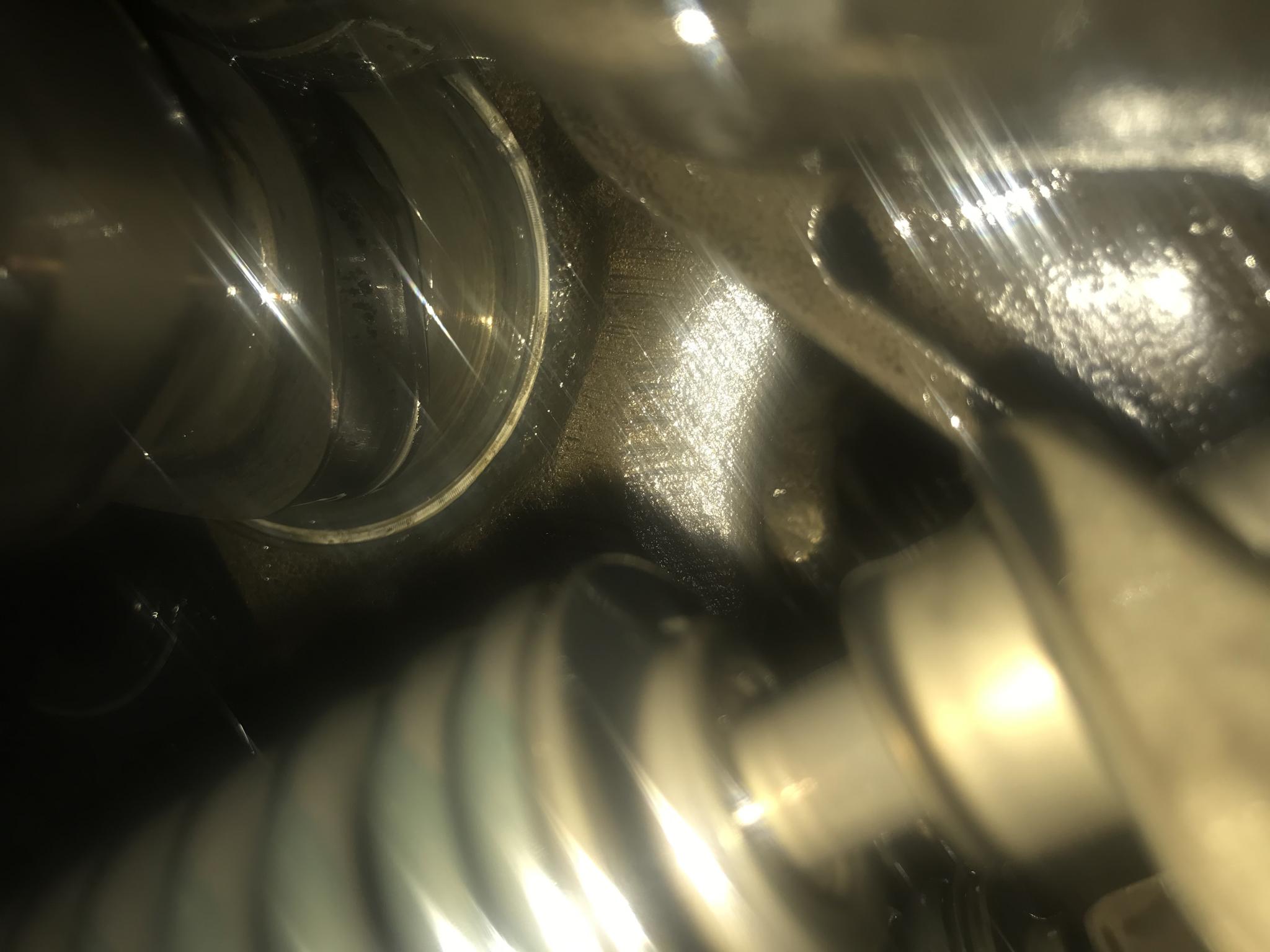

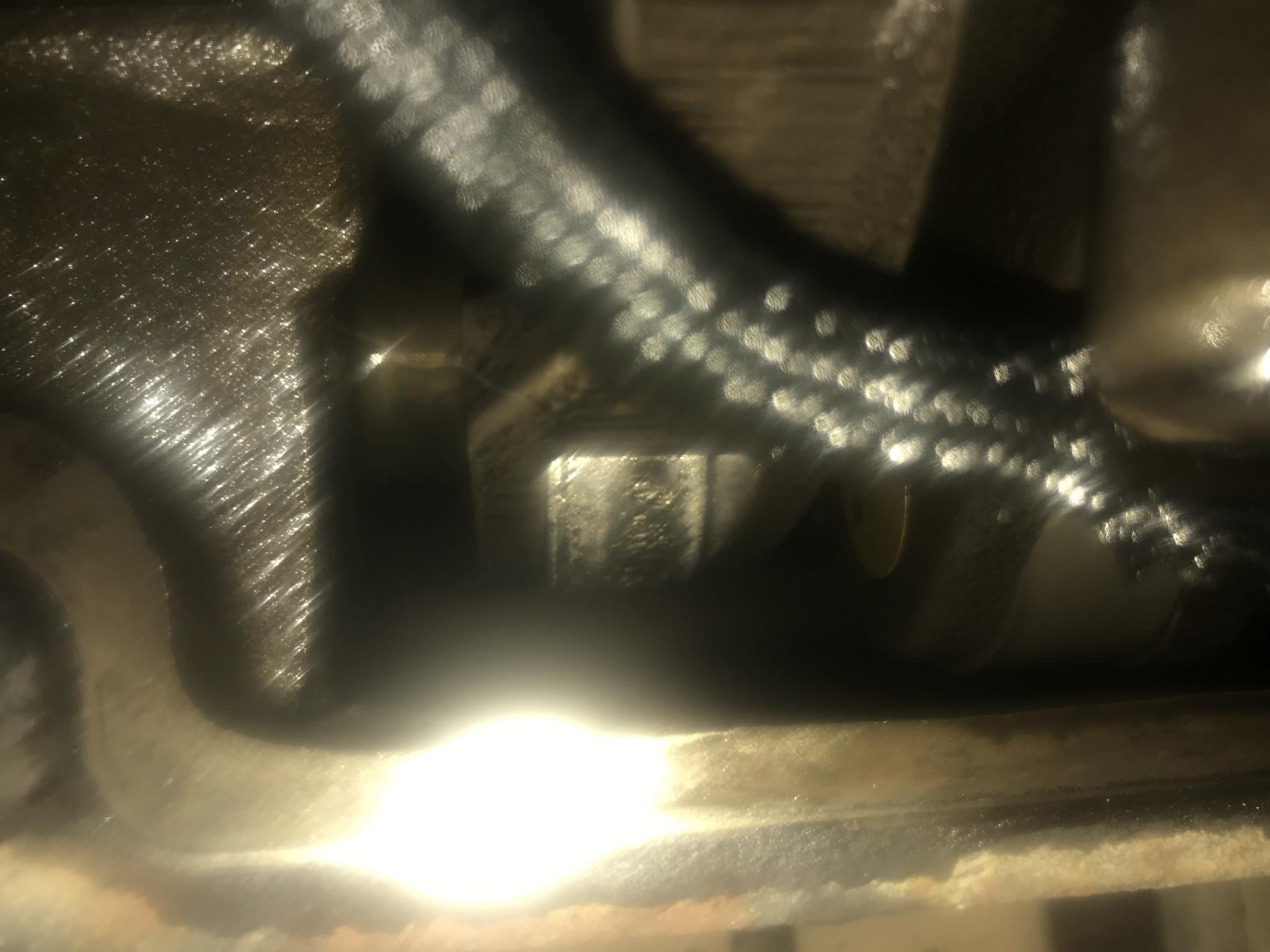

Also the Jake wire thing flops around a lot connections are fine but that whole thing flops around not sure if that’s normal is wearing in one spot right by that bad roller too

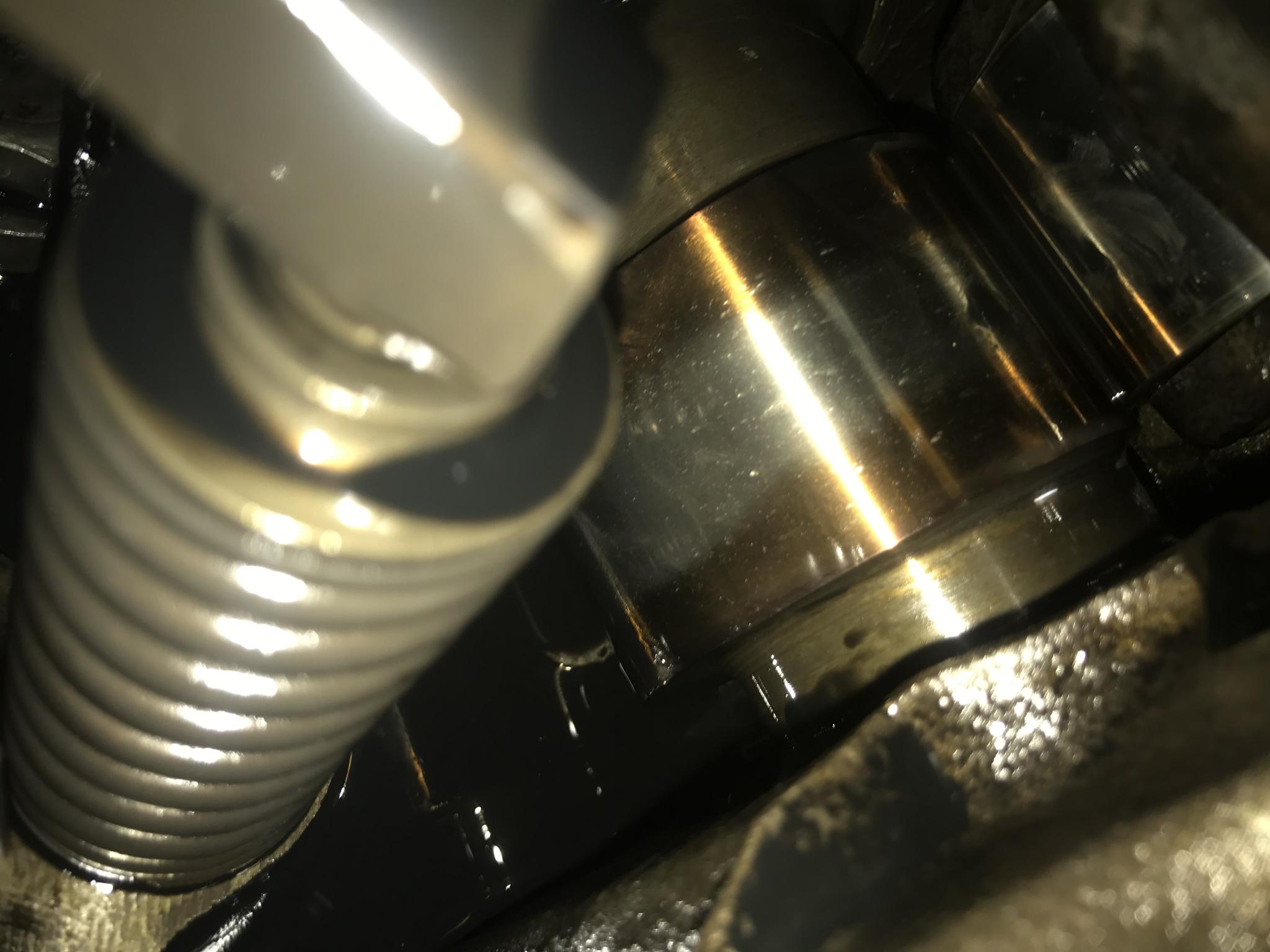

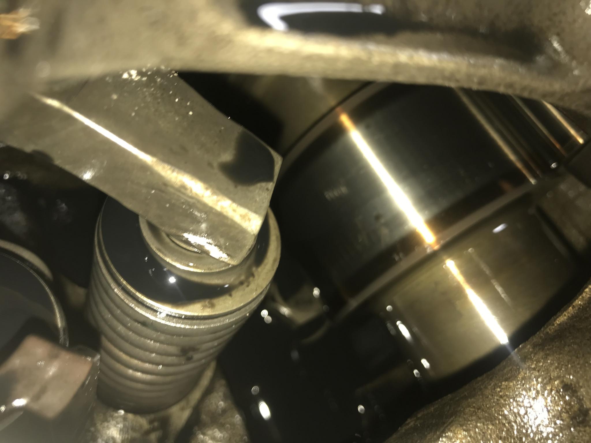

   I did find some wear on the valve shaft as well if you zoom in on it you can see it I believe it’s cylinder 5. I’m guessing cam is toast then and I should just inframe it now?

the cam is torched, you cannot run it it needs to be replaced.
