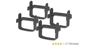

I have a new set of OEM front springs. The old set was X'ing up front pretty badly, and from what I understand, is an OOS condition.
Are there brackets or anything of the sort that go around the front springs that would prevent this condition from happening? Im sure I could Fab up something, but front springs are something Id rather not play with.

usualy something like this.
usualy thebottom part is rivited into the bottom leaf spring then u put on top and fold over the lips to hold in place.
