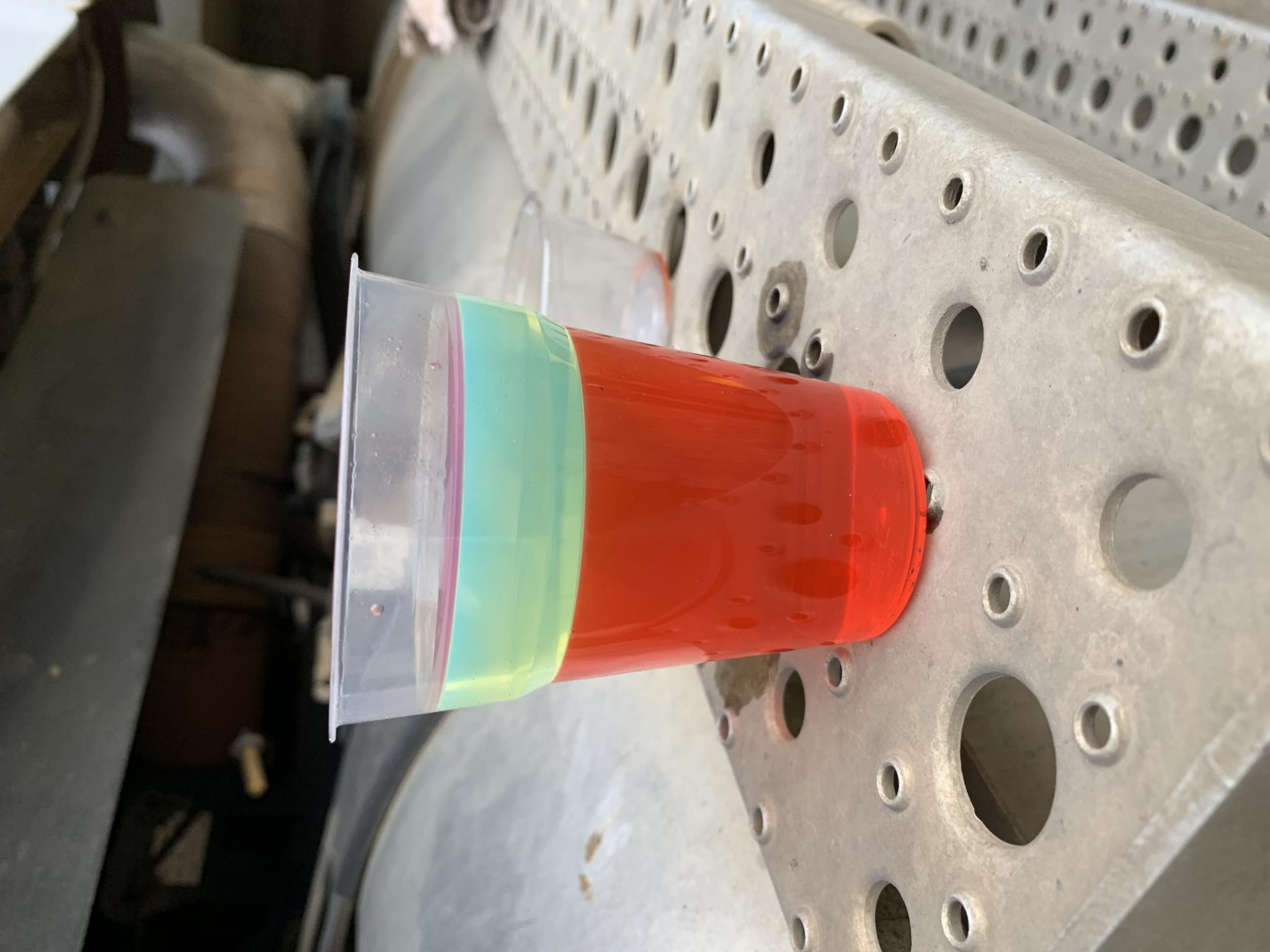

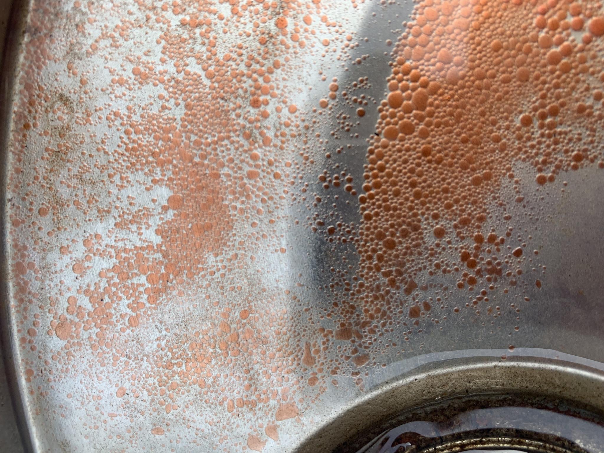

      Guys have a Freightliner century with a C15 6nz, today my brother and I were doing a service and found the fuel filter and separator full of coolant! What can it be and where should I start?

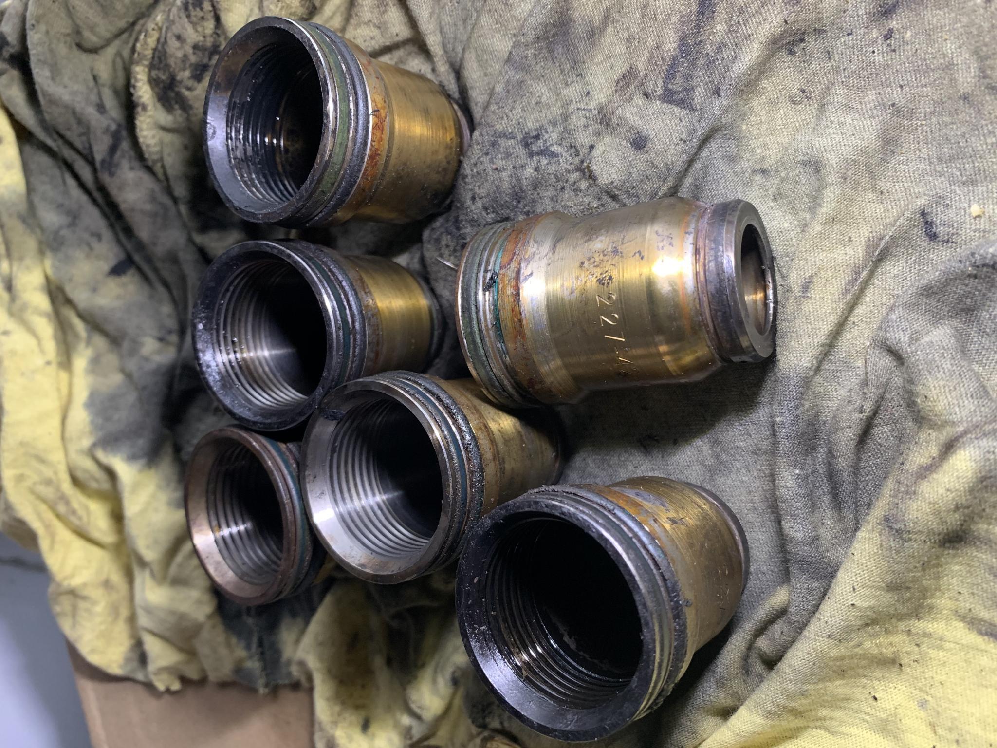

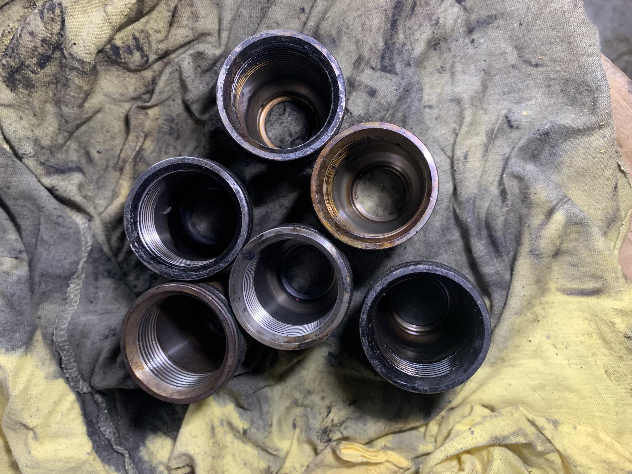

      Thought I’ll post some pics of the injector cups:
You can see one of the orings perished and also had to change all the injector seals too, few of them were gone.
