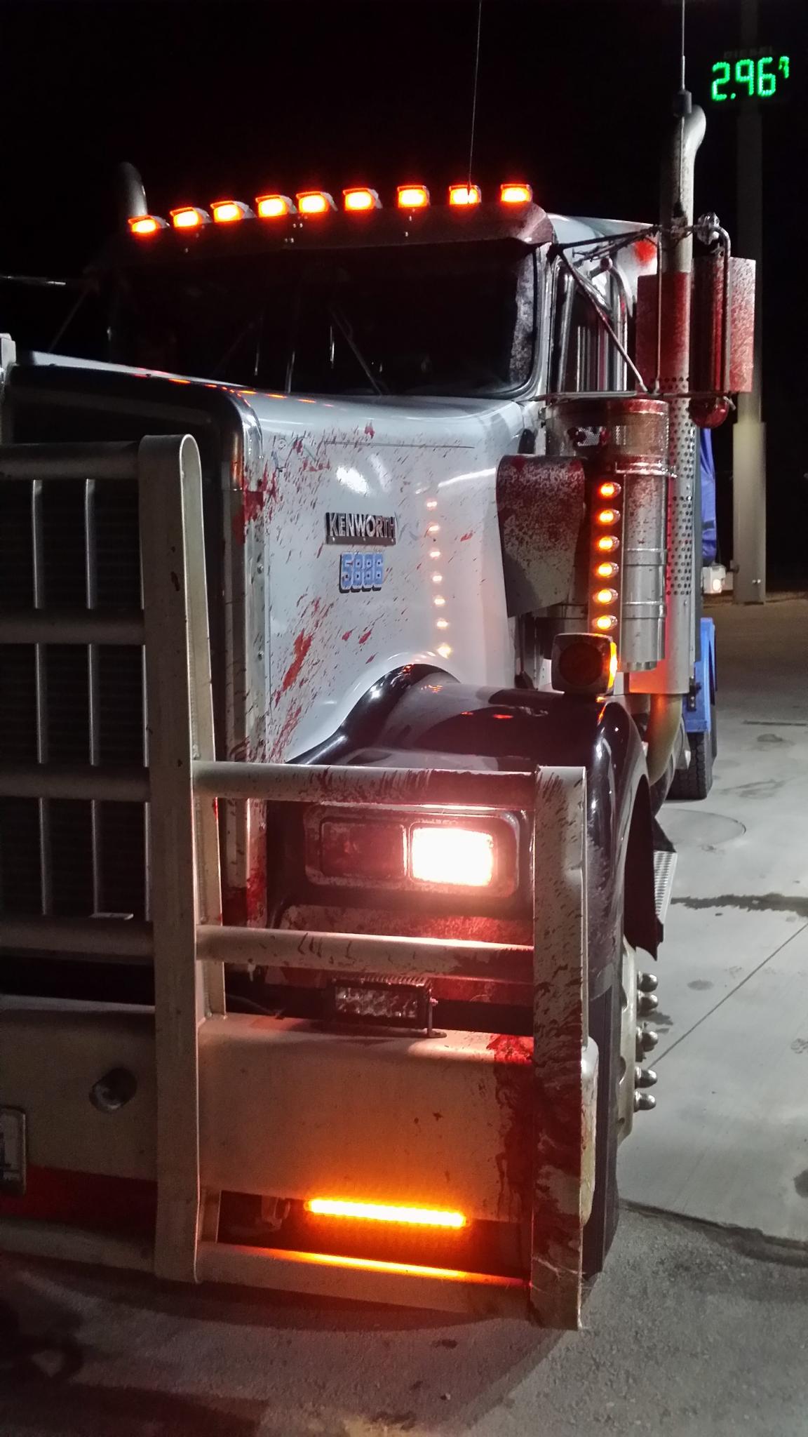

Well a good bumper will save your butt...this was in WY a 2 for one, had to turn on the wipers to see..

(05-15-2019 )stevesparts Wrote:  Well a good bumper will save your butt...this was in WY a 2 for one, had to turn on the wipers to see..
those deer guards are great too.. only my own truck is 12,300 lb on the steer axle bobtail with full tanks. no chance in he#ll to put something like that on it.
A fleet of more than 2,000 trucks said to me once that the average truck deer-strike ratio was one strike every 8 years (that caused major damage any ways) according to their data. I thought that was interesting.
