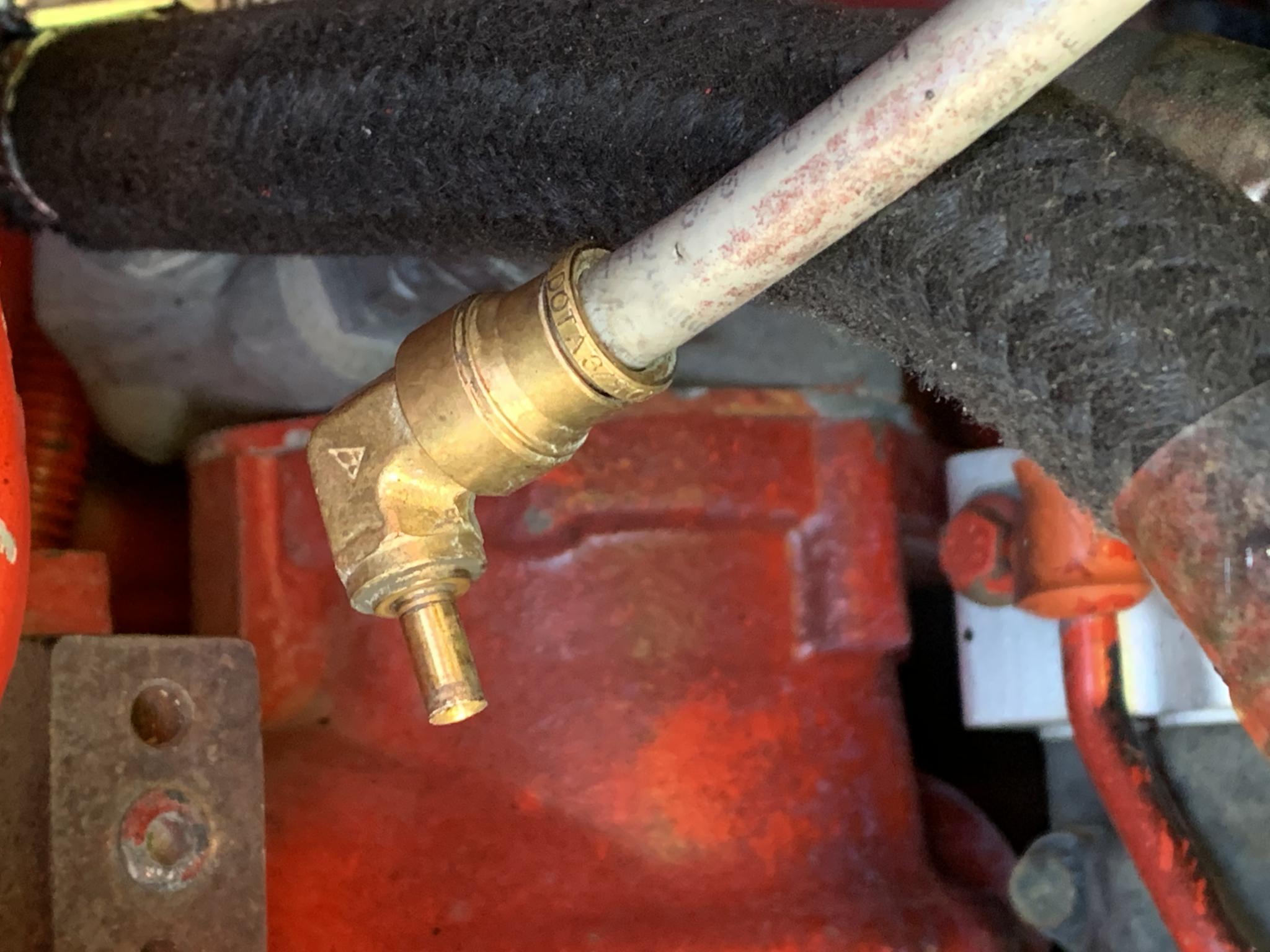

Thanks for the help, the last time I had checked this thread no one had replied, and I’m just now back in the board. I knew my compressor was constantly running and the safety valve was working. I thought it was the governor, but wasn’t sure. I have limited mechanical skills, so pulled off at the Petro in Laramie just in case. I immediately saw a loose air hose and a broken brass fitting, and repaired it myself. It was Sunday, and the Petro didn’t have the right piece, but the loves across the street did.

i think that might be the unloader air line for when everything reaches pressure.

yup, I agree. That's the unloader line to the head in the compressor...governor may be telling it to stop pumping but it isn't receiving the signal.
