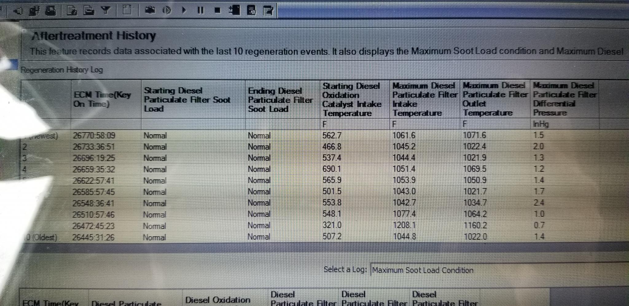

Are these good regen numbers?? If the picture doesn't post I'll add them in manually. Just curious.

Looks decent. The 2.0 and 2.4 were getting up there. Good time amount between regens as well...around 37 hours between regens is around 2400 miles presuming no idling...

(05-20-2019 )Nilao Wrote:  Looks decent. The 2.0 and 2.4 were getting up there. Good time amount between regens as well...around 37 hours between regens is around 2400 miles presuming no idling...
Funny thing is that I am idling a lot right now. About 75% running shuttles about 5miles each way and take about 1hr to load and 30mins to unload. Keep it idling because I have to use the PTO for the hydraulics.

You really don't want your DPF pressures above 1. When i see the history and they are above one i usually run a regen and look to see if the pressures are still high or going down.

(06-30-2019 )Galvaleo Wrote:  You really don't want your DPF pressures above 1. When i see the history and they are above one i usually run a regen and look to see if the pressures are still high or going down.
that is too extreme... I hope you didn't get that garbage idea off some gtawd-aweful social-media or idiot-driven truckers website like TTR....
A brand spanking new dpf will read 1.0...
3.0 inhg or less will not even effect fuel mileage much. Multiple readings of above 3.0 is the point of concern for a healthy system.

No i dont. I get that straight from cummins. That is straight from cummins. When i see 1> in history i will regen it and if it remains higher it needs to be sent out to get baked. To much build up.

(07-02-2019 )Galvaleo Wrote:  No i dont. I get that straight from cummins. That is straight from cummins. When i see 1> in history i will regen it and if it remains higher it needs to be sent out to get baked. To much build up.
I don't know who told you that but it's wrong. I have a brand new 2018 with 10,000 miles on it. The regen numbers look about exactly like his. Like Rawze said, a brand new DPF will read 1.0

Dont think i can upload photos to this forum. Or your messages. I have papers with all numbers for cummins and detroit straight from their hands on training classes.
