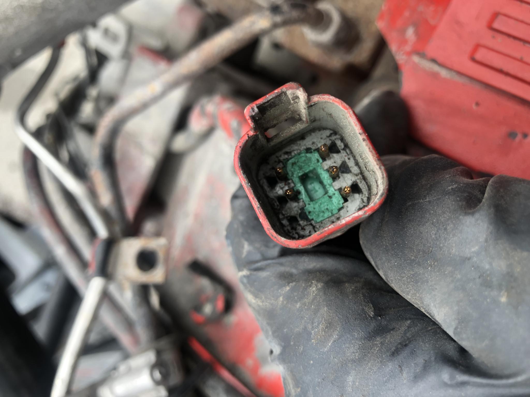

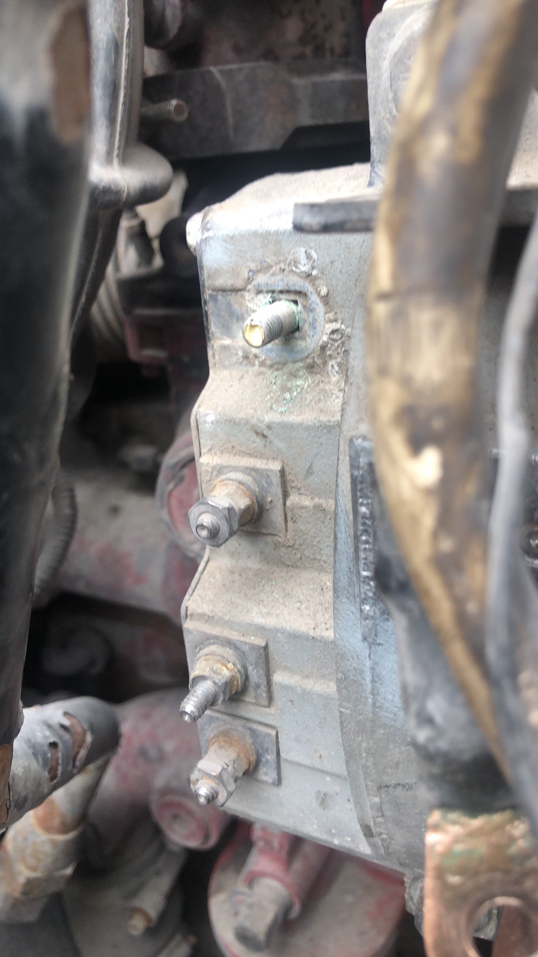

So today I was looking over the truck and started to do some preventative maintenance on the truck, trying to catch or find anything out of the ordinary. So I started of with cleaning the valve cover n then saw the cables on the starter had some nasty oxidation on it n cleaned them of and when I was putting the buy back in for the red cable I snapped the sob of by over torqueing it :/.
So what are my options for that? I wanna get back to work tomorrow but I wanna fix this properly today.

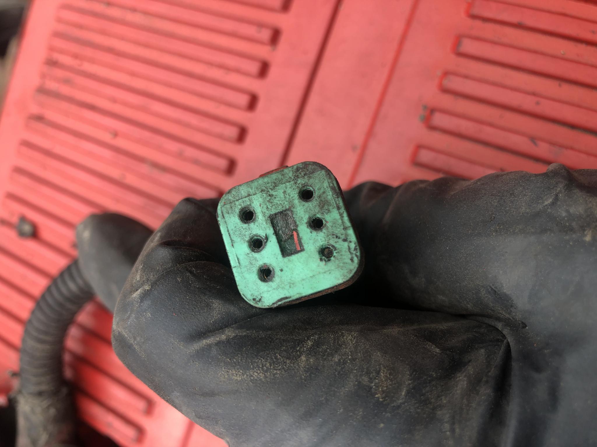

Also noticed those two cables was or is supposed to miss one those small middle things or prongs? Someone tell me what you call those things lol. If it’s missing it’s inside one of those connectors n I think that connector hooks up to the thermostat housing? So that could be where my issue is with the over heating or inaccurate signs.

These are the other photos

Prolly just a spot thats not used on those connectors. Manufacturers use the same plugs for multiple applictations and some of those applications use fewer wires. As far as the pole on the starter (the pic looks more like an alternator though) all i see is the insulator and nut missing.

(05-27-2019 )smorgan87 Wrote:  Prolly just a spot thats not used on those connectors. Manufacturers use the same plugs for multiple applictations and some of those applications use fewer wires. As far as the pole on the starter (the pic looks more like an alternator though) all i see is the insulator and nut missing.
Yeah that pole on the alternator partially snapped n now it’s not as long as it was before.
05-27-2019, (Subject: Doing some preventative maintenance on my cm870 )
RE: Doing some preventative maintenance on my cm870
Short of replacing the alternator i think your SOL...those bolts have the stator wiring soldered directly to them. You can't just replace them unfortunately.
(05-27-2019 )Nilao Wrote:  Short of replacing the alternator i think your SOL...those bolts have the stator wiring soldered directly to them. You can't just replace them unfortunately.
Lol I made it work, some how. Thankfully I found a smaller n thinner nut to screw on to it n it’s just doing fine. Gave it a good wiggle n jiggle n it’s very nice.
Alternator shop can put a new pole on prty cheap if ur fix has a problem. Or if ur confident in ur abilities take it apart and solder a brass stud on there.
(05-27-2019 )smorgan87 Wrote:  Alternator shop can put a new pole on prty cheap if ur fix has a problem. Or if ur confident in ur abilities take it apart and solder a brass stud on there.
just as a reference, taking an alternator apart typically requires special tool so that the brushes and top of commutator/rotor don't get destroyed.
