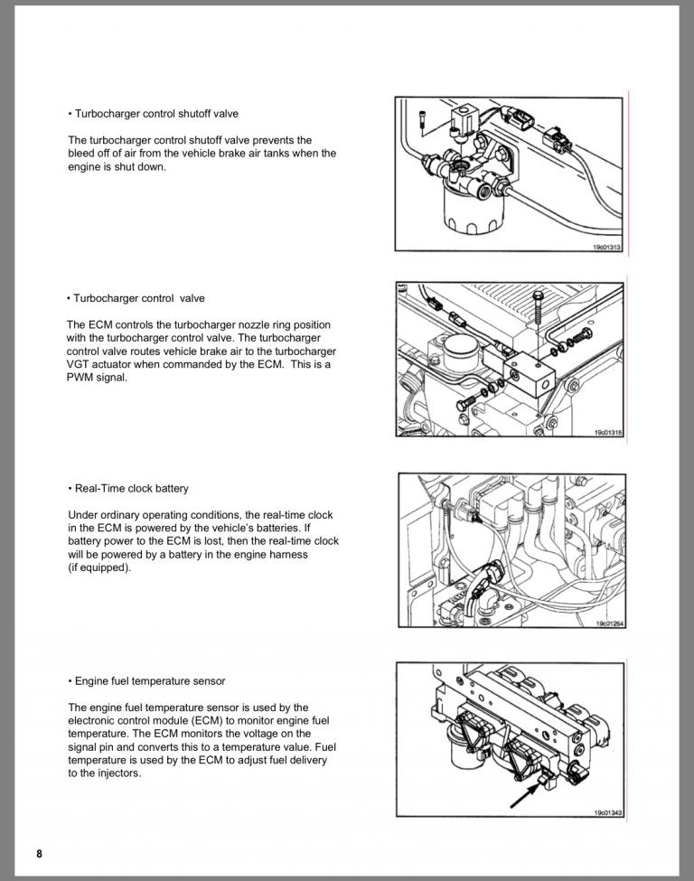

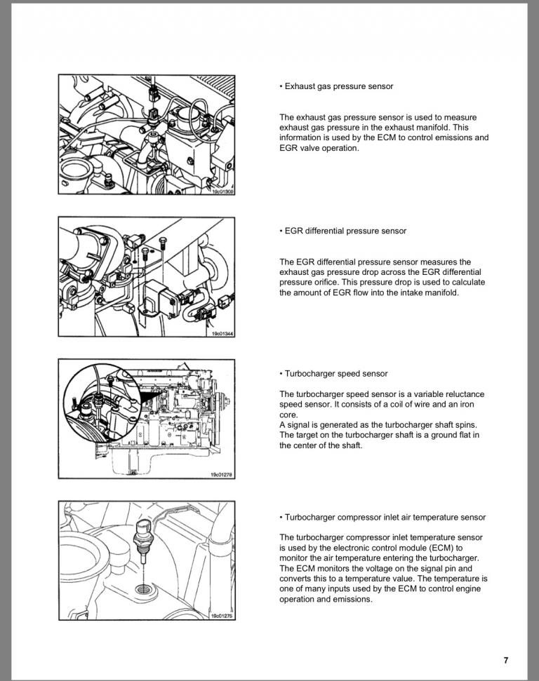

Found a Cummins manual, that appears to be a short manual with general descriptions and diagrams with sensor locations. Pretty short manual only a few pages, but it's something you could print and keep in your truck for future EGR tune ups and soot cleaning.
./uploads/201605/post_602_1464284321_72628ac53275cc1b680b23054bfe384e.jpeg

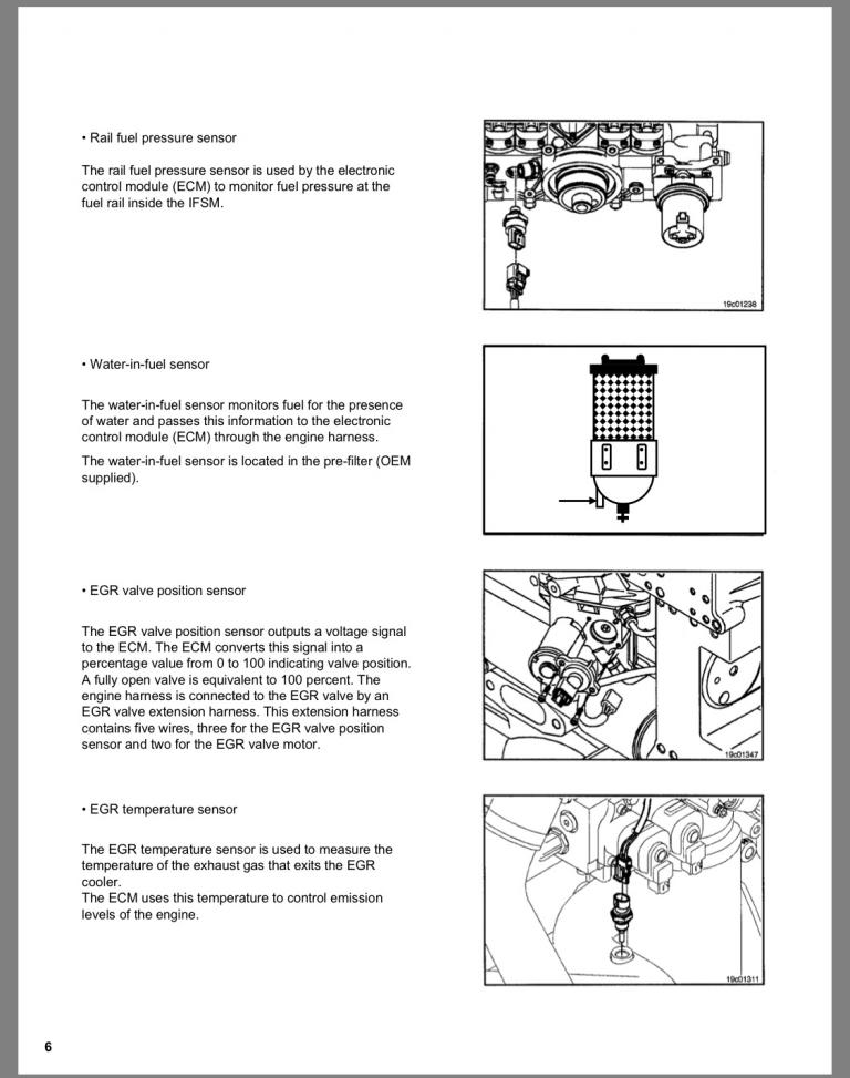

./uploads/201605/post_602_1464284430_289cd163d78e61902a2273b959fd5f62.jpeg

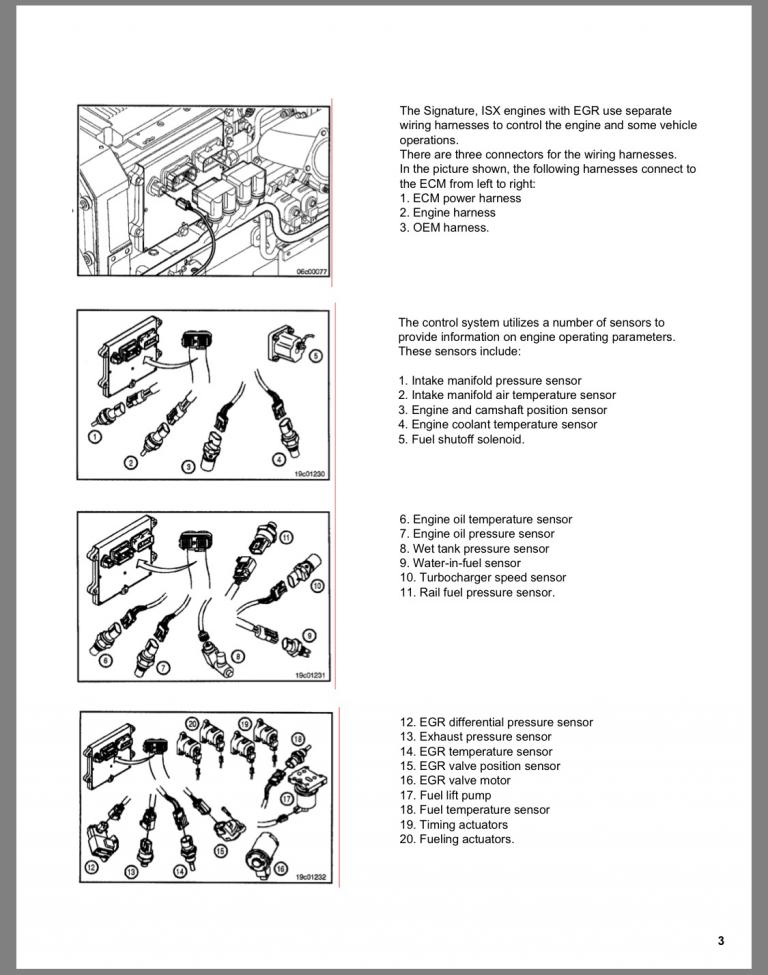

./uploads/201605/post_602_1464284533_544889369e02a1594fa8f585a22bacf7.jpeg

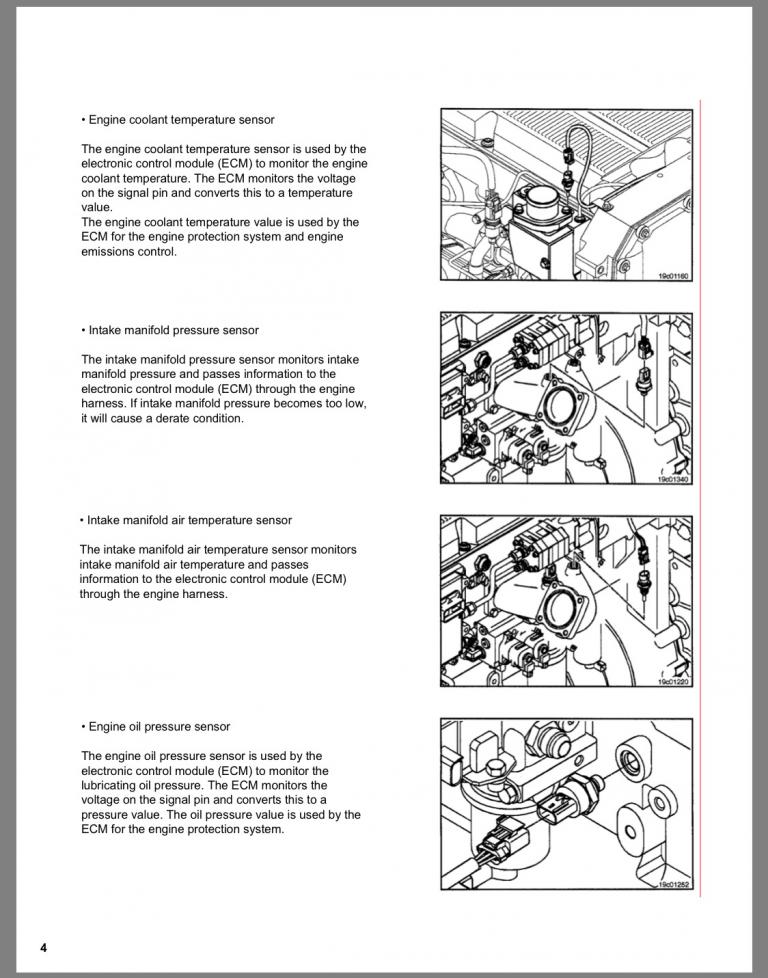

./uploads/201605/post_602_1464284638_d010ed1710e9a6c5377e6d90d8e7da1a.jpeg

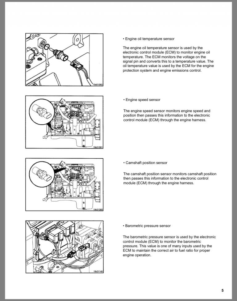

./uploads/201605/post_602_1464284715_9757c5bbe6459031a1778ca7075be454.jpeg

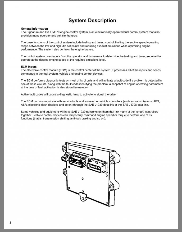

./uploads/201605/post_602_1464284914_30d6b3e9aa61141d1093313a6bde0eca.jpeg
