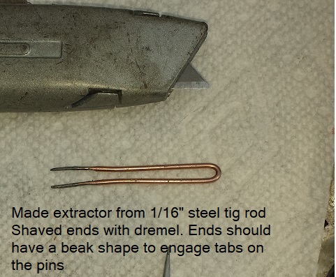

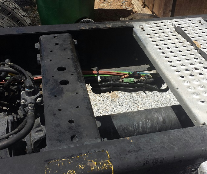

Exposed to the elements, the ramp tabs were missing and halves held together with zip ties. Connector wasn't sealing between the halves and I was getting CEL ABS and traction control error lights on dash with "abs module" error message. Only related error code was for second axle right hand side sensor error.

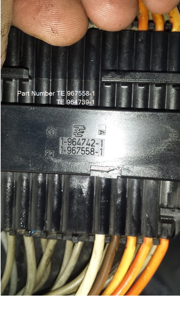

All the parts are available from secondary sources; plug, receptacle, pins, seals.
International #'s 3558022c1 and 3558026c1 or TE AMP 967558-1 and 964739-1

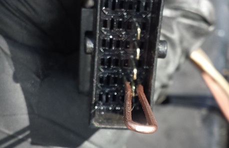

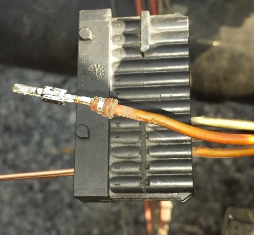

Bought the two halves and reused everything else. Transferred wires from old to new one at a time.
There are also silicone blanking plugs not shown on 7 unused holes. Pushed them out with a piece of zip tie. Be careful they like to pop out like a champagne cork.

Interesting solution making a terminal extraction tools with tig rod. I did the same thing a few years ago except I used the metal strip found in a windshield wiper blade. Works really well for AMP and Tyco connectors.
 Thanks given by: rrod
07-13-2019, (Subject: CEL ABS error Composite Connector 9800; left frame rail behind cab )
RE: CEL ABS error Composite Connector 9800; left frame rail behind cab
Why you guys try to invent the wheel if every plug manufacturer has removal tools for pennies.
https://amzn.to/2lcNotL
 Thanks given by: Waterloo , rrod , Sergiu
