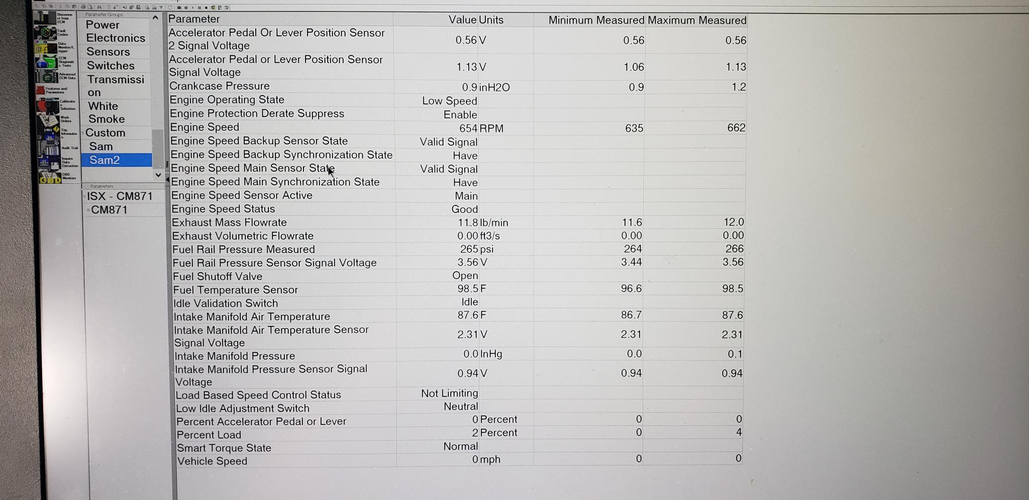

| RE: Rpm bounces while moving The rpm drops 2 or 3 times within 2 seconds. I can adjust the log rate to 20 milliseconds, I usually run 1 seconds. I can try 20 milliseconds. However I noticed idle rocks my truck 2 or 3 times then steady and do it again. I've attached shot of the data. That's idle no touching anything. That's how much the voltage bounces from minimum to maximum numbers. I guess it's supposed to be steady at idle? | |||
| 07-16-2019, (Subject: Rpm bounces while moving ) Post: #9 | |||
| RE: Rpm bounces while moving That screenshot isn't showing to much. It caught your RPM's dropping to 635 which may be a slight drop but that is within normal fluctuations. But it also could be explained by the .07 volt drop on the Accelerator Signal voltage. There is nothing definitive that I see. Try the 20 milsec graphical recording on the Accelerator signal voltage and your RPM at the same time. See if it'll catch your event and maybe the 2 will drop at the same time. | |||
