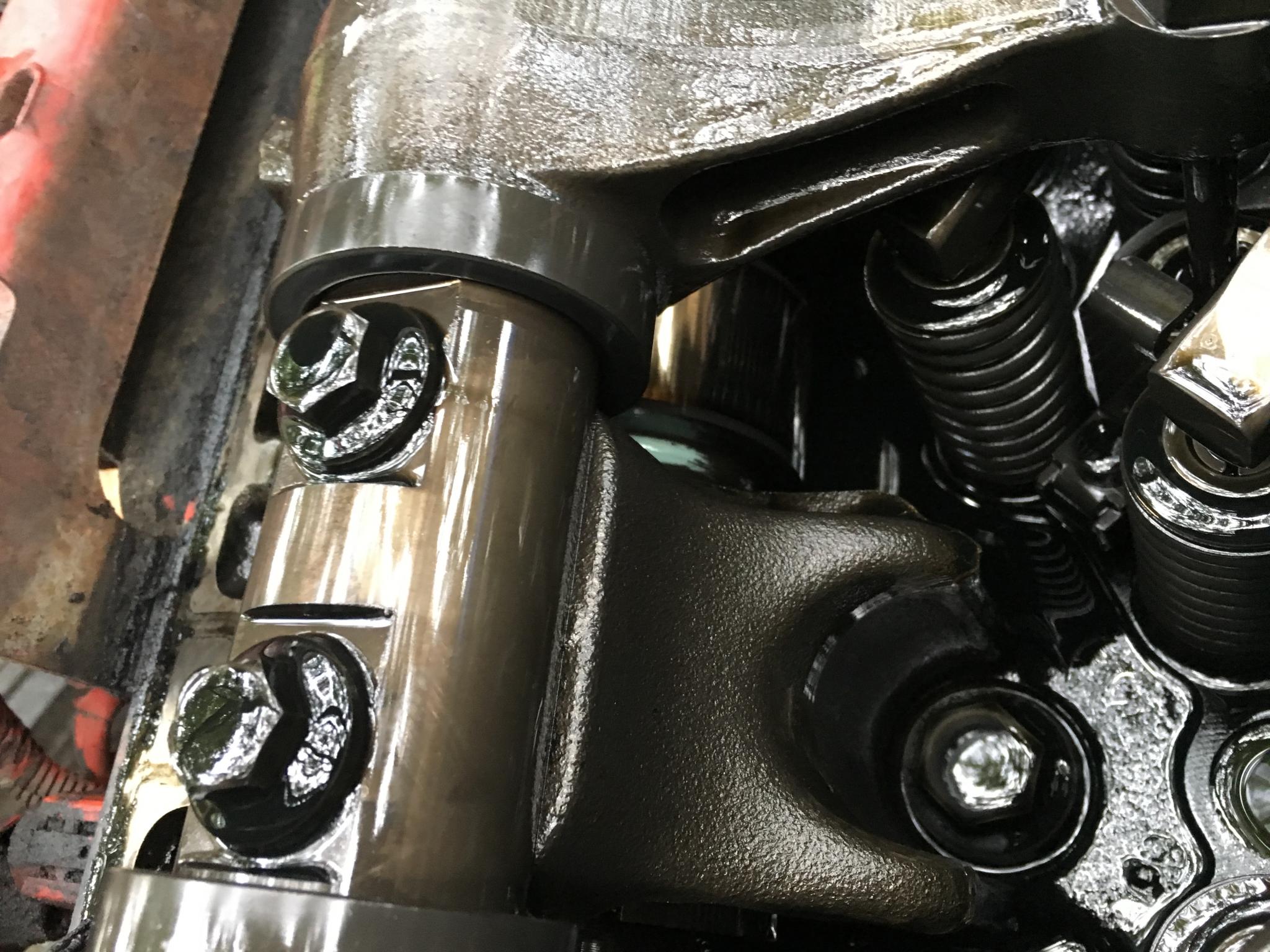

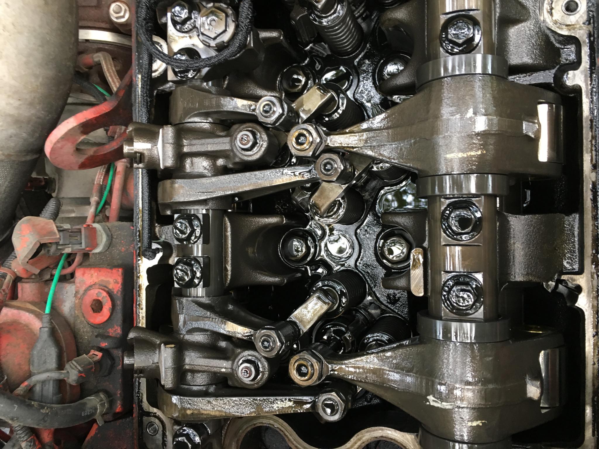

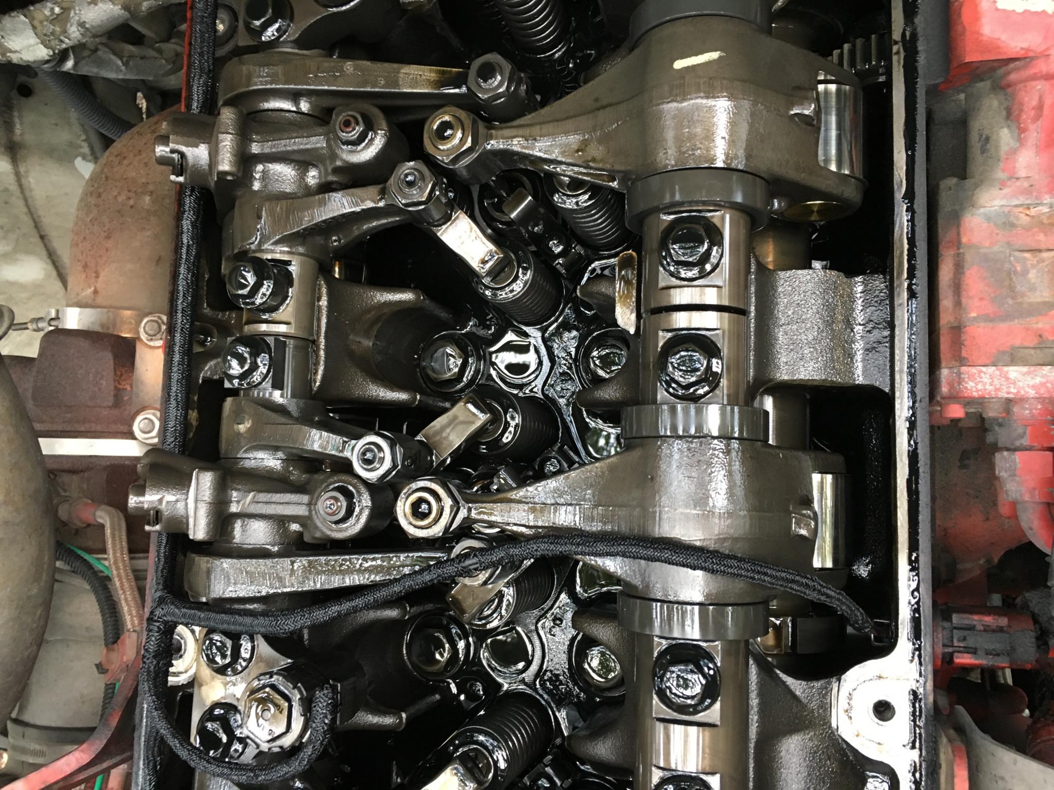

   I cleaned the motor up good and the majority of the oil appears to be coming from around the crank seal area, there’s also some minor seepage from around the injector & valve cam seals. I ran the overhead today to get a look inside, as this is the first time it’s been open in about 260k. Every looked pretty good to my eye, but I’m not professional. I’m gonna try to upload some pics and see what you guys think or may see something concerning that I missed.
