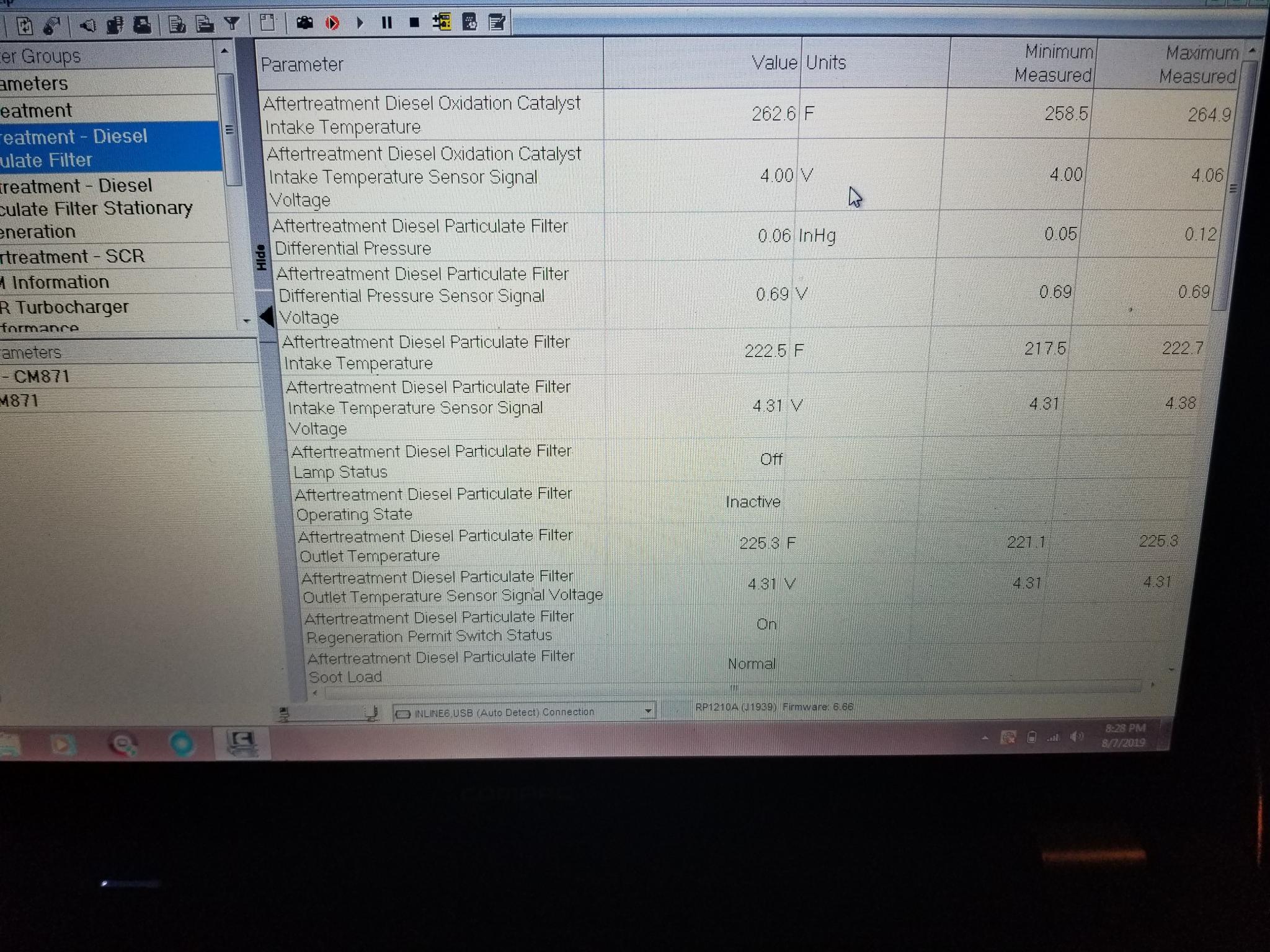

08-07-2019, (Subject: Rejen snapshot )
Rejen snapshot
How do these #s look
08-08-2019, (Subject: Rejen snapshot )
RE: Rejen snapshot
those temps are all too low for a regen cycle. It must not have been doing one at that time.
RE: Rejen snapshot
No...I was doing cutout test....
I couldn't get the truck to stall running on 1 cylinder....still think I have a bad injector....engine has slight misfire at idle...enough to rock the cab very slightly....bubble test this weekend along with overhead and egr tuneup....gotta have a bad injector...even with using "Georgia overdrive" pulling 25k downhill cant get more than 5.9mpg ...
