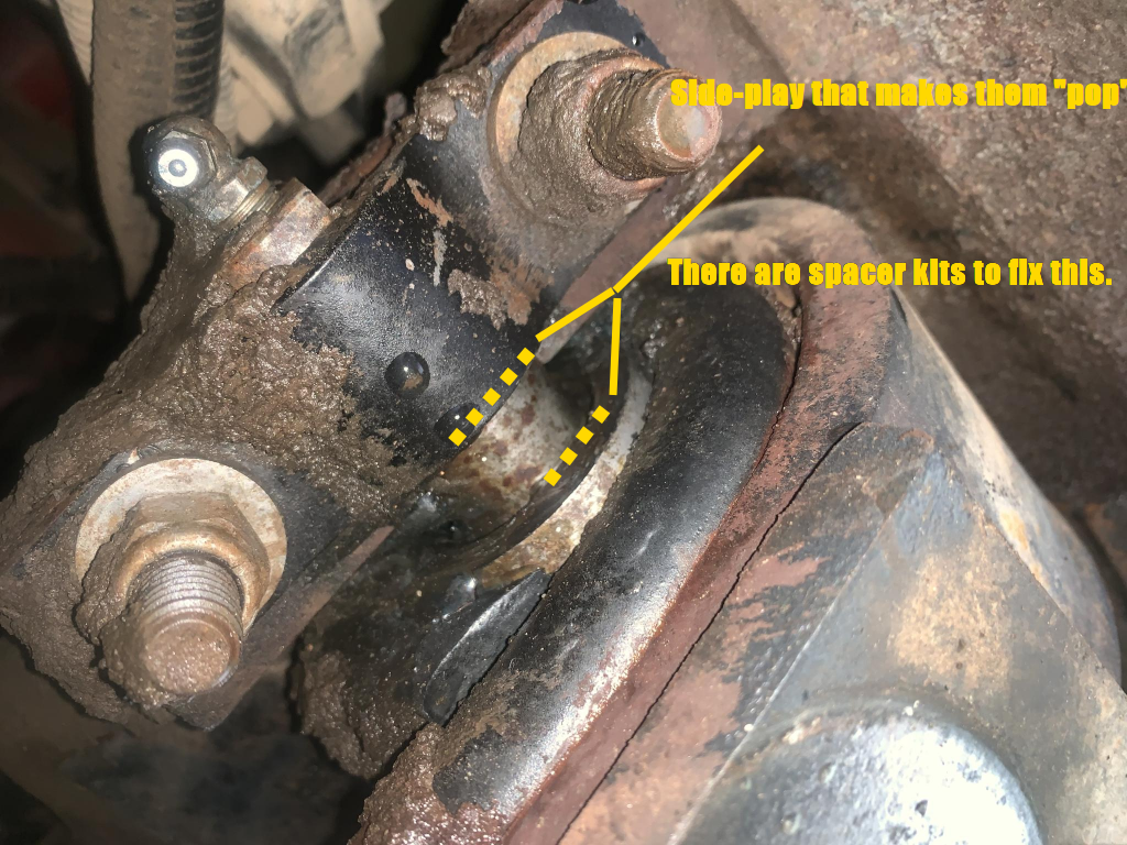

RE: Pete/KW front suspension
./uploads/201908/post_2_1565837155_8b6aec0318464fbd5db731815fb95656.png
 Thanks given by: DSTdriver

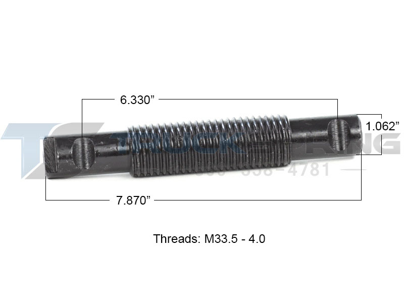

I think the pins are threaded though, internally.
./uploads/201908/post_4399_1565863523_44138ef93c1e2400ccb7484b46d46537.jpeg
08-15-2019, (Subject: Pete/KW front suspension )
(08-15-2019 )Andre_The_Giant Wrote:  I think the pins are threaded though, internally.
The spacer kit(s) also helps prevent the inner leaf from slipping against the outer leaf?, not 100% sure. - I know I have seen a lot of guys have to install those spacers because of the popping front end problems. It is almost always the front, not the back that causes it.
if the center pin is threaded like in the pic you provided, and its slipping, then it likely needs replacing too, but I doubt it will be successful without spacers, as the hole it threads into may likely be stripped as well. just some thoughts.
I am not trying to say that spacers solve every problem... I just know that I have seen them quite a few times because of front ends having this issue, and it solving them vs more expensive options.
 Thanks given by: Andre_The_Giant
Check your actual mount bolts. If the spring pin is tight and the locking cross bolts are tight and good the actual spring hanger mount maybe moving.
Jack the front end up off the ground an inch or so and get a big.... scratch that.... a huge pry bar and start moving things around.
