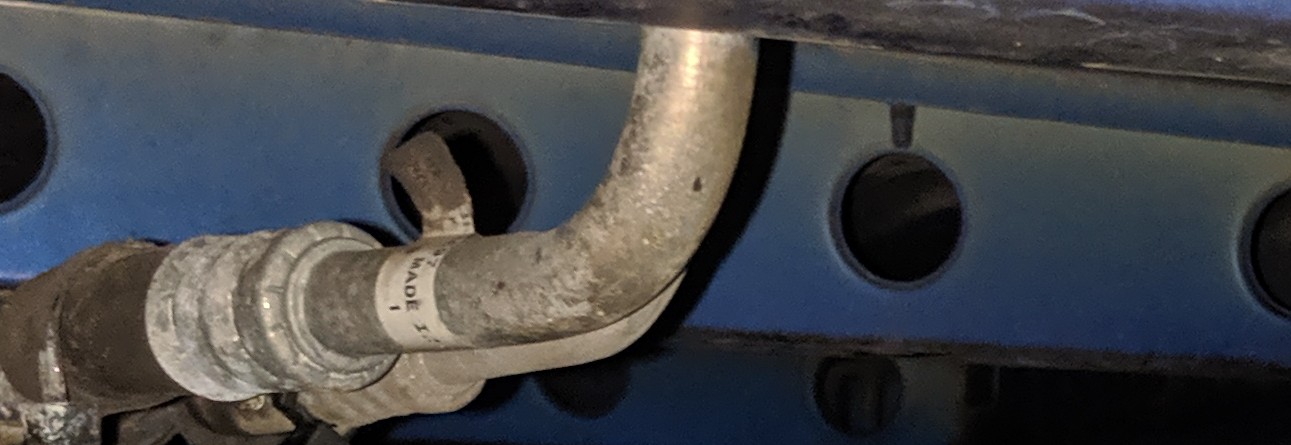

I'm having similar issue. My air was blowing cold then it stopped blowing as cold. So I got out and noticed a pipe under the sleeper part of my truck that was frozen. I let the ice melt off of the pipe then the air started blowing cold again. I took pic of the pipe. Any ideas?

Probably have moisture in the system, likely caused by a leak.
08-26-2019, (Subject: AC issue on my ISX )
RE: AC issue on my ISX
Moisture in the system. Insufficient flow through evaporator.

(08-26-2019 )david24 Wrote:  I'm having similar issue. My air was blowing cold then it stopped blowing as cold. So I got out and noticed a pipe under the sleeper part of my truck that was frozen. I let the ice melt off of the pipe then the air started blowing cold again. I took pic of the pipe. Any ideas?
Low on refrigerant.
