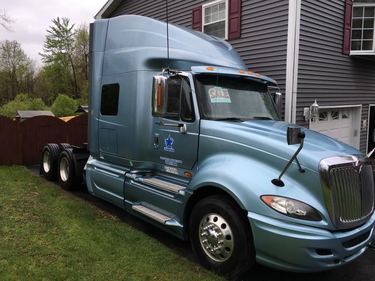

I just purchased a 09 Prostar premium it was a Werner truck 435st cummins CPL 2732 13 speed trany Verry clean runs good I bought it from the 2nd owner who bought it for his brother in law to run the road and he leased it on with Landstar his brother only ran 30k in 6 months and gave him back the keys the truck sat for over 8 months while trying to sell for 55k he bought the truck from Jorden Truck Sales and Jorden put a new EGR valve and a EGR cooler on it the the new owner put 8 new Yokohamas on the rears new a/c compressor,receiver drier and expansion valve..truck has a Thermo king APU that works power invert-er,and diesel heater under the bunk that also works.....
1, The a/c in the bunk is ice cold the dash is only cool I did find the unit that opens and closes the blend door to be erratic and ordered a new one but don't think that is the problem even if i manually close the blend door it still isn't great i happen to notice there isn't any shutoffs for the heater core thinking they were removed when the APU was installed? only a thought
2, there is 555k on the truck should i do the rods and mains or do an oil sample and see what it says ?
3, should i run the overhead?
4, should i clean the DPF and the intake also change the doser valve..what is the cost to do this? I drove the truck from upper state NY to Boston with no lights or problems I am just looking to possibly avoid any problems on the road....Thanks in advance ./uploads/201606/post_2085_1465320108_42b74a469ab3720776fb32f5820775cb.jpg

First, get a inline 5 adapter off eBay. It will save you tons of downtime. Second do a get tuneup. As far as the a/c all I can think is have it evac/recharged. Loves charged 109 on mine. It was overcharged from the dealer when they replaced it. I'd leave the doc cleaning till you get insite so you can see the regen history. I would seriously consider having one of our reputable members remove that mandate. As for the rods and mains I'd leave them alone as you stated it had a new engine in it already.

If it were mine the first thing i'd do would be check the history on insite. if the number was ok id do the egr tune up as explained by Rawze. He has many youtube videos that will show you what to do. If #'s are high then Id be looking at the mandate fix........ If you are in Georgia we would be glad to look at that for you and IM sure gearhead or unilevers would do the same.

awesome looking beast, I would recommend that you run the overhead, it is an inexpensive repair and you can have your camshafts checked out for wear, replace the EGT and IMAP sensors unless they look new and clean out your EGR valve, have your Vin run at your local Navistar dealer to make sure that you have the correct alternator, a lot of the electrical issues on that model truck are due to insufficient amperage.
