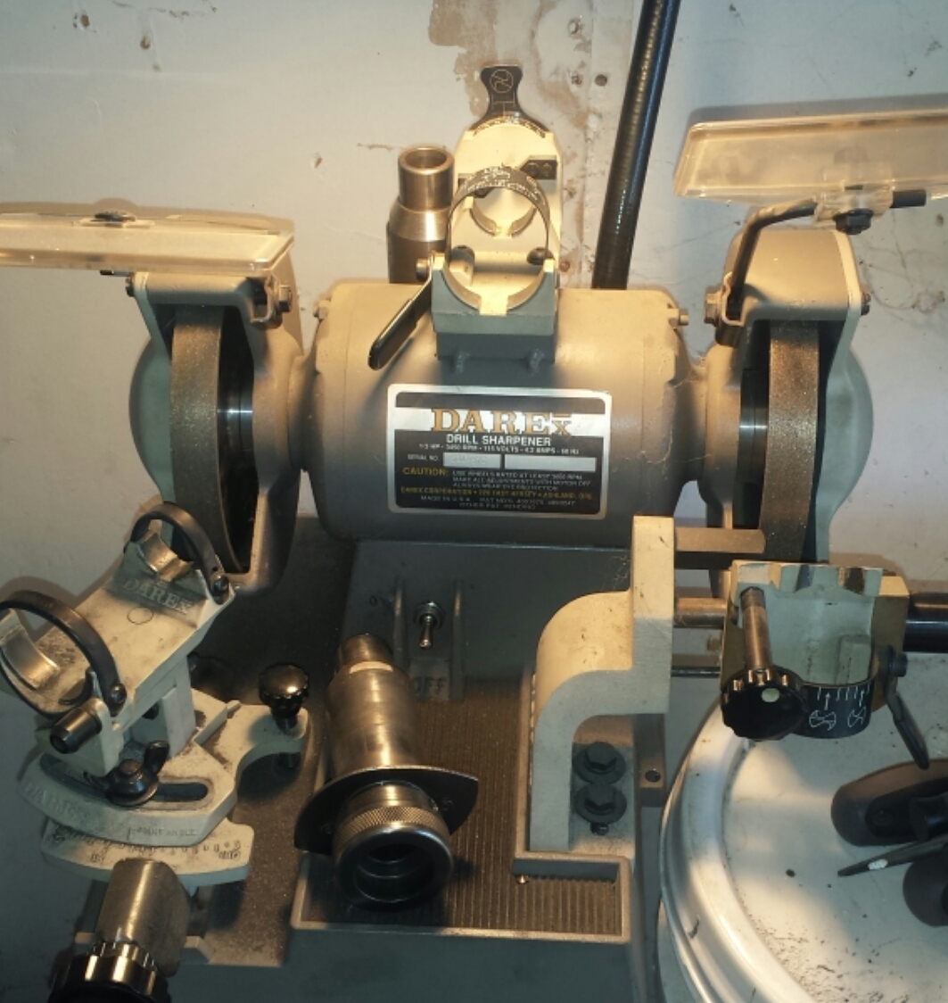

Did the back and forth. Threads were crumbling and making it worse as I went. No way to get a shot of pb blaster behind the assembly.
This is the only thing going for me now.
./uploads/201909/post_3119_1568413912_813842a9f2ec370ce7bb0dd99ccb1777.jpg
