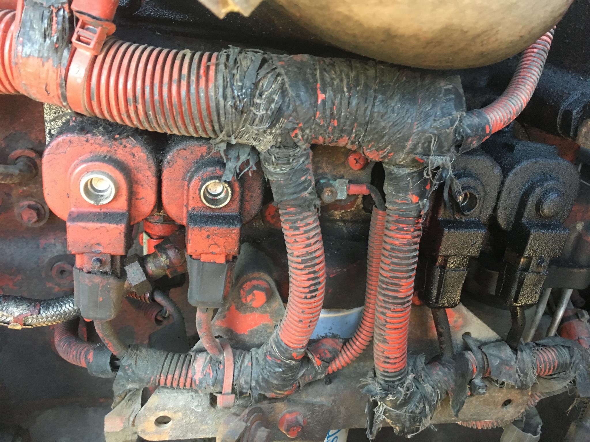

I can take a picture if needed, but my fuel metering actuators are all missing the waxy button covers. Someone said "tuners" used to remove these covers to tweak them somehow.
Myth or real?

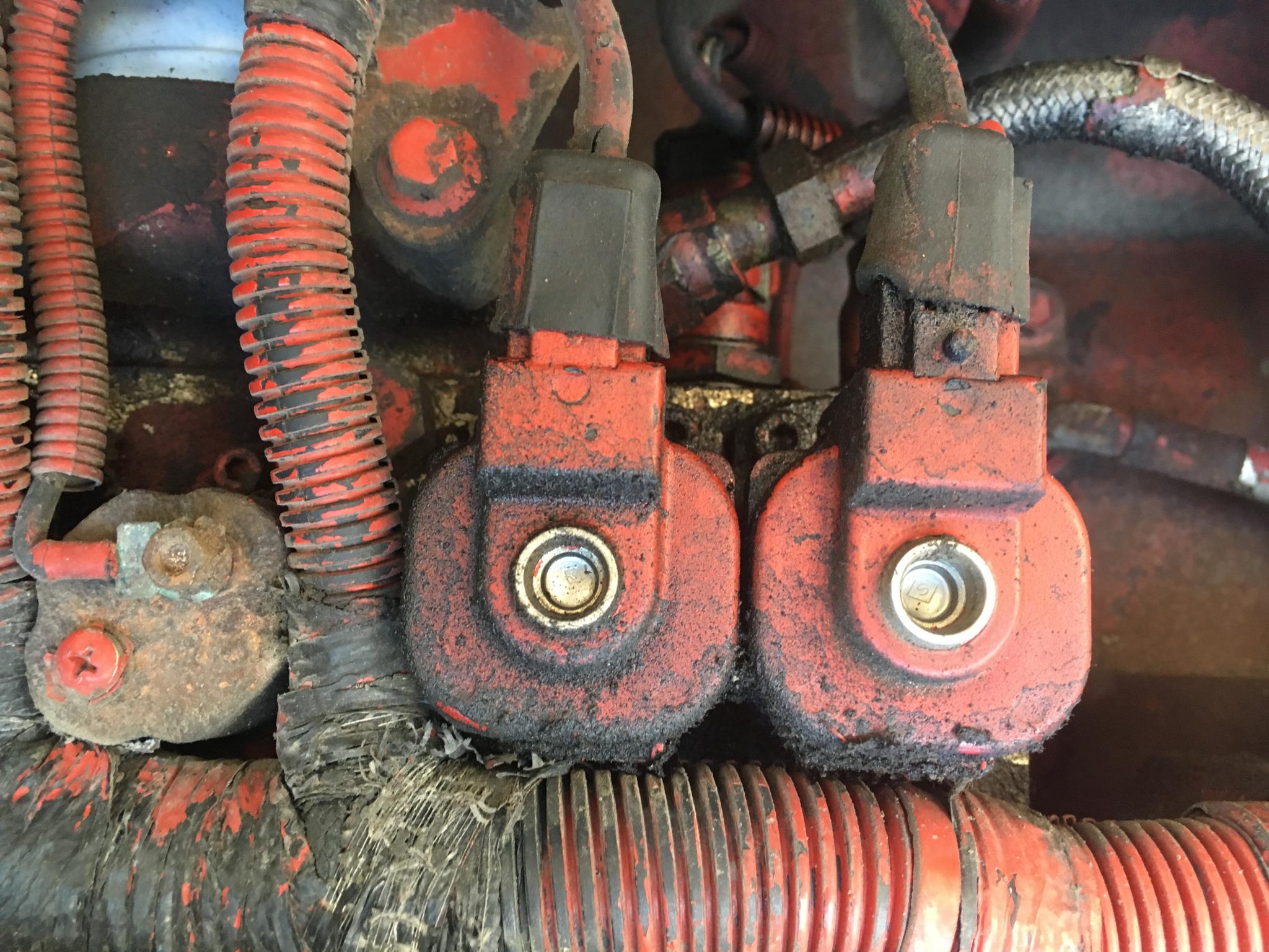

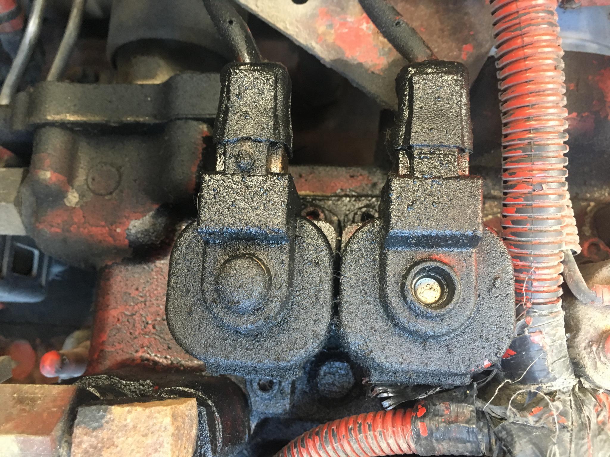

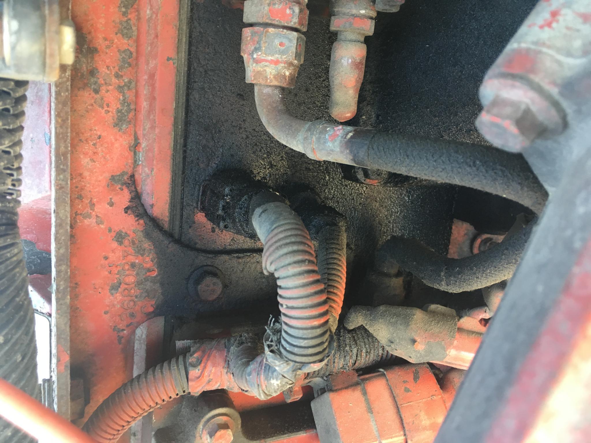

Those things look like hell. One of them is busted up pretty bad. Your gonna want to get that oil or fuel leak cleaned up. It puking all over the wiring and plugs. Your harness will do what's called "wicking" the oil or fuel in to the connection right straight in to the actuator or worse yet back to the ECM. It's where the oil gets into or under the insulation on the wires or plug and runs like a lantern wick in to electrical components.
 Thanks given by: DDlighttruck , Pd6cas2
09-17-2019, (Subject: Fuel actuators missing waxy cover )
RE: Fuel actuators missing waxy cover
I almost think it’s coming out of the jake brake plug. I need to wash it off again and try to locate the leak
Which one is busted up?
You’d replace all four or just the three missing the covers?
It looks much cleaner where the wax was compared to the rest of the actuators. I would say the wax has broken free and fallen out. Don't worry about it.
