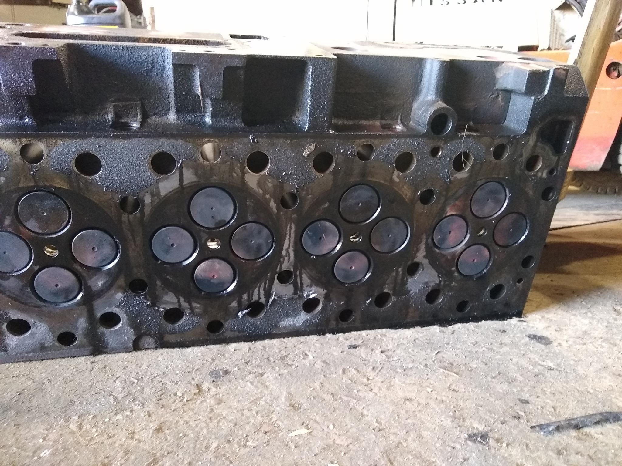

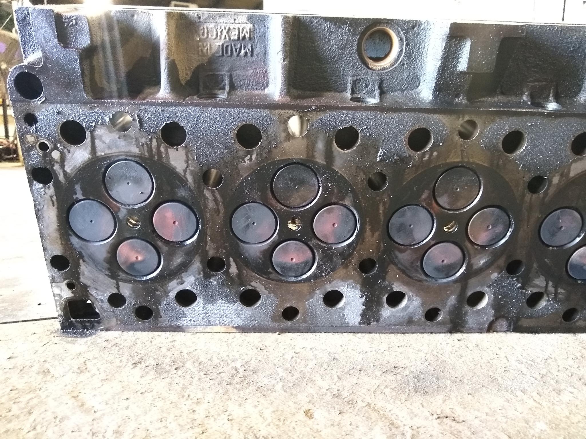

Both me and mechanic were curious as he hasn't seen this in any other head he's pulled. Why are the valves red?
10-17-2019, (Subject: Last straw )
Post: #128
RE: Last straw
Were you running any additives in your fuel? Not very pretty combustion
travel
Post: #129
RE: Last straw
No additives just a few bio treatments and a bit of antigel in winter
10-18-2019, (Subject: Last straw )
Post: #130
RE: Last straw
looks a little on the clean side, but not bad, not excessive. Perhaps a bit of turbo over-boosting on occasion in its past?. - The reddish-brown tint is from NOx gas (a reddish-brown gas) staining, as you no longer have EGR on the engine and its burning the fuel nice and clean.
Here is the difference between good and bad combustion. yours is a bit clean, but clearly nowhere near as bad as these engines...
ref: http://rawze.com/forums/showthread.php?t...7#pid32957
Take pics of the tops of the pistons. They tell the real story.
 Thanks given by: Old Driver

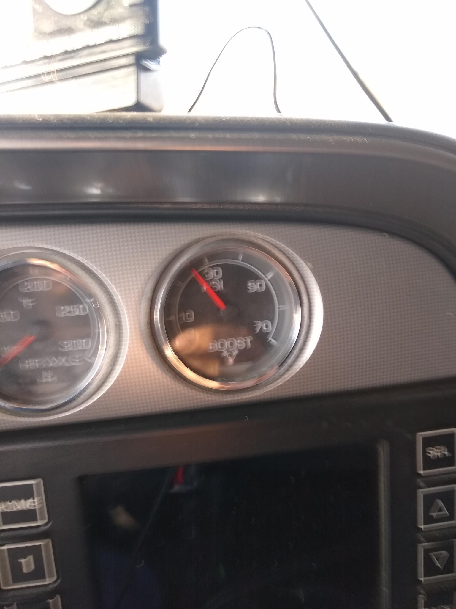

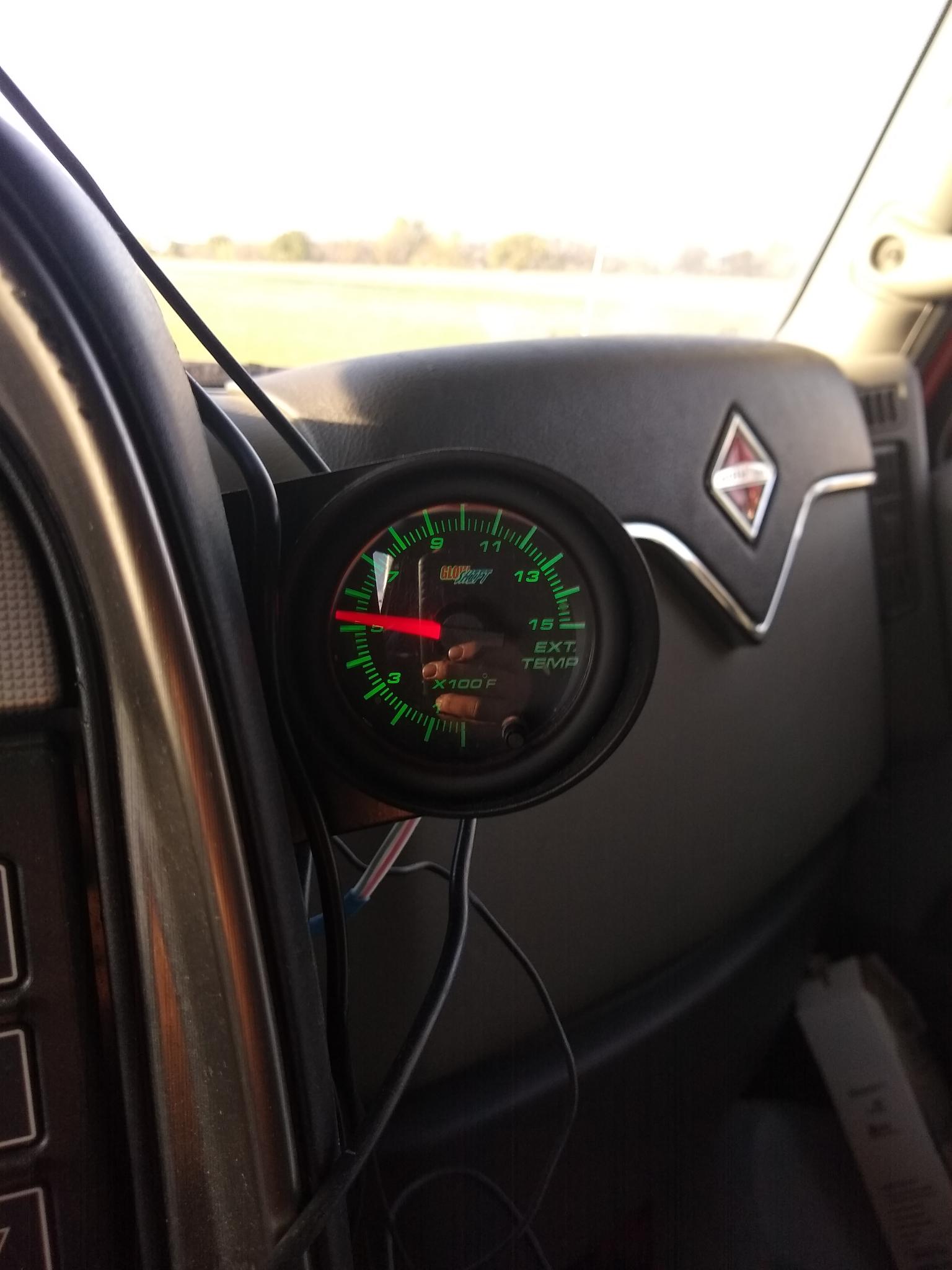

20 mile per hour headwind 58 miles an hour speed almost 30 lb of boostaccording to the gauge about 600 degrees in the exhaust 45000 lb of tarped Portland cement this day sucks
