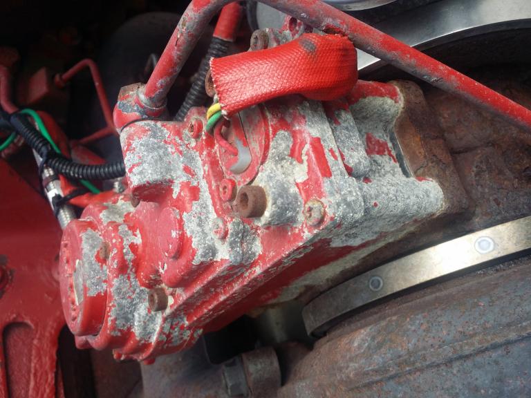

./uploads/201602/post_824_1456427319_19cc4f11e04efd6bb85c9d75e2121607.jpg./uploads/201602/post_824_1456427319_19cc4f11e04efd6bb85c9d75e2121607.jpg
These are gonna be a pain in the ass

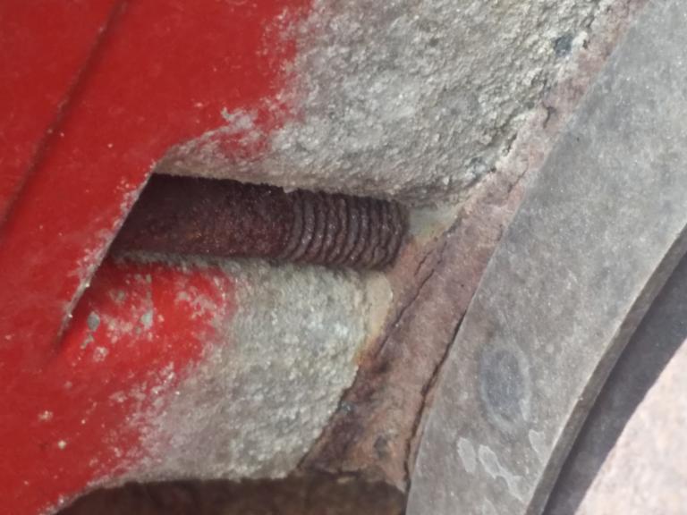

./uploads/201602/post_824_1456427397_8644124660f10f6541c7aa991f1959a9.jpg
