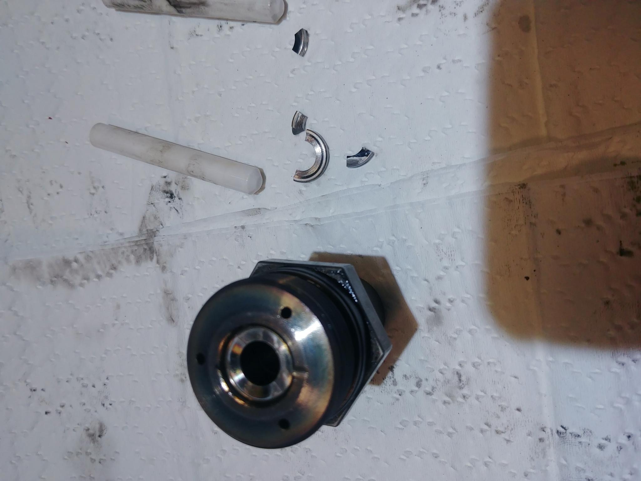

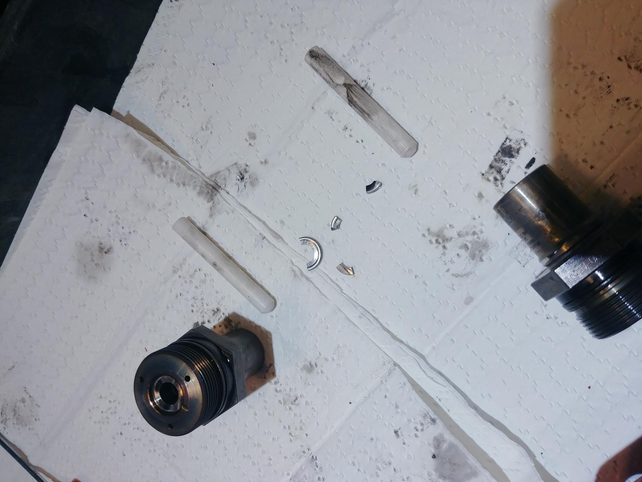

Top of fuel pump came off today. Told my mechanic to call me so I could see what's happening.

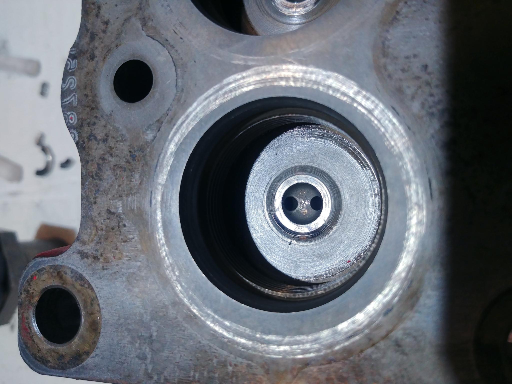

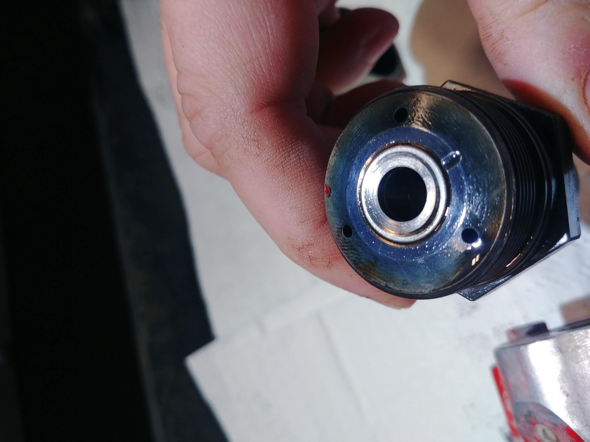

First thing....still has ceramic rods even tho I was told it was updated. Thankfully, they were in excellent shape. No cracks or chips. He did find what is likely the problem tho. A steel washer on the bottom of the push rod assembly was cracked and it looks like it was pushing pressure past it. Small scoring in the cylinder head where the assembly screws into. Rollers look great...no scoring. Pistons have very small scoring but just surface.
Pics included...also a picture of inside cylinder head...if you look close you can see the small score in the steel. He's talking with Cummins right now to see if it's usable once the cracked mating washer is replaced....or if the whole head needs replacing.

looks like the head is going to leak no matter what u do. I would replace it. along with all the other guts.
you were very lucky when that washer/seal failed, it did not take the ceramic plunger, and the entire engine with it.

(10-08-2019 )Rawze Wrote:  looks like the head is going to leak no matter what u do. I would replace it. along with all the other guts.
I've got a new head and guts coming tomorrow. I agree that I was lucky. I'm also not happy that it still has ceramic plungers when it had supposedly been updated. This pump does have a screen filter in it...maybe that's what they meant by update. I dont know....but I hope once it's put back together....it solves my fuelling issues
