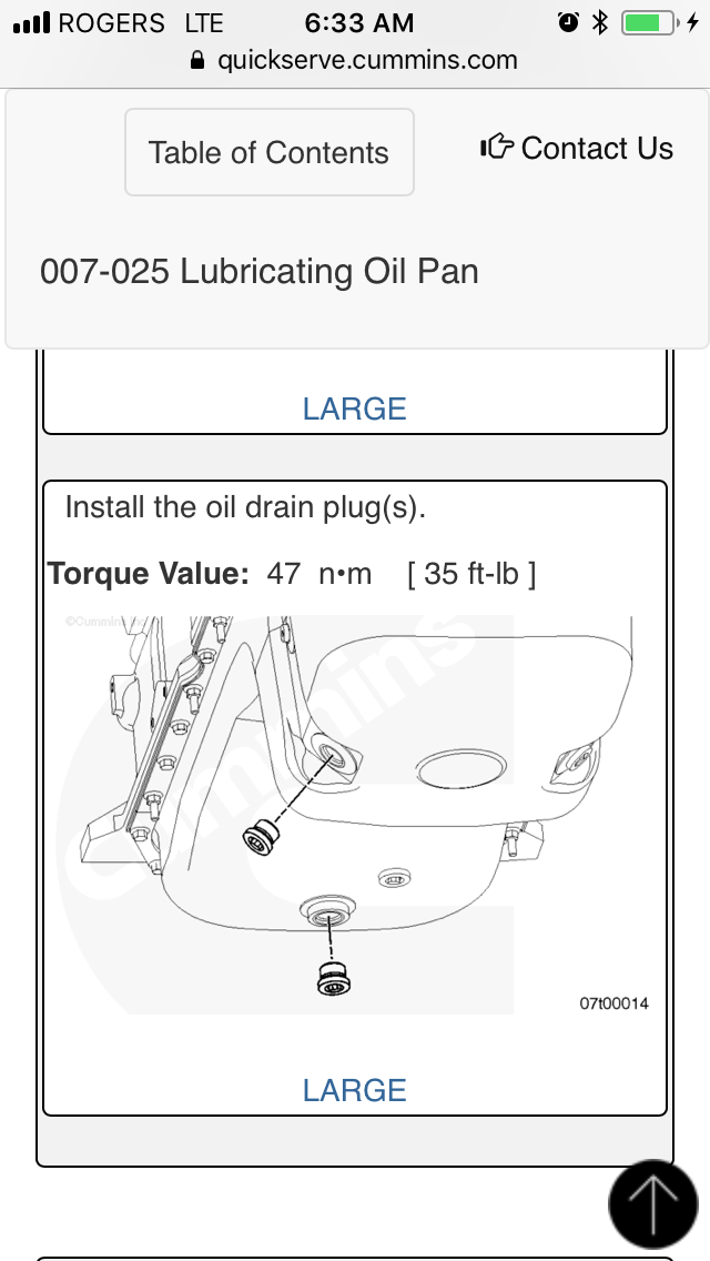

Are you guys with the cm870's draining the second oil plug at the back of the engine? There's about a gallon of oil that sits in the upper pan area.

(11-04-2019 )Chamberpains Wrote:  Are you guys with the cm870's draining the second oil plug at the back of the engine? There's about a gallon of oil that sits in the upper pan area.
Second oil plug....?
That’s gonna be a no for me...

./uploads/201911/post_2980_1572867255_97116adbda45c4e17c22839cfdc24d0a.png
That’s all I could find on quickserve?

Mine doesn't have the second plug.
